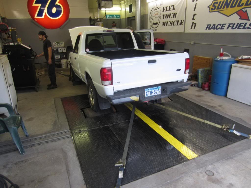

Dyno today! I will report back later today with video, graphs, etc. Super pumped to finally get my baseline dyno.
Baseline dyno
Big thanks to Beach's Long Lake Service in New Brighton. Great guys to work with. Testing went great. I logged data the entire time so I'll process that data later and post up the results.

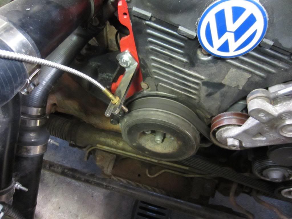

Optical tach bracket

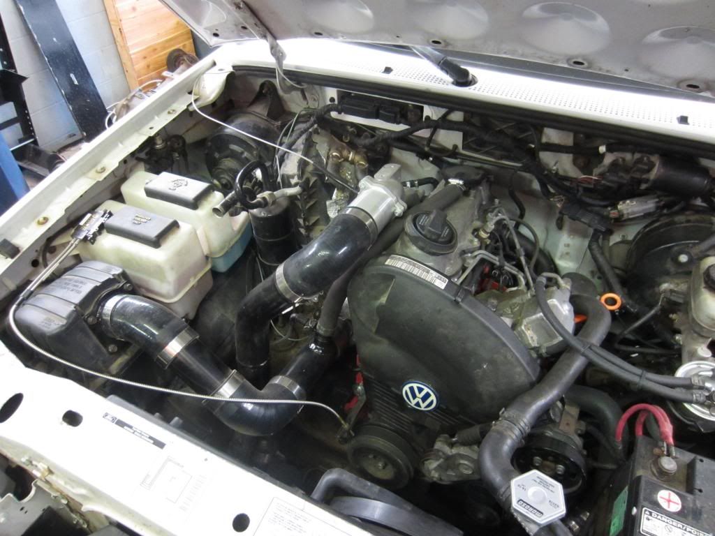

Hardware summary:
- stock ALH longblock
- 10mm IP
- .184 nozzles (stock 5spd)
- In-tank lift pump (regulator set at 3psi)
- vnt15
- 2" exhaust, stock ranger muffler
- 2.5" FMIC, 2.5" piping
- 2.5" race pipe, PD150 intake manifold
- Stock Ranger intake, WIX filter
- 3.73 rear axle, 35psi rear tires

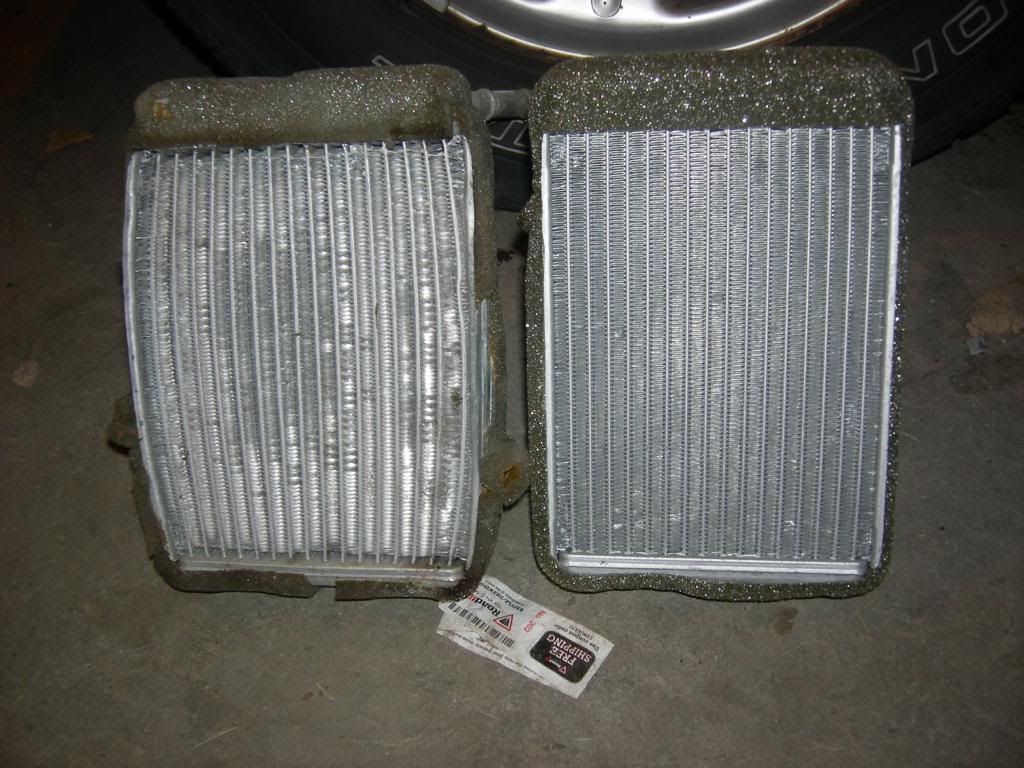

Well I decided to finally replace the heater core as I was having a tough time keeping the windshield defrosted and it was getting too cold to just have a window open. It's about the job you would expect except when you go to actually remove the heater core and it is massively ballooned likely due to letting straight water freeze in the core.

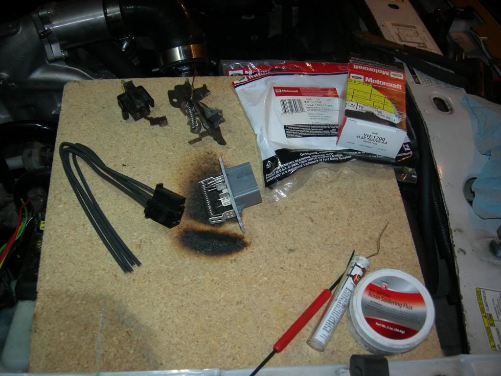

Since I only had HIGH fan speed I also needed to address my fan resistor pack which is notorious for corrosion in the electrical connector damaging the pack or the connector itself. Well mine was so corroded I could not separate the two and had to basically cut the two apart. Even then the spade terminals would not come out of the female counterparts so I had to buy myself a repair kit from Ford and solder it in. It is very nice to have heat and I have to say it is quite a bit better than my Jetta's heat.
