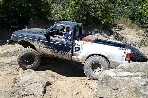

I just swapped my slab side bed for a step side on my 2003 with that of a 1996.
the bed dropped right on, new set of bolts and I was good. Plus it can with a tailgate.
the bumper was different, the guy that sold me the bed didn’t have the bumper so I had to get a new one. The tail lights fit, but the wiring harness was not the same. The plugs that go into the taillights didn’t fit so I had to jam them I sideways to get them to work. The wires were also a bit long.
The filler neck fit fine , but the hoses from the filler pipe to the tank were too long so I had to cut a couple of inches off.
Other then that, everything is great.
