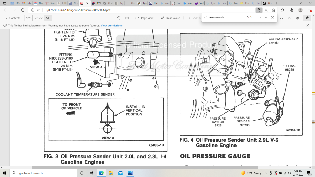

Fig.4 is why I said it had a hose... but this is from an 86 service manual.
