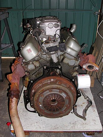

I am almost positive that's the secondary coolant hole for the rear heater in Scorpio.
I'll double check my merkur stuff.
1989 Merkur Scorpio 2.9L uses the hose outlet that is not there.
click on 2.9L and look at the 1st picture.
