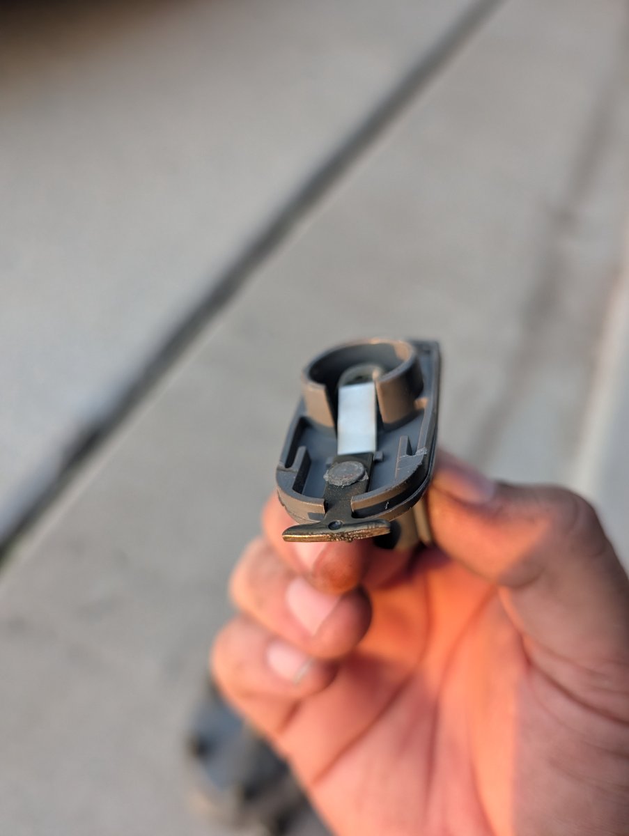

EDIT: shortly after posting this I decided to pull the cap to look for carbon tracks even though I know it's not that old and one of the wires to the spark plug separated...... Easily may I add. So also may have compounded this issue.

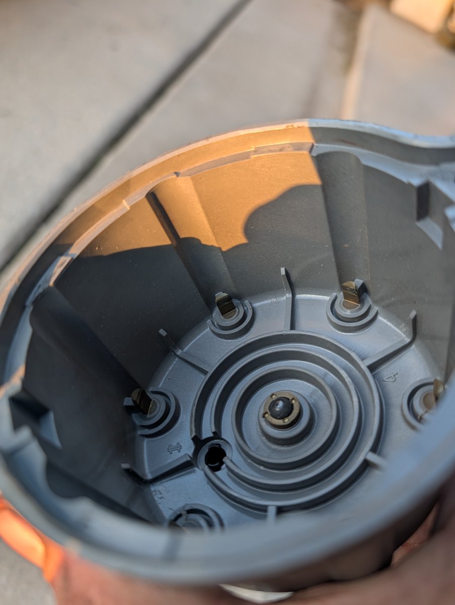

Well guys...... Looks like I've been lying to myself for the past few weeks.
Cap and rotor are have carbon on them. Let me replace cap, rotor and wires and go from there..... Should have done it with the fouled plugs instead of taking short cuts.

Unless I'm missing something in those photos, that cap and rotor doesn't look much worse than what I usually pull off mine when I finally get around to changing it, and electrical misses haven't been a problem for me. The bad plug wire sounds like it could have been an issue. Still, one bad plug wire would not explain 3 fouled plugs.
