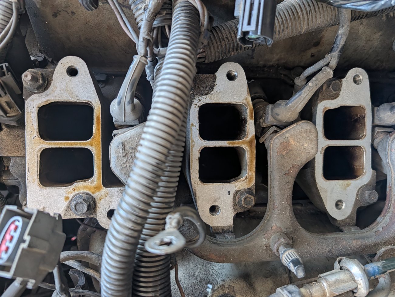

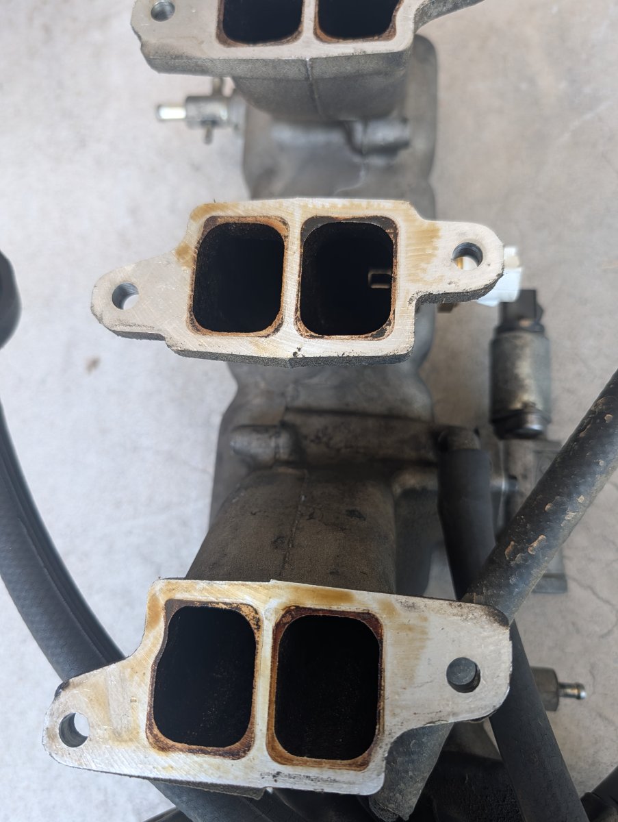

So, I'm in the tear down to getting the injectors out and came across something I don't think should be. When removing the upper intake, there was oil where the upper and lower intake manifold meet. I'm sure that is not normal. The valve cover are leaking but no way this is from that. Is this normal on these 2.9s for oil to seep right here? May from pcv valve? Definably smell gas in the lower intake.
Pic for reference. And yes there was a gasket there.
Probably a vacuum leak with this as well.....

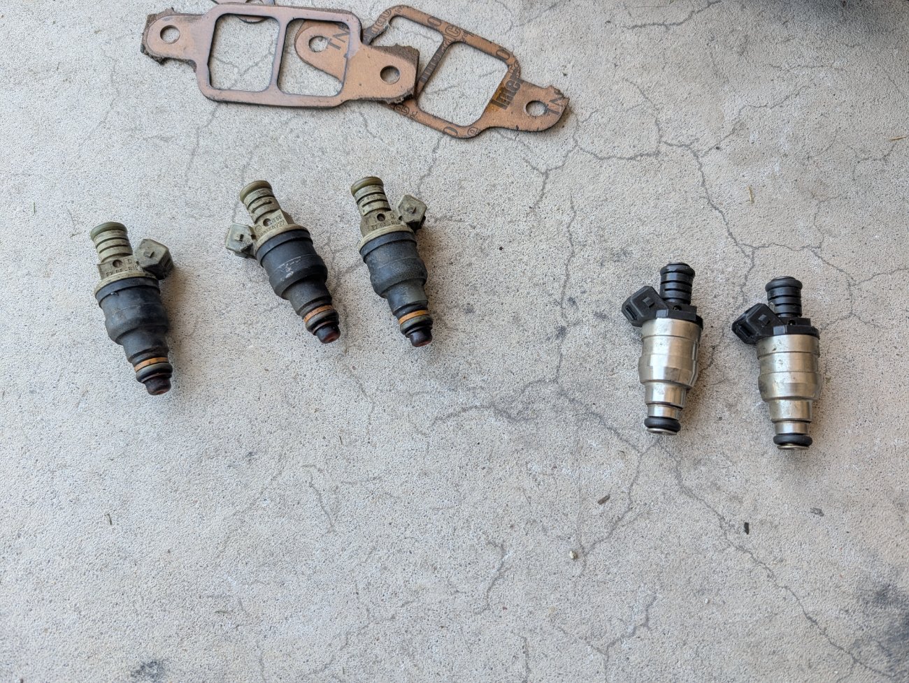

Also, I got two injectors that do not match the OEM ones. Different spray ends and all. I think these were put in by a mechanic that I had so a head gasket job about 10 years ago. I wonder if they are the same flow rate and if not is also adding to issues.
EDIT: I think those two aftermarket injectors are the issue. They spray a sold powerful stream vs a more mist like stream like the factory one.
Edit again.... The two aftermarket one are rated 19ibls according to the Google search I did on the part number stamped on the side.

I would ignore the oil issue for now, except checking if your Pcv is working right. Hopefully you're going to fix why the oil is on those surfaces.
If your mechanic didn’t charge you for two fuel injectors I would go back and ask if he found and kept your injectors. Can’t tell if those are okay or a problem, but a matched set is always best. I’ve read of some people harvesting injectors from the junk yard, so maybe there are people here that will sell you two. At least you now know about the mismatch and the fuel in the intake.
I would ignore the oil issue for now, except checking if your Pcv is working right. Hopefully your going to fix why the oil is on those surfaces.
If your mechanic didn’t charge you for two fuel injectors I would go back and ask if he found and kept your injectors. Can’t tell if those are okay or a problem, but a matched set is always best. I’ve read of some people harvesting injections from the junk yard, so maybe there are people here that will sell you two. At least you now know about the mismatch and the fuel in the intake.
Othen then the pcv, I don't know why oil would be there. The valve covers are leaking bad and the gasket will be replaced while this is evolving but I don't think the cover leak can reach this high on the intake.
I think the mismatch in the spray pattern is the main issue with those new ones. And they corresponded to the fouled plugs for sure.
That mechanic was 10 years ago and I lived in California at the time. Now I'm out in Texas. So I'll try to source some factory ones some how or good reman ones and test them before installing.
