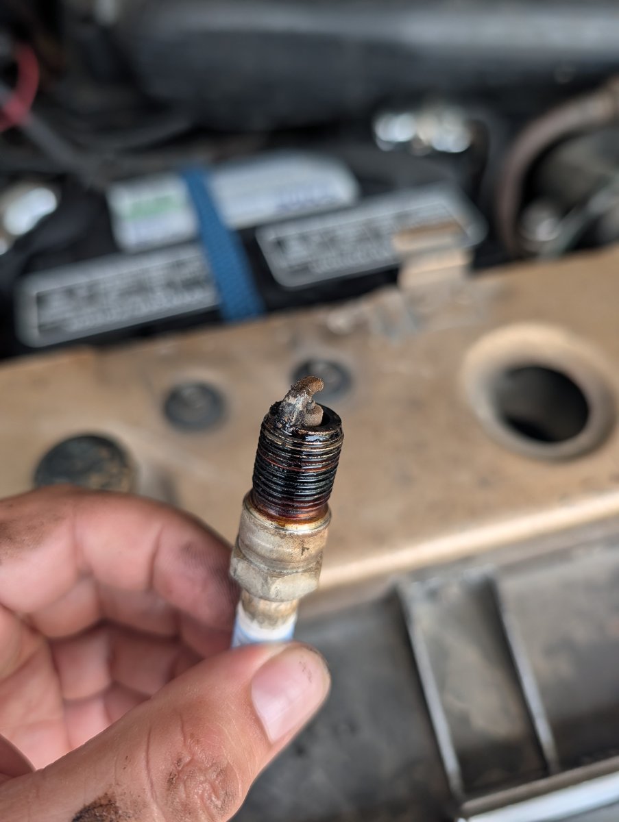

It was 3, but looking back at the pictures. The third one may have been fouled due to the leaking valve covers. There is evidence on one plug that oil was seeping past the threads. And that one was the rear most plug on the driver passenger. Also one old injector was leaky. That cleaning did fix it. Could have been that plug as well as I didn't keep track of where I pulled them other then the 2 odd ones. My searches are showing the same. 14 Ibs stock. Google shows that these are BWD injectors rated at 19ibs/ for the 2.3, 4.0 and 5.0
Oil past the spark plug threads? So like from the top? How does that work without compression leaking out?
Beats me. Its just what it looks like visually. I've attached the photo for reference.

All of that is below the sealing surface. Leads me to think it came from inside the engine. That would imply burning quite a bit of oil...
Only thing that is getting me is it is not smoking out the exhaust.
At least I would think it would. I don't loose oil that fast. Im not loosing any more oil then when I got the truck 16 years ago. And now that the valve covers are good I would expect any oil loss would be from the leaky oil pan and probably some minor burn. The engine itself only has 175k on it.
Maybe just oily threads when it was installed? Still wet after all this time?
Every time I've see oil from the top side, it starts right where that dirt line is on the porcelain.
