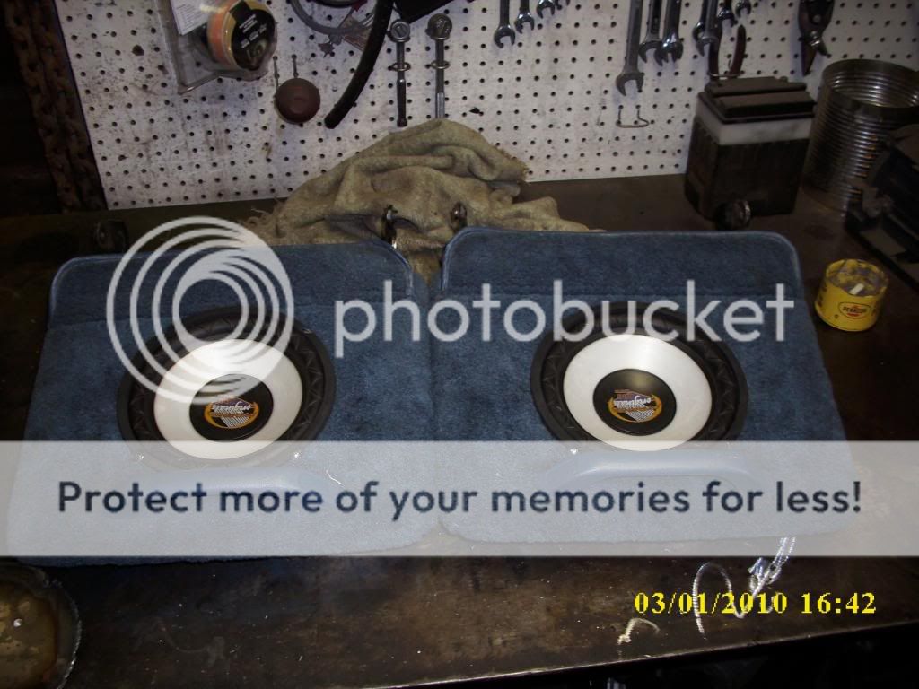

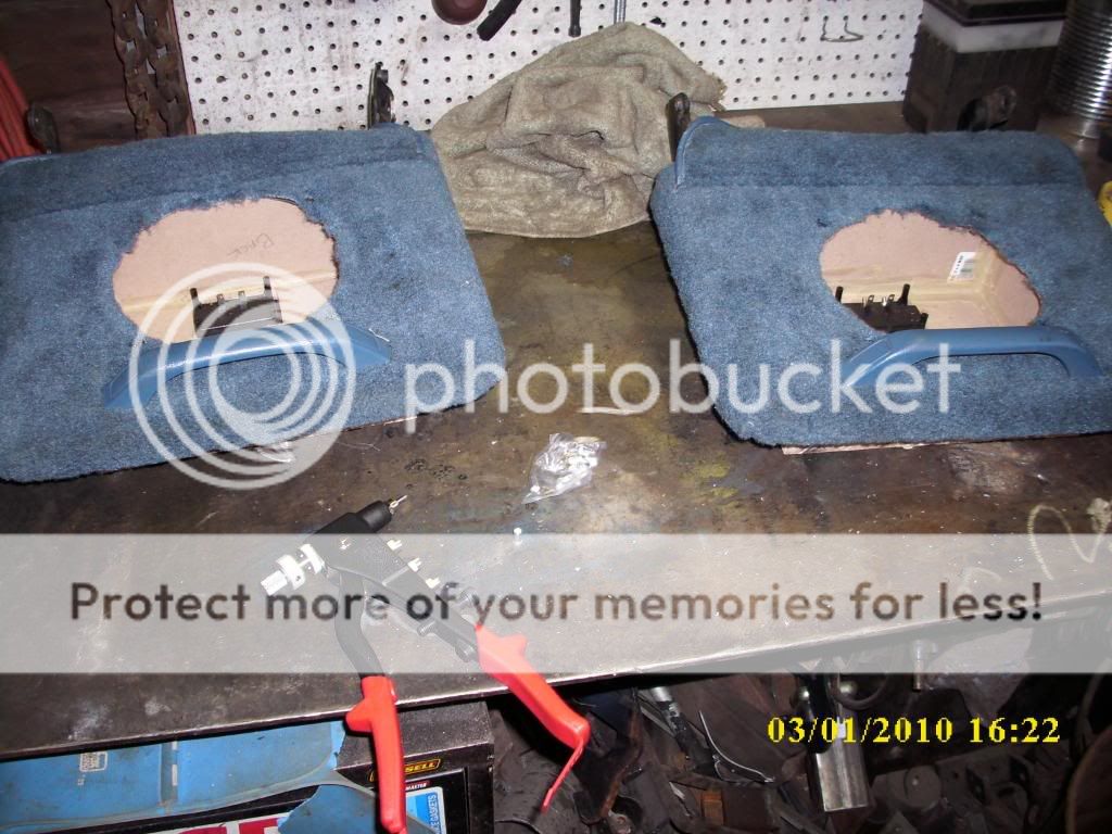

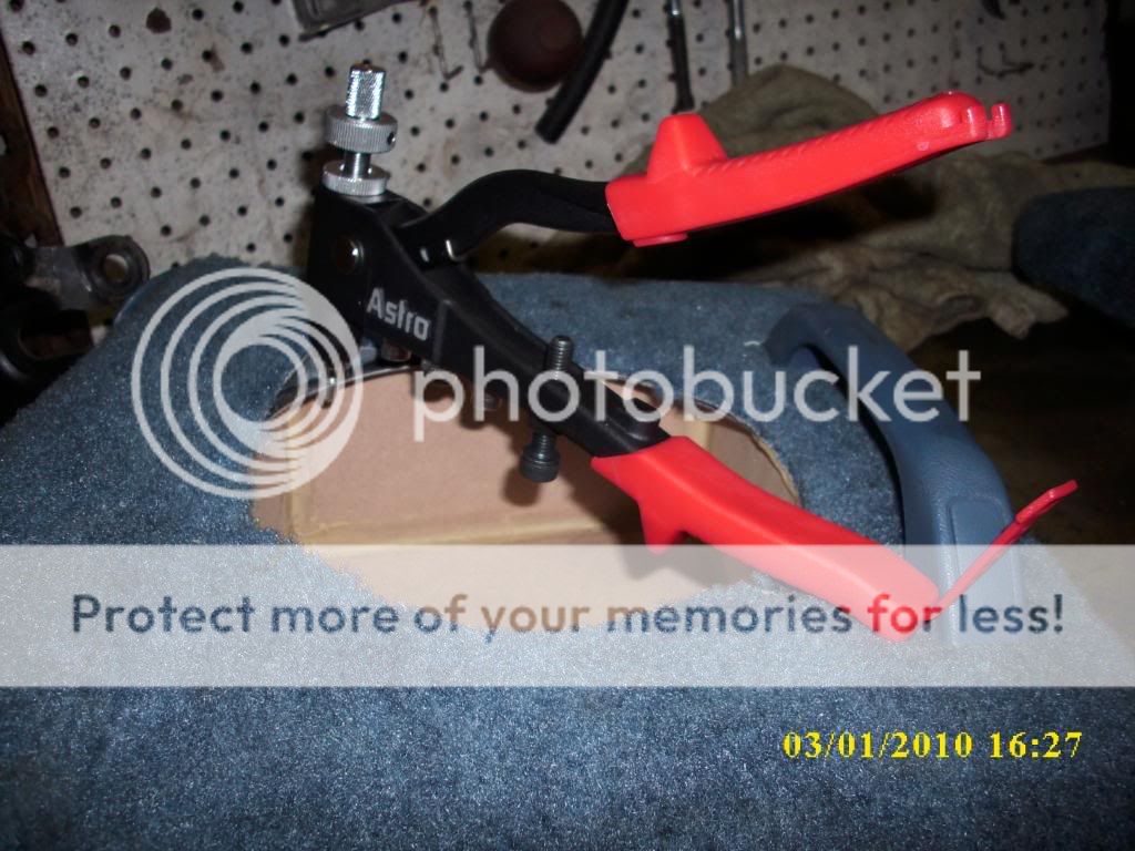

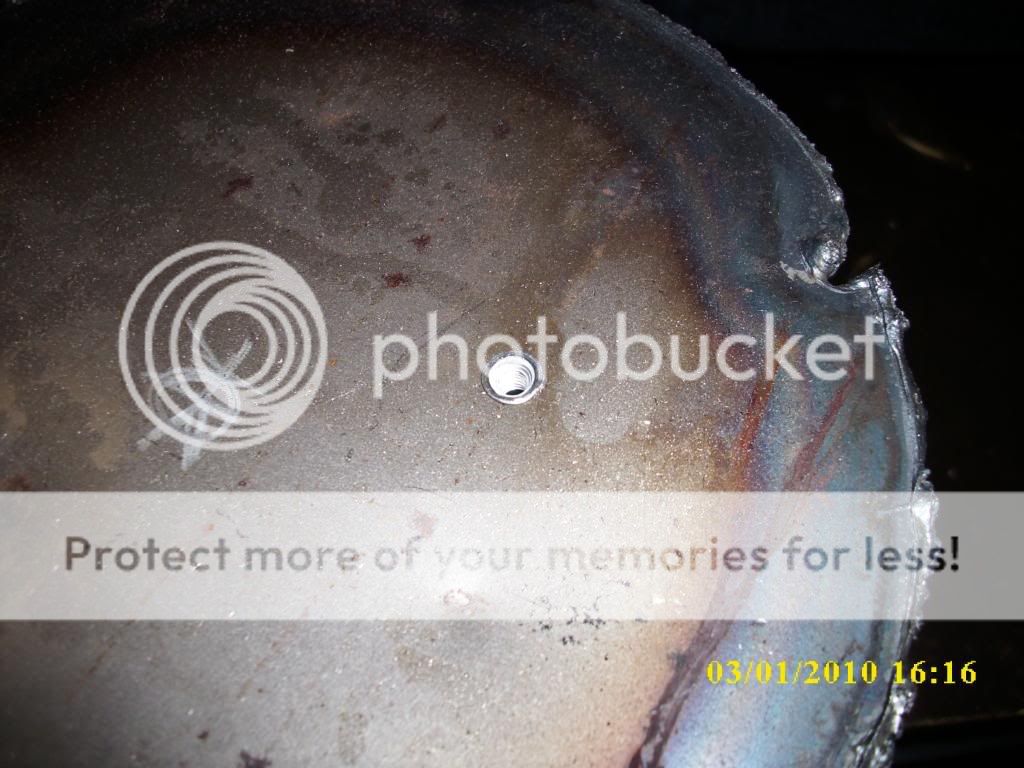

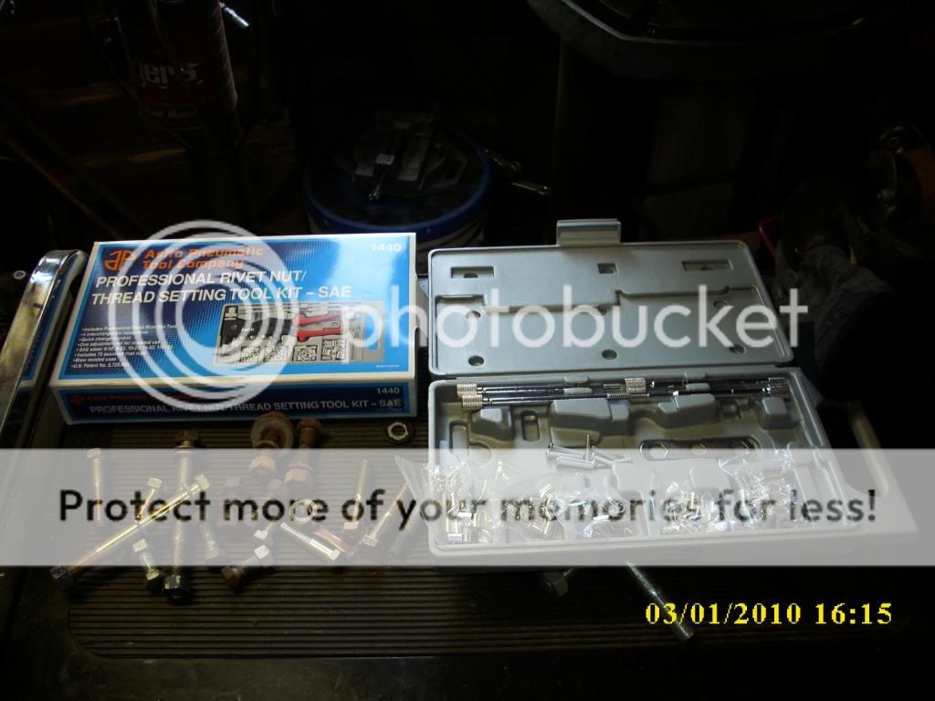

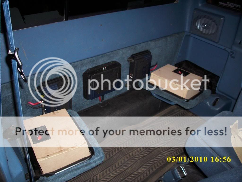

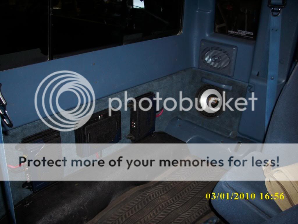

haha, no the cardboard was just a cheap way to make sure i didnt make the box too big the first time. now that its all bolted in it looks like i could have made it and inch or two deeper to get more air space. ive got more pictures of what i got done today, mostly just mounting the subs in the boxes, but the holes are real close to the basket of the sub that i had to use rivet nuts and 8-32 slot head bolts to secure them in. as for mounting my power distribution, it will go to the right of the amp on the drivers side, i glued an extra piece of wood to the back wall (youll have to look close to see it) and i plan on popping the cables out from behind the rear panel, into the block, and then right back under the panel. the ground cables are running to the studs that i put in the floor with nylon lock nuts securing them. im going to take my multimeter and check for resistance between the ground cable at the amp and the ground post on the battery to see if ive got good enough ground. im happy with how its looking so far and i really havent lost any space (my jack and wheel chocks still fit inside the cubby holes behind the speaker boxes). TTI shipped my parts today, so i should see them by friday. now i need to focus on coming up with a plan for running the speaker wires from the doors to the amps. heres the rest of the pics:
looks pretty sick, hope you get what you wanted out of them! ever consider carpeting the boxes? i suppose that would add extra thickness that might interfere with closing the seats though... just an idea...
i did think about carpeting them (i thought i had some left over from the last box i built a few years back), but then i thought i could also use the spray can bed liner to cover them with and help keep the resonance down to a minimum. ive been looking at these MTX subs as a replacement for my pyramids, but id be spending another 100-150 on this set up and ive already got more than i expected to spend into it. http://www.crutchfield.com/S-eHPL1CF4n6H/p_236T4508/MTX-Thunder4500-T4508-04.html if i do get these ill try to make my box a little deeper to get the minimum required air space for them so i can get the most out of them.

thanks for all the kind words guys, i do plan on upgrading the subs after i get it hooked up the rest of the way, but i think ill wait a couple of weeks after ive got it up and going so i will actually notice a difference in the quality of the sound. as far as the subs go, i want to stay under $150 for the pair (the mtxs are $52 a piece), but i wouldnt be shy about running some JLs, im just limited by the mounting depth (3.5") so my window of possible 8's has gotten smaller because of that. thanks for all of your help guys, you really cleared things up for me and i might not have gotten this far without your guidance. ill be sure to take more pics of the progress once my parts arrive this week.

Take a piece of 3/4 MDF or two pieces of 1/2 MDF if that is what you have, and make you a mounting ring for the sub, and attach it to the outside of the enclosure lid, and it will increase your mounting depth, as well as increase your sub options

In your case, you will want to do the same thing, but mount the ring on the inside of your box, and cut where you would normally mount your sub the outside diameter of your sub, this way it will "flush mount" your sub, but will not sacrifice the thickness of your mounting surface

i had thought about that, but wasnt sure how it would look since i dont think i have enough carpet on the seat to cover the ring? i might be able to get away with using 1/2 mdf and painting the outer rim black if it doesnt fit under the carpet, but i guess ill worry about that when i get new subs.
Ok guys, another question for you regarding the remote wires. should i wire them in series from amp 1, to amp 2, to amp 3 using the remote wire that is molded into the rcas, or should i run the first rca cables remote wire to a relay to control the other 3 amps? im asking because im not sure what the amperage out put on the HUs remote wire is and i dont want to overload it and cause shorting in the remote circuit.
