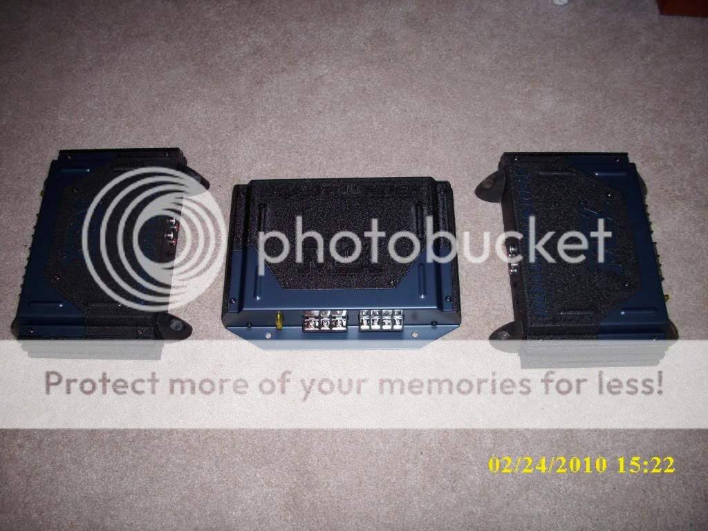

ok, so if i use 2ga from the battery, and fuse it within 18" at 80A, then continue running the 2ga until i reach the back wall of the cab, then split it into 3 lengths of 8ga and run them to each amp, then run a separate ground from each amp to the chassis or make a common grounding stud for them to share then i should be fine, right? i took some pictures on lunch of my amps all painted to match, im thinking this should turn out looking really clean and well thought out. this is how they will be mounted on the back wall, below the cargo cover so when im away from the truck i can pull it out and all my stuff will be hidden

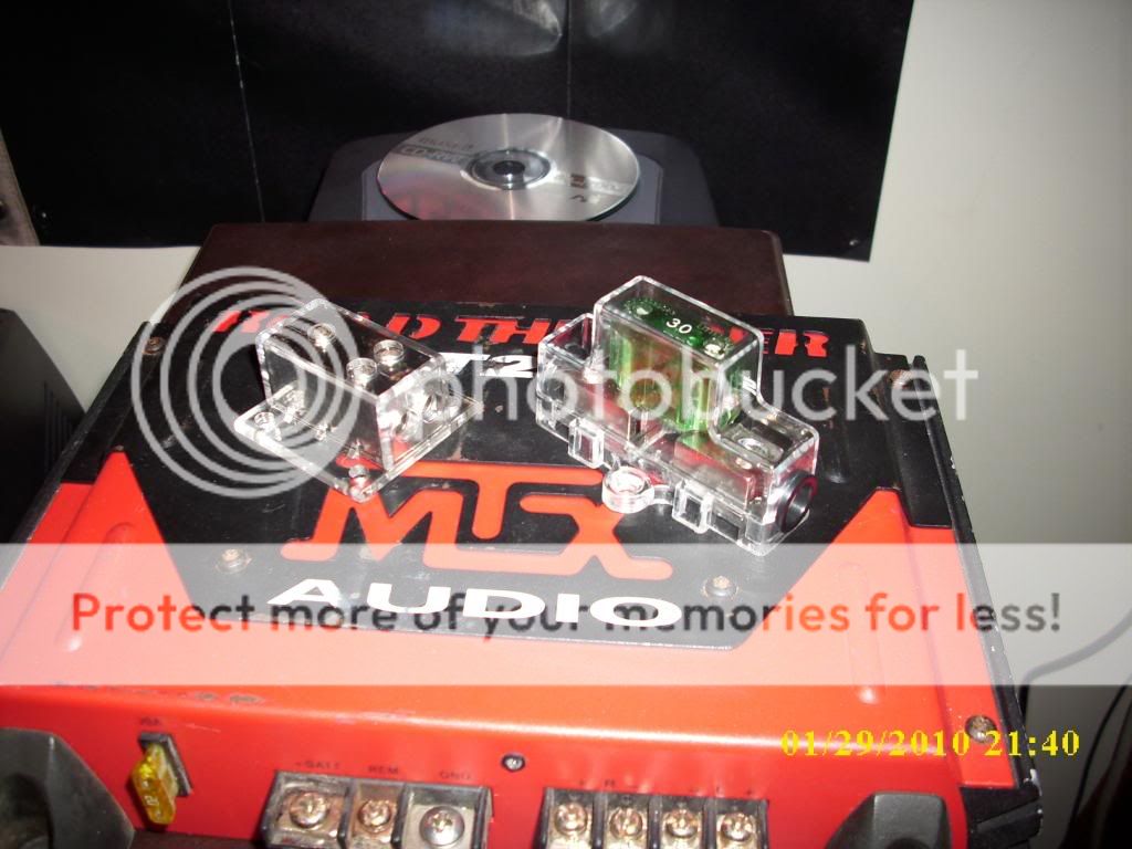

thanks for the input guys, i guess ill be running 2 ga cable with an 80A circuit breaker at the battery, then ill use a solder- type butt splice to join the 2ga to the 3 lengths of 8ga (i dont really want to buy another distribution block because theyre mostly for looks right? i can accomplish the same thing by soldering the joint and it can then stay hidden behind the carpet on the rear wall) and then fuse each leg of 8 ga with a 30A maxi fuse, like the one pictured here (i can get 2 more of them at walmart for about $30, then mount them all within 6" of the split)

Those combo fuse blocks shouldn't be that much, but yeah, you can do it that way, its just never done that way by professional installers. I would think by the time you bought 3 individual fuse blocks the combo block would be about the same. Just remember to make sure you have a good clean ground when you ground your amps to avoid engine noise.

nice job on the amps btw. very clean
thanks 4x4, coming from you i know thats a genuine compliment, hopefully youll be impressed by the install too. do you have any part #s on a 3 way fused distribution block or do i only need a 3 way nonfused block? im confused again and all i keep finding is 4ga into 8ga blocks... HELP! I keep finding 1-4ga input and 4 or 3 8ga out puts, which would make me believe i could get away with feeding it 4 ga, but the ratings that 4x4 fun posted dont match?
