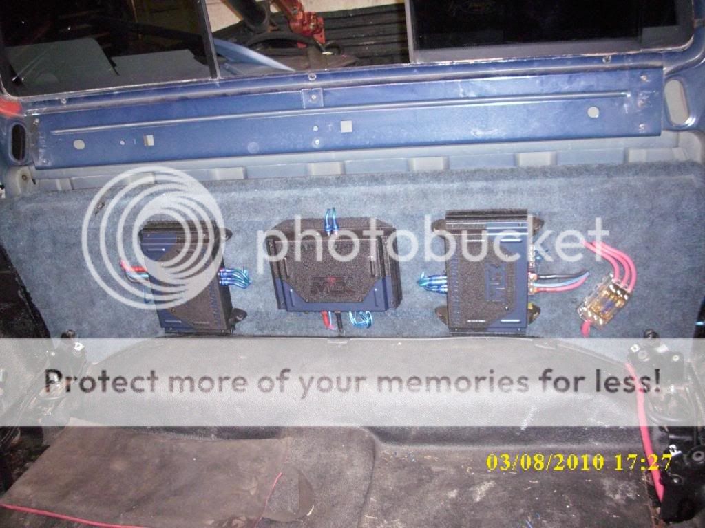

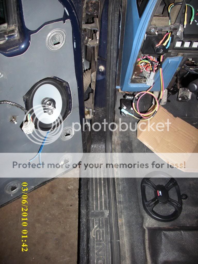

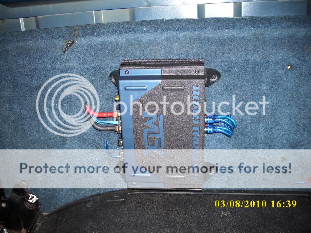

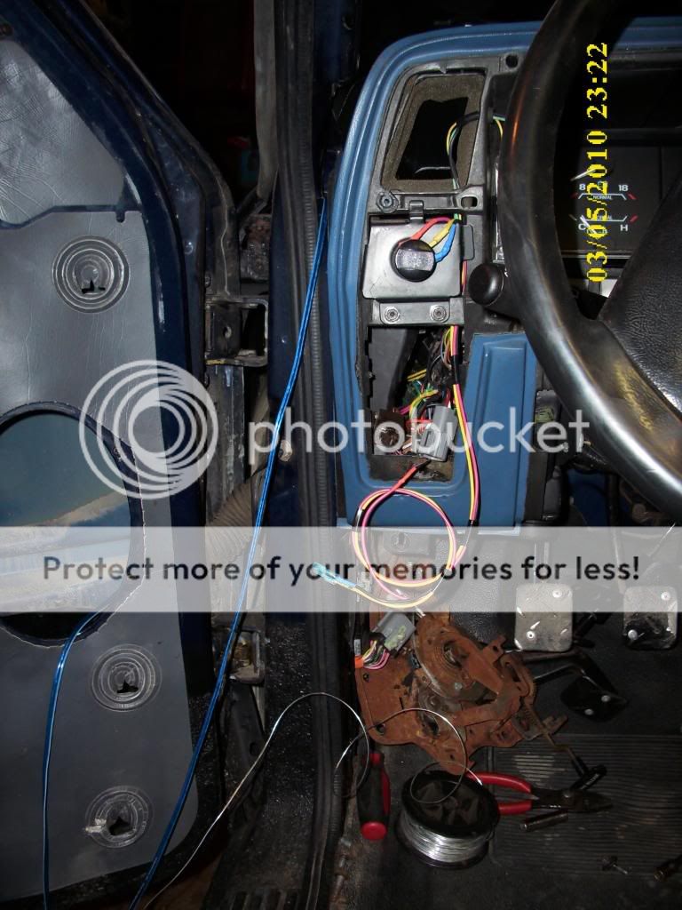

i found the problem, i feel like an idiot now. i had 1 amp wired backwards (positive and negative reversed, blown fuse was the give away), so once i fixed that and removed the relay completely i was able to get them to turn on and off with the HUs operation. i also managed to get the speaker wires for the door speakers ran and got my speakers fitted into the doors, so now i just need to tie all my wires up on the amp board and put terminals on the speaker wires so i can plug into my speakers. im figuring i should be done by monday if i keep working on it all night like i have been (i was out in the garage until 2am last night, had to work at 8). heres some pics:

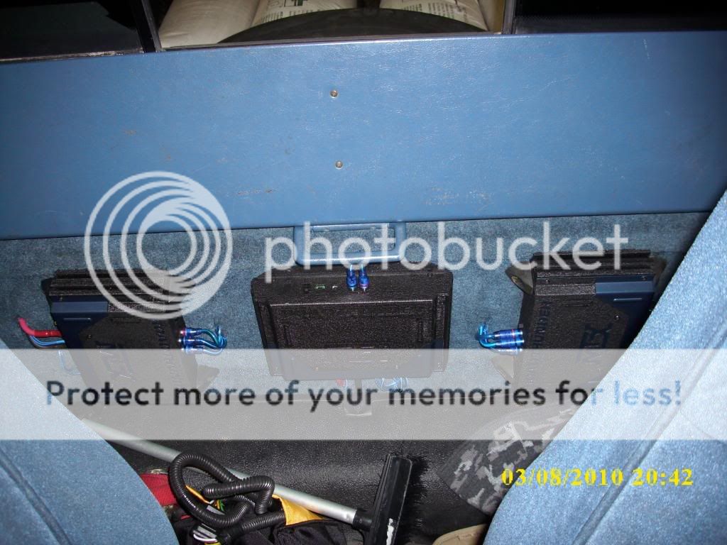

heres the shots, i like how it turned out (except for the soldering iron burn the bck board accidentally got). the bass isnt overly loud and it fills in the lows nicely. im going to run these pyramids for a while until i get used to them and then either poly fill the boxes or buy new subs to see how much of a change i notice.
Great job, looks good!!! Enjoy it as upgrades always come, because its never enough!!
