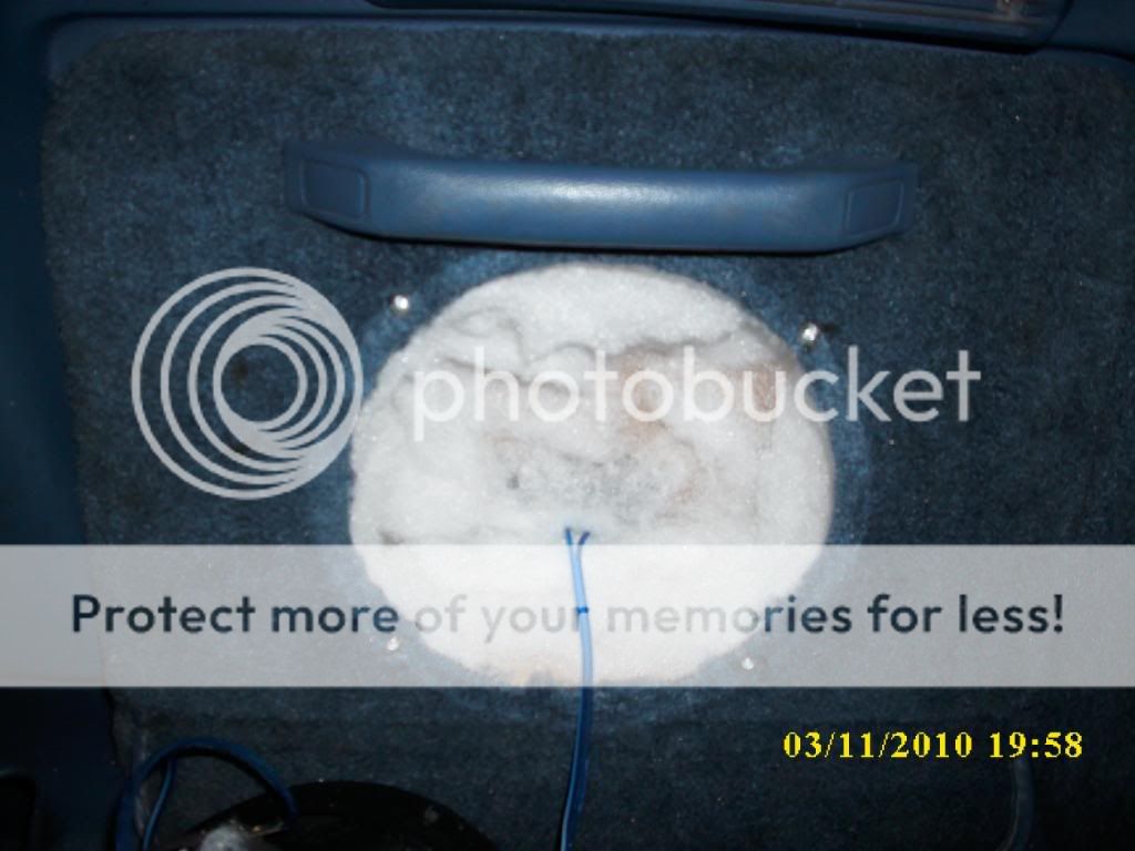

well i added some poly fill last night, and all i have to say is B A D A S S ! i didnt think it would make that much of a difference, but i was wrong. i took some pics so you can give me pointers on what i did wrong or what i should have done different. i bought some new 8-32 screws for the subs since i didnt like the slot head screws i had in there (flat blades are sharp and speakers are fragile), i endedup using the rounded ones with the smaller allen head on them.

im thinking about adding 1 more layer around the out side edge to see if i can get more out of it, but maybe i should wait a few more days so i get used to the way it is so that the change, if any, is more noticeable?
there is a limit to what you can do. to much and you can over heat the sub.
but wait a day or two to "learn" the sound and add slowly. i wouldnt go over what your thinking. that would be the max

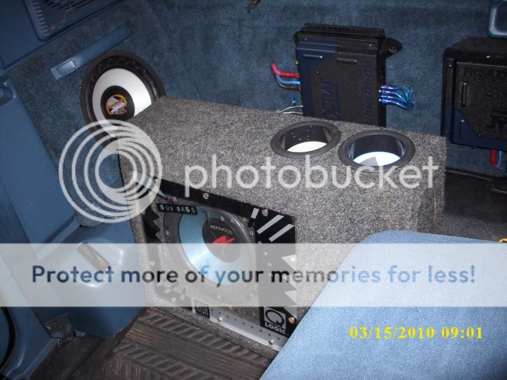

i found a temporary solution for my lack of bass until i can get those jls, its a 8" kenwood KFC W2002 in a Q-logic band pass box it (qlt-108bp.2) and it sounds great!
