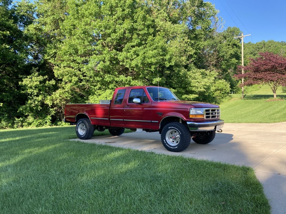

I guess I need a butt kicking because my ‘94 F-250 still has the original coolant in it. The overflow tank is a little cloudy. The truck only has 95k miles on it but it sounds like time is the factor, not mileage. What is the proper procedure for a full flush and fill?
Flushing a bad system is different than a simple change. A simple change would involve ONLY distilled water and coolant. I wouldn’t want to introduce tap water. Just pop off the radiator hoses and that’ll drain the radiator well and the engine decently. That leaves everything in the heater core though, but I’d guess that’s fine. Fill up with coolant and on the way. If you want to go the extra mile, you can fill with only distilled water, let it cycle at temp really good, then drain again and fill with coolant.
For a proper flush of a dirty system, you have to remove the thermostat. Get a garden hose after every coolant port there is and flush rigorously. Removing the water pump would be good too, but probably won’t gain too much of a better flush. Then dump a few gallons of distilled to flush the tap water out of the radiator and engine. Not sure how to flush the tap out of the heater core. Maybe fill the system with distilled and run at temp to get some of it out.
If you leave distilled water in a glass, it’ll absorb stuff from the air and essentially become tap water. Not sure how long that takes, but I’d bet that after a while, the distilled water in the cooling system loses its advantage over tap. That may be the case with your 27 year old system. Might as well do the full garden hose flush.
edit: that’s a puuuurty truck you got. You’ve taken good care of her.
another edit: if you have a heater core bypass, you’ll have open that to get the heater core flushed. That’s supposed to be somewhat of a common issue. Fluid sits there all summer and gets cruddy, then when it’s finally open a big crud ball pops out and clogs something.
