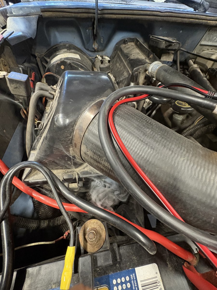

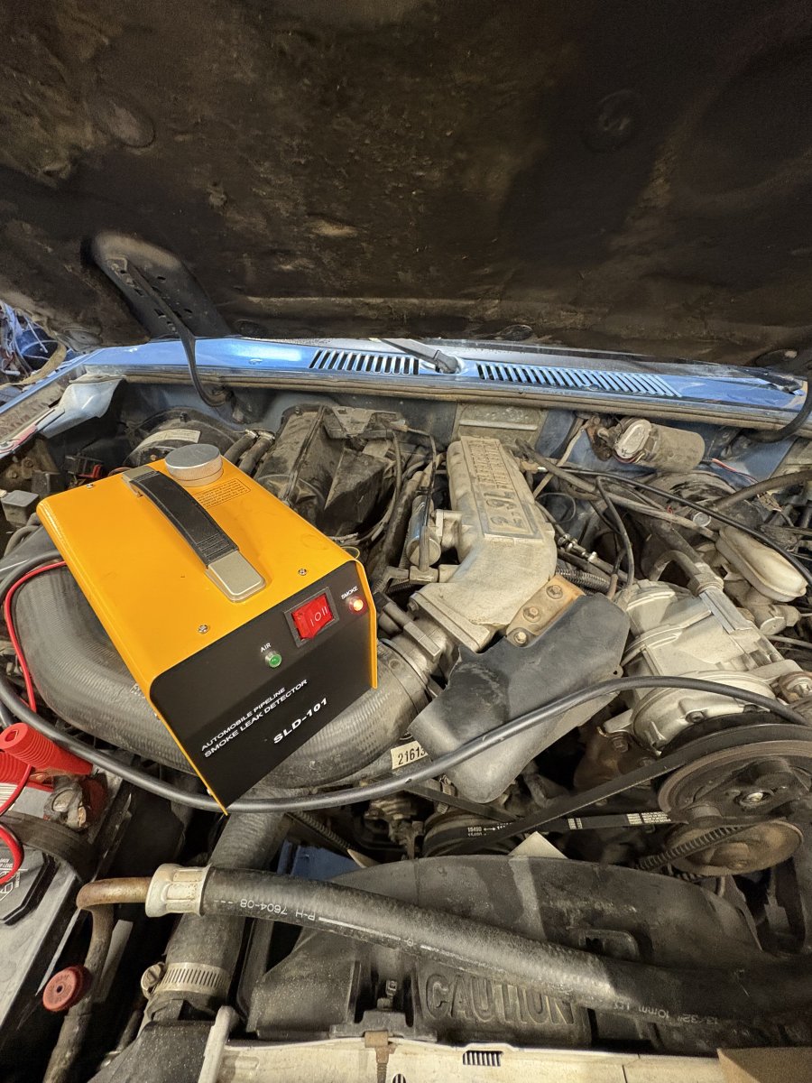

I think I gave $64 for this smoke machine off of Amazon. Great little machine.
Biggest leak around air filter.

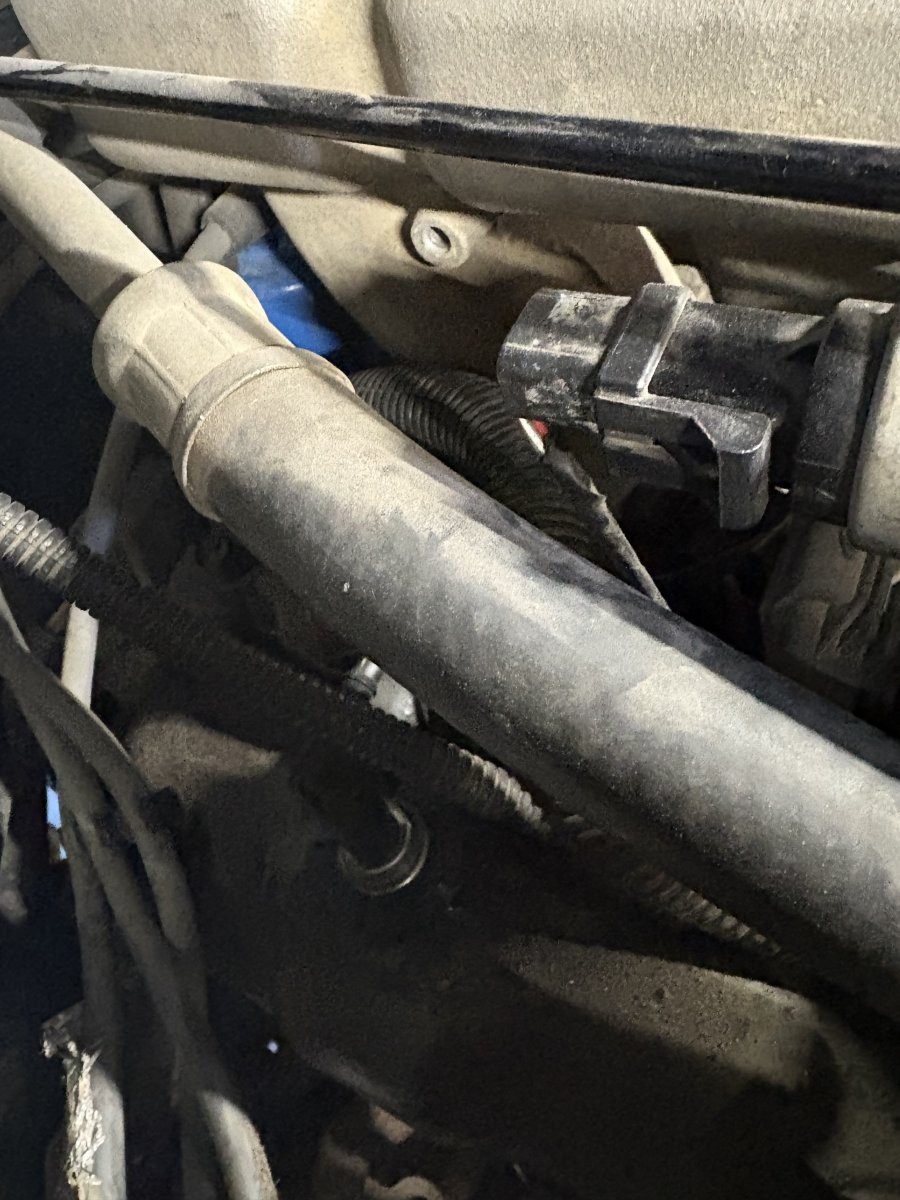

Every once in a while, I did get a whisp of smoke around the hose to the PCV. I suspected it was a leak

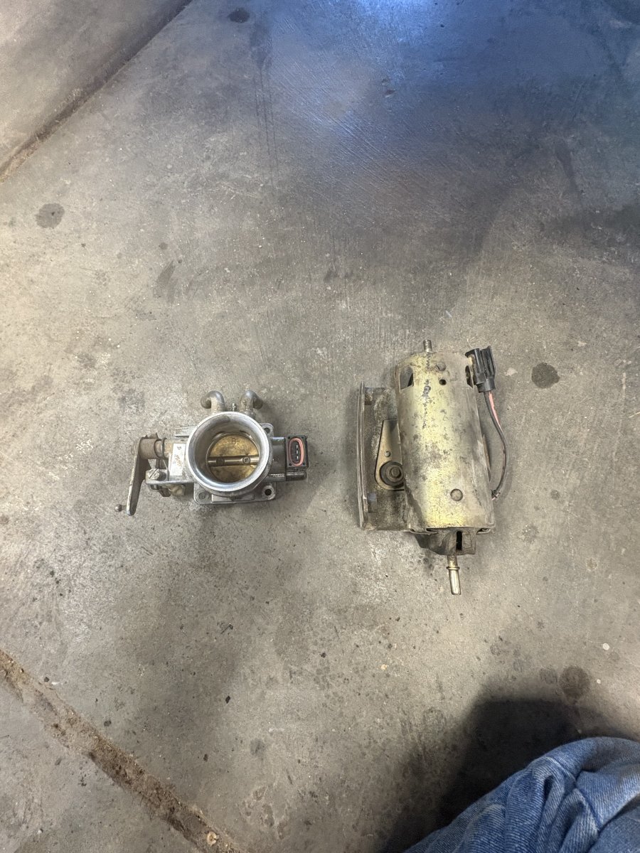

I originally replaced my TPS with a Standard brand. I feel Standard is a great brand for aftermarket but I wondered if when I replaced it, there is a minor adjustment when installing the TPS and I did not do that when I installed it. I put a Throttle Body Assembly from another motor on just to see if it will fix the conflict between the IAC and MAP???

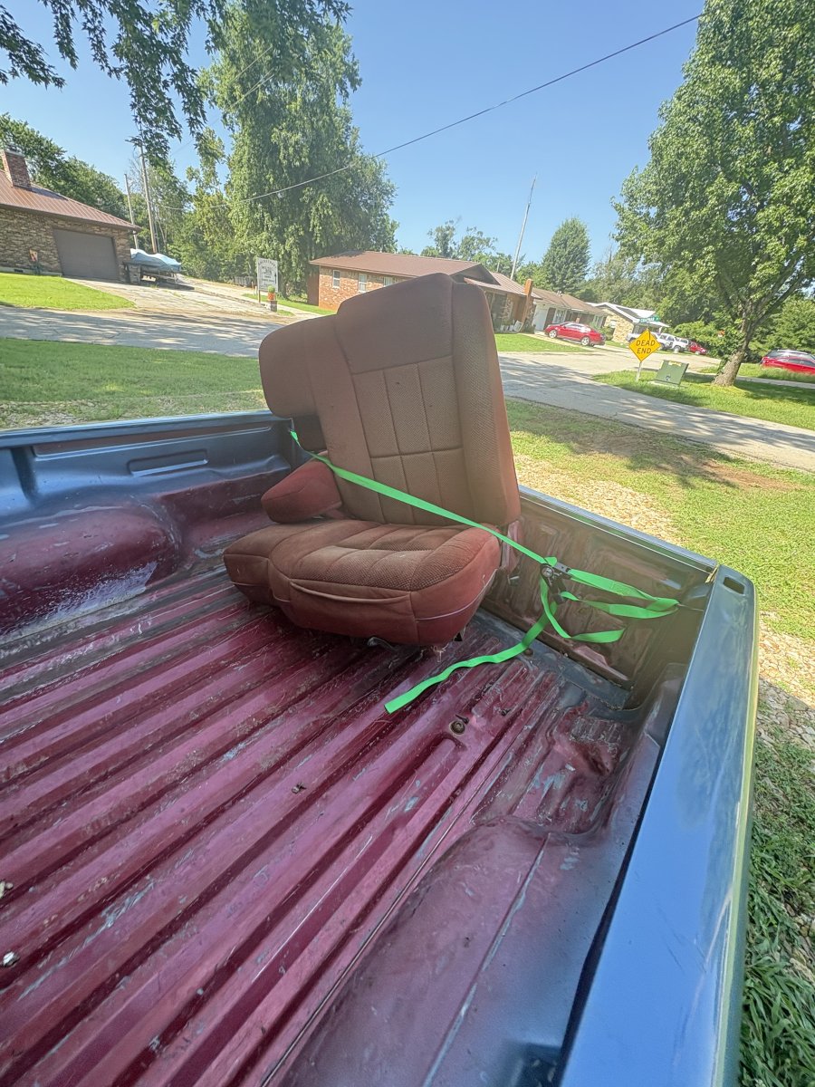

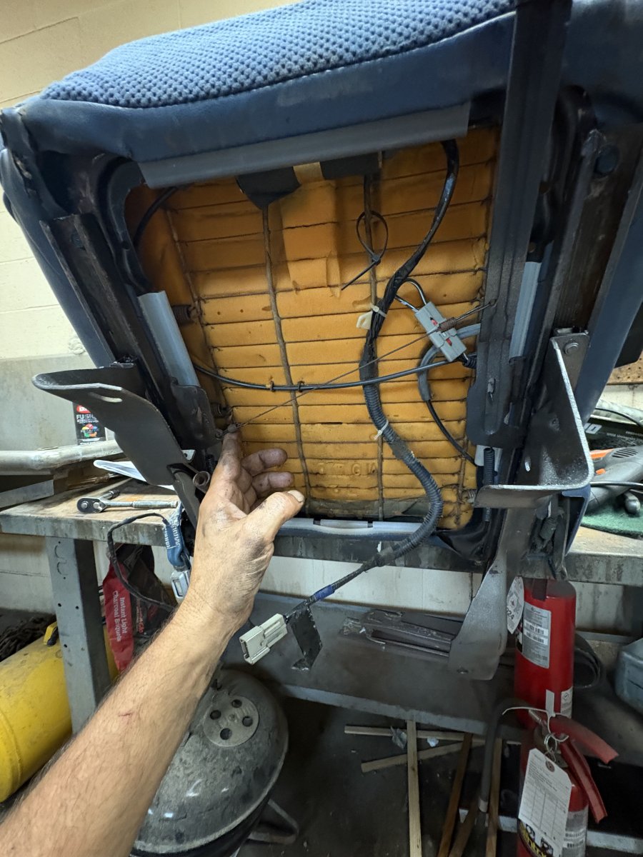

Got this seat out of the boneyard for the base for my new to me air lumbar seats. I need to make up a wire harness for the air pumps. The red bed is getting my attention. I need to get it bed lined soon.

@SenorNoob I had a spare Throttle Body with the factory TPS on it. I installed it and that solved the idling issue. When I installed the new Standard brand TPS, I did not think that there was an adjustment on it. Apparently, there is the slightest adjustment to it that I see on a video so will be looking into that a little bit more. Having a correctly installed/adjusted TPS made a world of difference on the truck. I wonder if the erratic idle you see on here, YouTube and elsewhere that several have problems with, besides the MAP sensor, that this is a common issue?

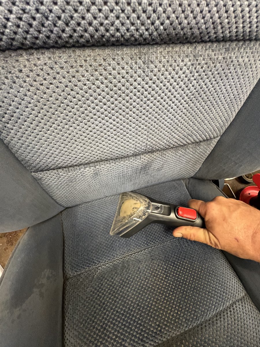

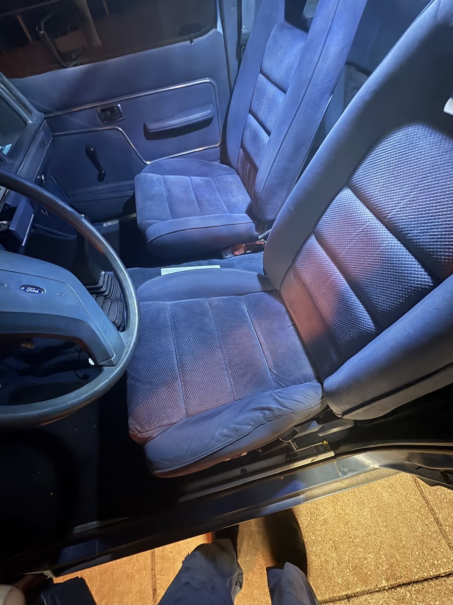

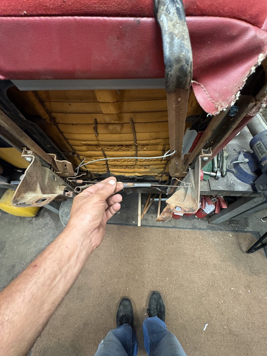

2 steps forward, and 1 back. I cleaned this seat up with the Dirt Devil dirt extractor. All happy with it until i sat in it. The right side in the back by my shoulder just feels like it is twisted. I’m not sure how to fix that. I have another seat so will clean it up and see.

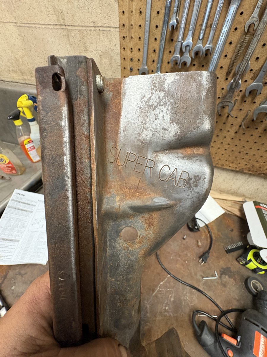

I needed the base off if the junkyard seat for my driver side. It was dirty, surface rust and difficult to slide. I cleaned it up, painted and lubricated the slides. I also got the correct spring off of another seat in the yard to replace this clothes hanger fix. Slide us working great.
it is even stamped “Supercab” on bracket.
Here seat slide is all fixed. I just got to clean the other seat and move it over.

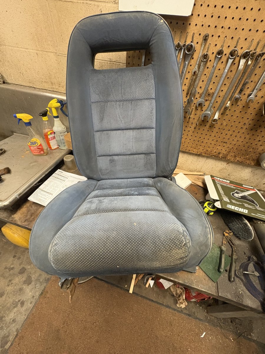

This is the other driver seat I have. It is grungy. The seat I installed yesterday, the seat back is twisted. I was able to pull on it and get it nearly close but can’t to try this one.

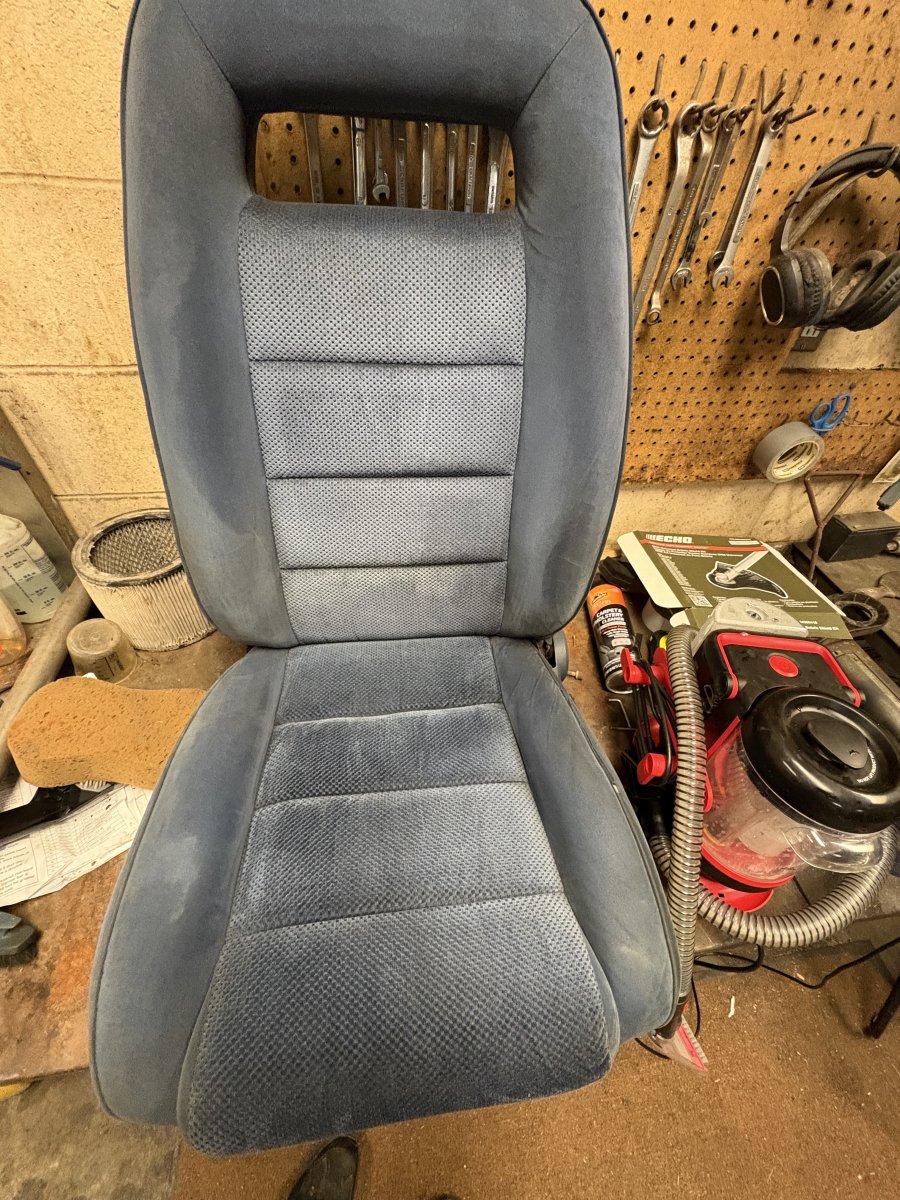

You can see the dirt being pulled out. Still going to spend tomorrow cleaning it.
Far better than it was.

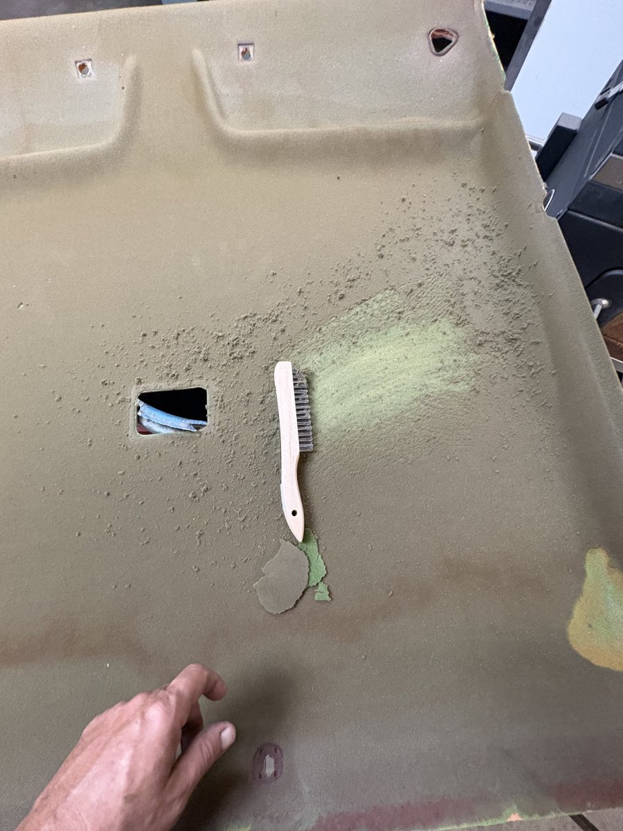

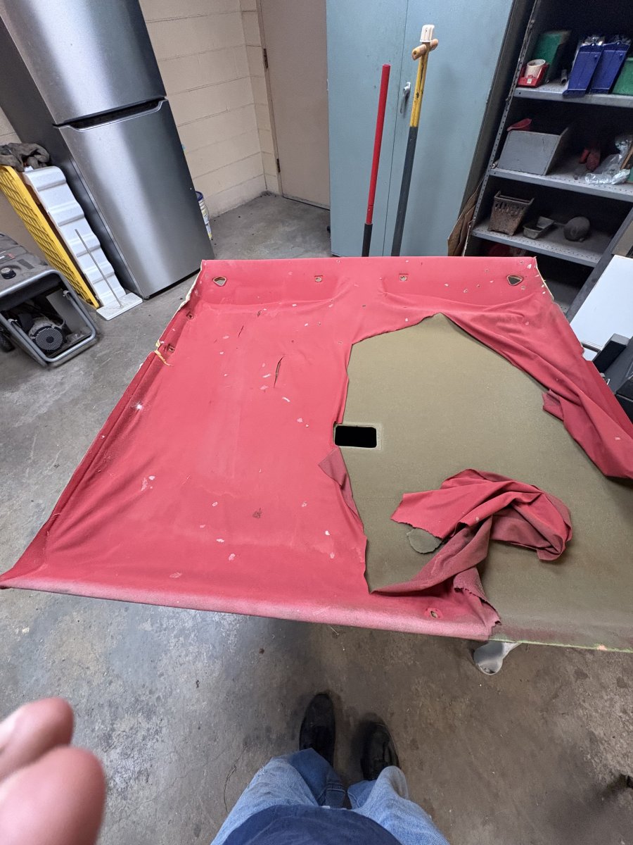

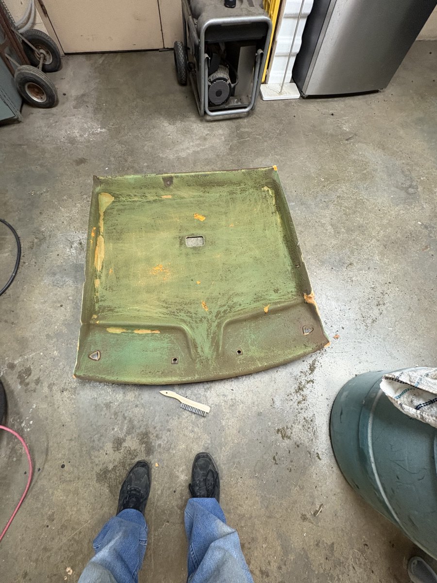

A job I have been putting off for a long time. I have a cab off if a wrecked truck. Giving a try at doing my own headliner.
A new wire brush held at a 45 degree angle and lots if scrubbing.
Hopefully tomorrow I can install seat and start getting headliner on to the base. Still have to take all trim out if truck to do installation.
The couple of times I've messed with them the cheap aftermarket didn't have enough range of motion to work. I ended up with junkyard parts.
