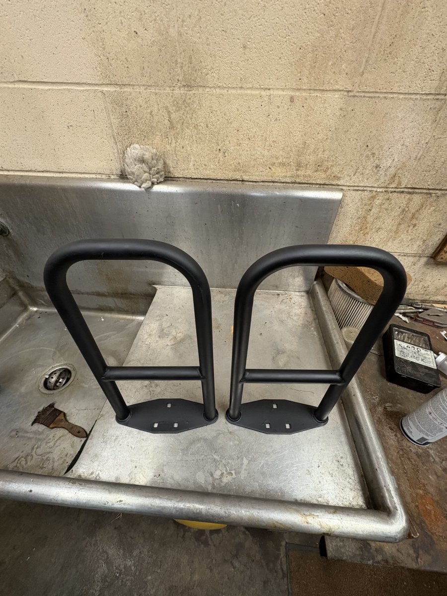

My welding is terrible. A friend of mine is going to weld these on a little later today. I put the effort in removing old paint and rust. Used some rust killer and the rust encapsulation. Hoping this will last a while. I had to put one in a vice and get it straightened out as it had been in a collision.

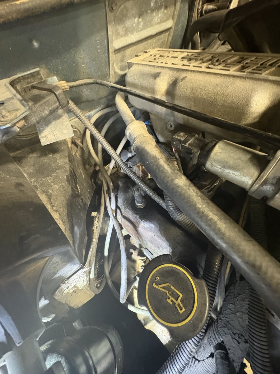

I have been looking everywhere on idling issues. This weekend I am going to look for a smoke machine to test for air leaks in the system. My PCV valve seems to be good but got one on order and getting a new grommet for it. I trust this truck to go coast to coast but want it working the way it should.

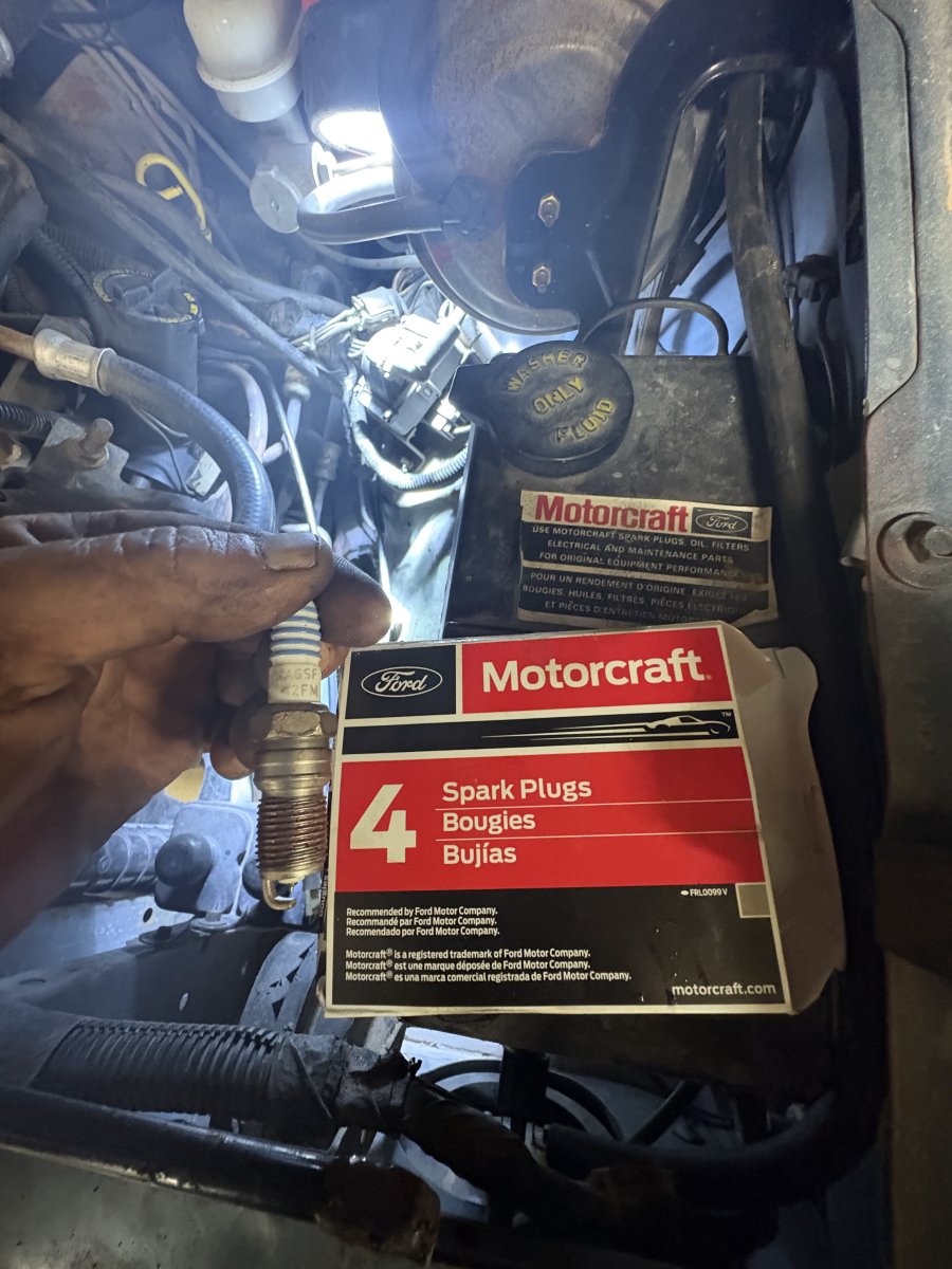

I got a set of Motorcraft Platinum plugs, of course later it is suggested to just get the plain Motorcraft plugs. I will see if Motorcraft plugs will make a difference.

I went to friends house to have him weld the hoops on. He seen the holes in the hoops and said let’s drill the holes. He had some drill bits from Orielly and they have three flukes on them. Some tough and great drill bits. I am adding them to my tools list.

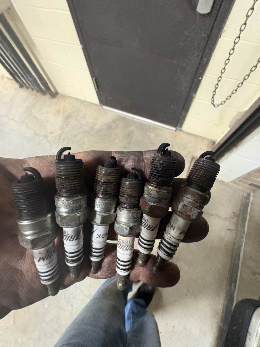

I thought NGK platinum would be good. NGK is a good brand but maybe not for the 2.9. All are evenly rich. Maybe over a year old.
I installed Motorcraft platinum. Kind of wishing I would have went with just plain old Motorcraft. Mileage is 54372. I will pull a few plugs when they get 10k miles on them.
I don’t know if you can see it but it is a new seal around PCV valve. I got another new one on order along with PCV valve. Also have a smoke test machine from Amazon on orders to look for air leaks. A friend of mine and me looked and could not find any.

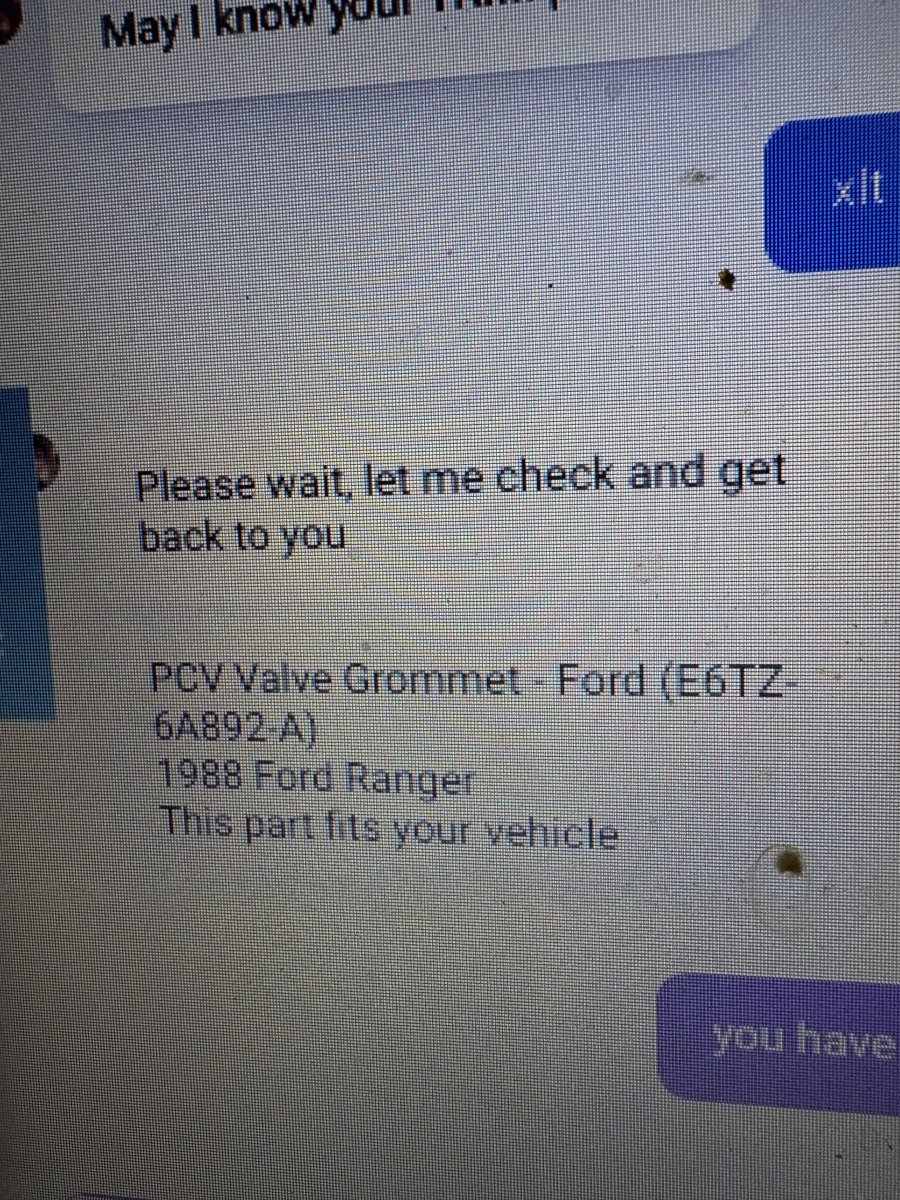

Ford part number for factory grommet.
If they're that rich I would be replacing the pre cat O2 sensor(s) if they haven't been in the last decade... the engine doesn't get rich from spark plugs, it's something else.
I agree ^^^
Its a symptom, not the cause. O2 sensors have a lifetime of approximately 100,000 miles.
@scotts90ranger and @alwaysFlOoReD Thanks and I agree with you, there is something else causing issue, spark plugs did tell me it is a rich problem. I replaced the O2 sensor when I got the truck. Faulty parts is not unheard of. I will get another O2 sensor.
I am battling 2 problems, 1 is an idle problem and 2 is the running rich issue.
Running Rich problem
A. One the Rich issue is not enough air (vacuum leak) and computer/ injectors adding correct amount of fuel causing rich.
B. Faulty Injector/S, both banks are running rich so I cant see just one injector on either side being bad but will check.
C. I did find a Youtube video of possibly a corroded wire to the O2 sensor pre heat. I think this is a one wire O2 sensor but will need to verify. I have not looked yet. I am seeing a corroded Fusible Link so that is a possibility.
