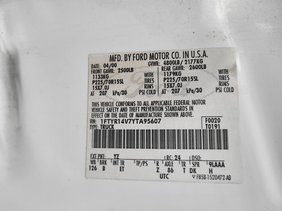

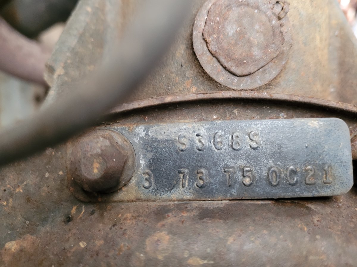

I took a couple of photos today of the center of the rear, the tag & the door frame sticker - matching them up with photos of a 7.5 & an 8.8, it looks like it might be a 7.5 and the rear is original
Everywhere I read today states that my Ranger rear, with the code 86, is a 7.5 open rear with 3.73 gears so my plan will be to locate an 8.8 - thanks everyone
