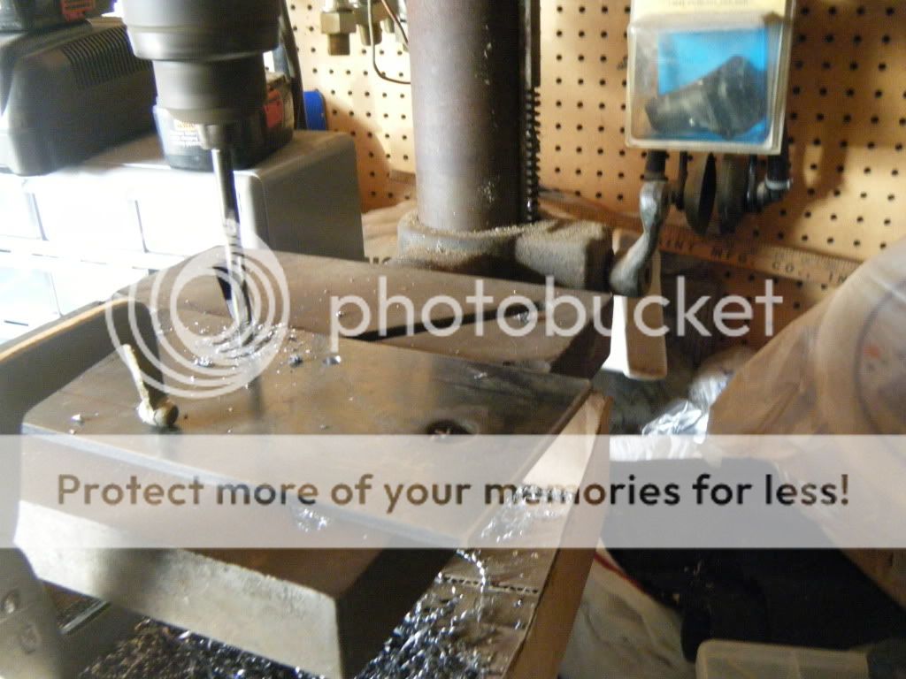

Next time you do this, put the drill press in reverse, while spinning in reverse pick up your center punch with the drill bit, while holding the quill down on your work piece, clamp it, then put the drill in forward and drill your hole. That way the drill wont cut the center punch mark before you want it to and it will locate better.
Looks good, I like the way you are going with this! Keep it up!
My press don't have reverse, otherwise I would have...Everything else is what I did to center it....drilling the first step with the 3/16 was dead on every hole, it walked when I step-drilled it...If I have time tomorrow I plan to weld the endcap on the case...If it warms up friday I will drop my 20 from my 77 bronco and get the spud shaft and main gear so I can get the measurements and send the shafts off to get them machined together...

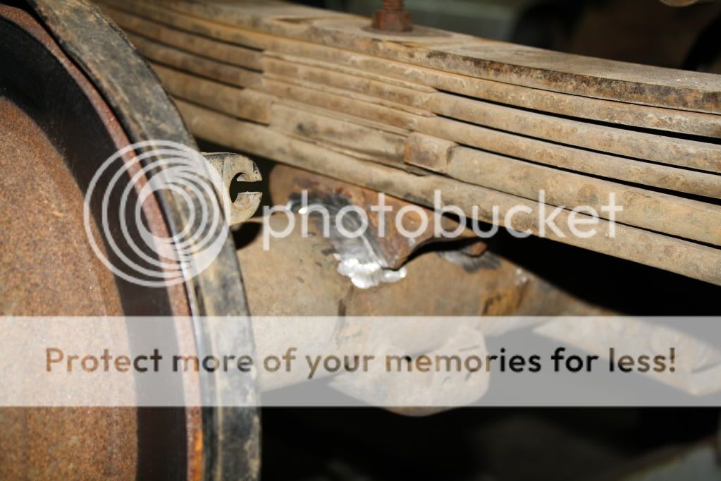

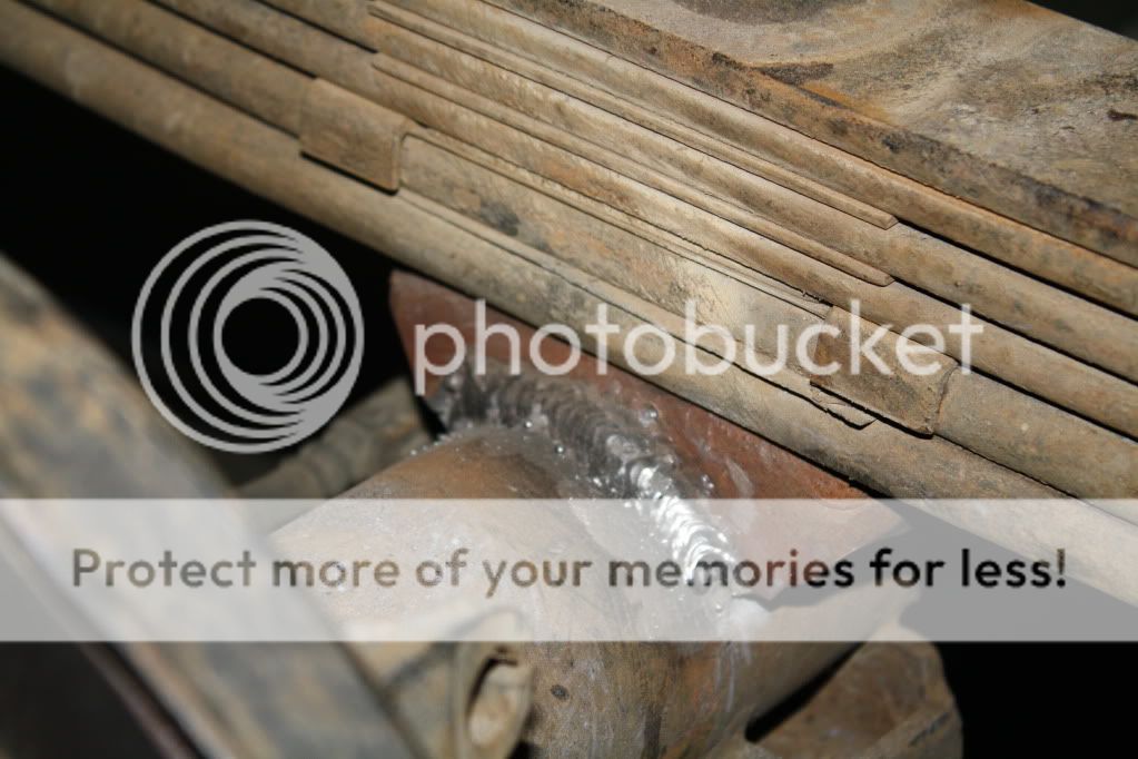

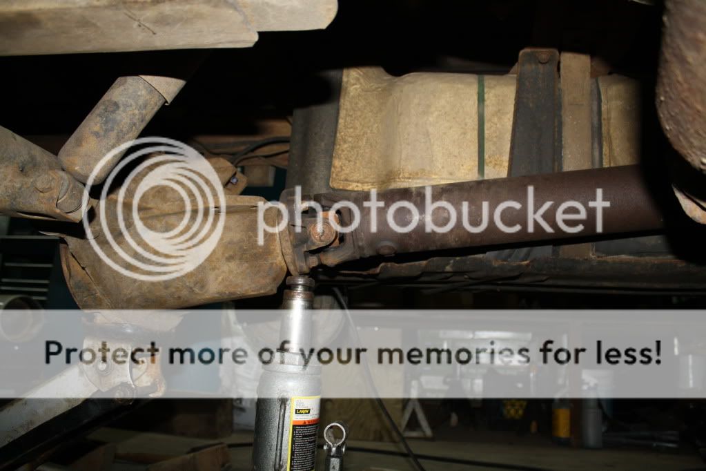

Well, time for an update...After a $h!tty long weekend and an even $h!ttier time after I got back home (which I thought was going to be good to get back to my life) that went totally wrong and unexpected (Go figure :annoyed:) I did manage to get my rear pinion angle corrected from where my axle tubes spun. I didn't get a whole lot of pics, camera person wasnt around to take them as the fabwork happened...
I still need to fix the driveshaft from the previous owner (thinking of building my own with some slightly bigger joints :D) I also got the rest of the materials for my doubler build and I got word the case is done, so I need to go pick up the case sometime in the next 2 weeks ( its 2.5 hrs away) get the cases finished and get a final measurement so I can start machining the intermediate shaft. I'm thinking of setting up my own spline cutting machine so I can do that in-house and have it done faster since that will be the last piece of the build, well, except for the driveshafts :icon_thumby:

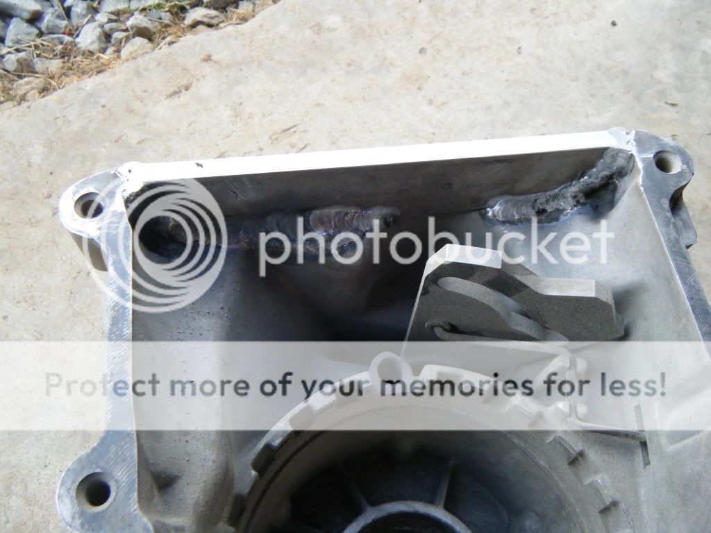

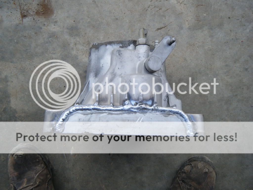

Well, its been almost a month, but I finally got my tcase back from the machine shop. I can't complain, cause they had a few hot jobs that took up a lot of time, and it was done in their spare time, (IE FREE!!!) Anyways, for those that say BW cases can't be welded, here ya go!!

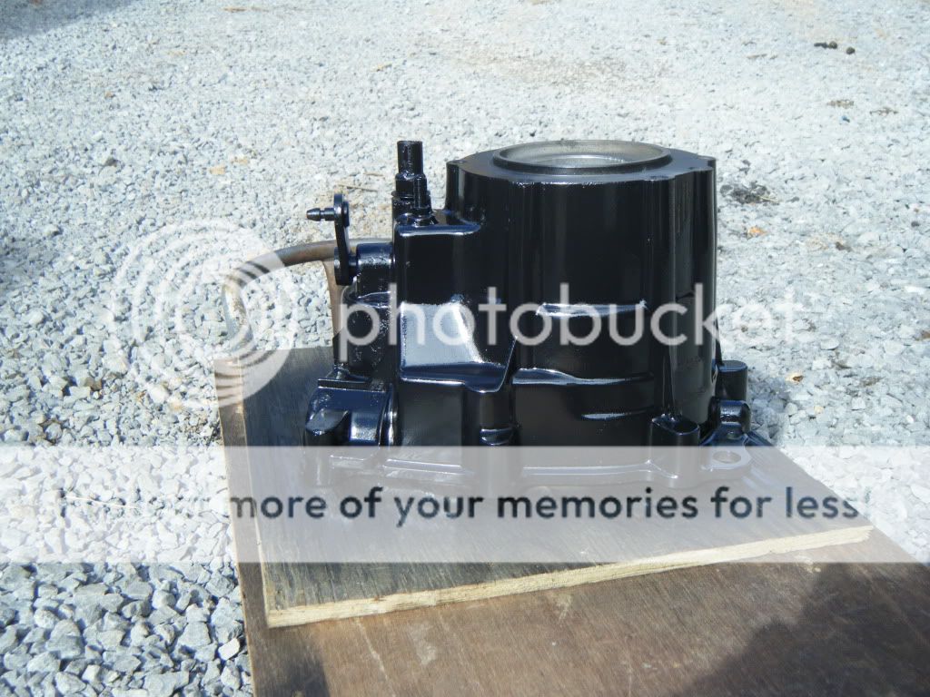

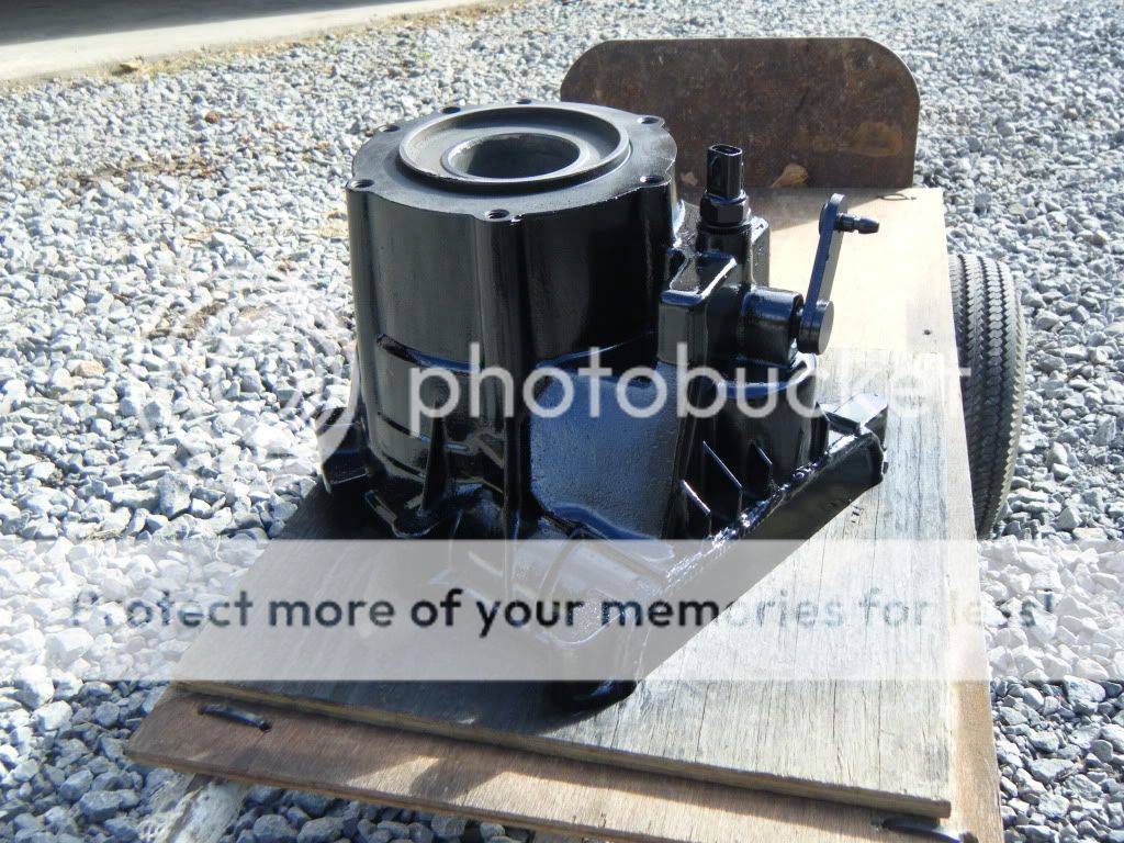

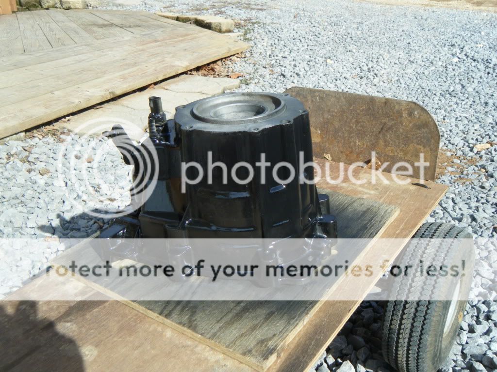

Because of the high magnesium content in the case, as soon as the puddle starts to cool, it pops, so getting the puddle/weld to hold can be time consuming and tricky. This is why you see cracks on the back side...Since it will not be a structural part, I'm not worried about it, it's just to keep the fluid in the case...I was surprised to see that they sand blasted the entire case, so I decided to wash the case ( had sand on the inside), air-dried it with compressed air, then painted the case. Since it didn't get that warm today (about 50), I let the paint harden overnight, and start on the adapter plate tomorrow.

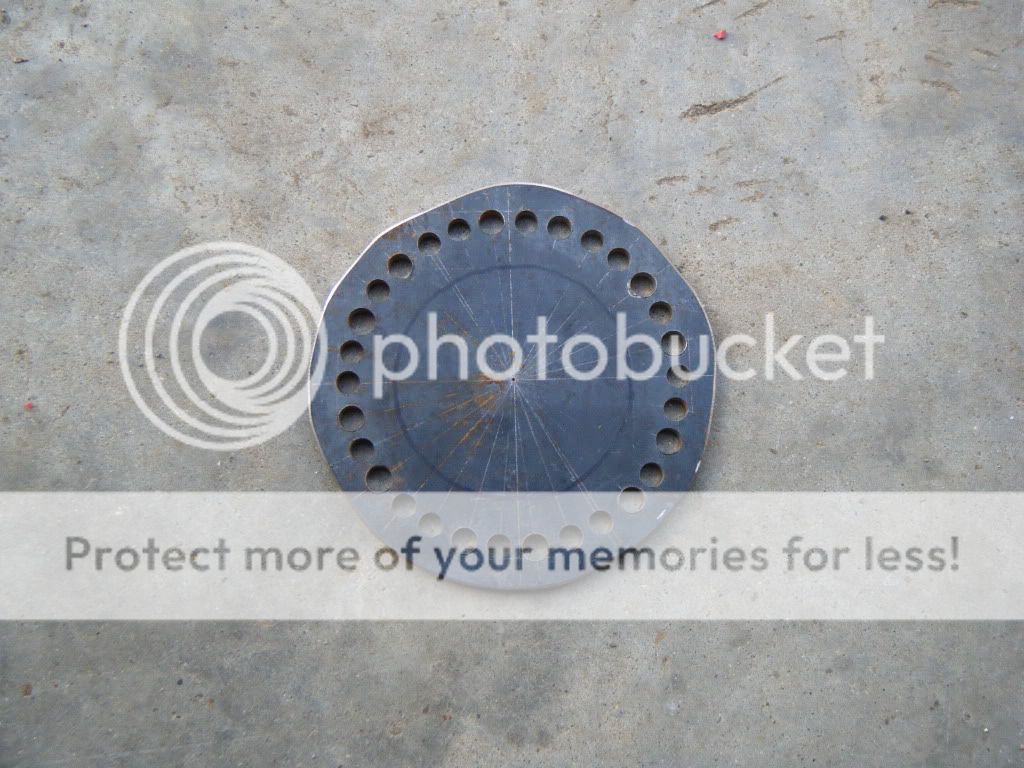

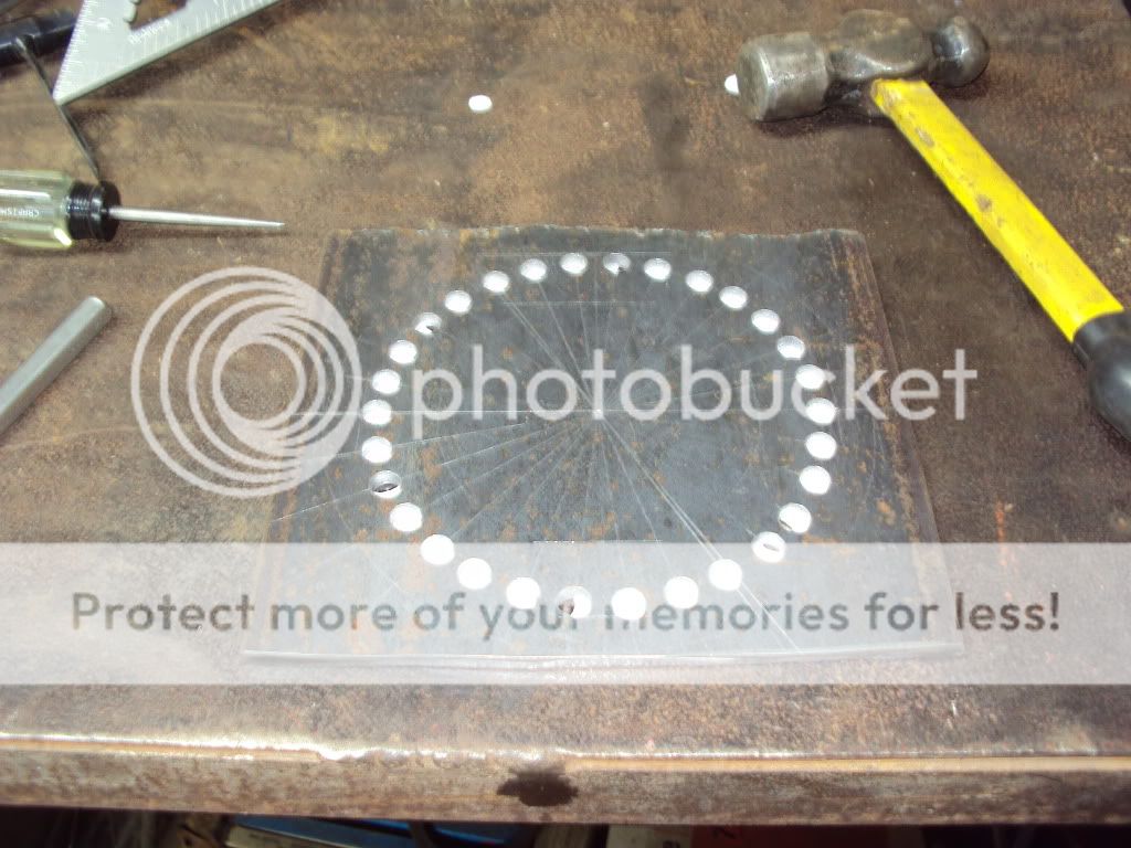

I also did a little work on my mounting plate, cut the excess edges off. Sometime next week I will get a 4" holesaw and cut the middle out. Here is what it looked like last...
And what it looks like after...

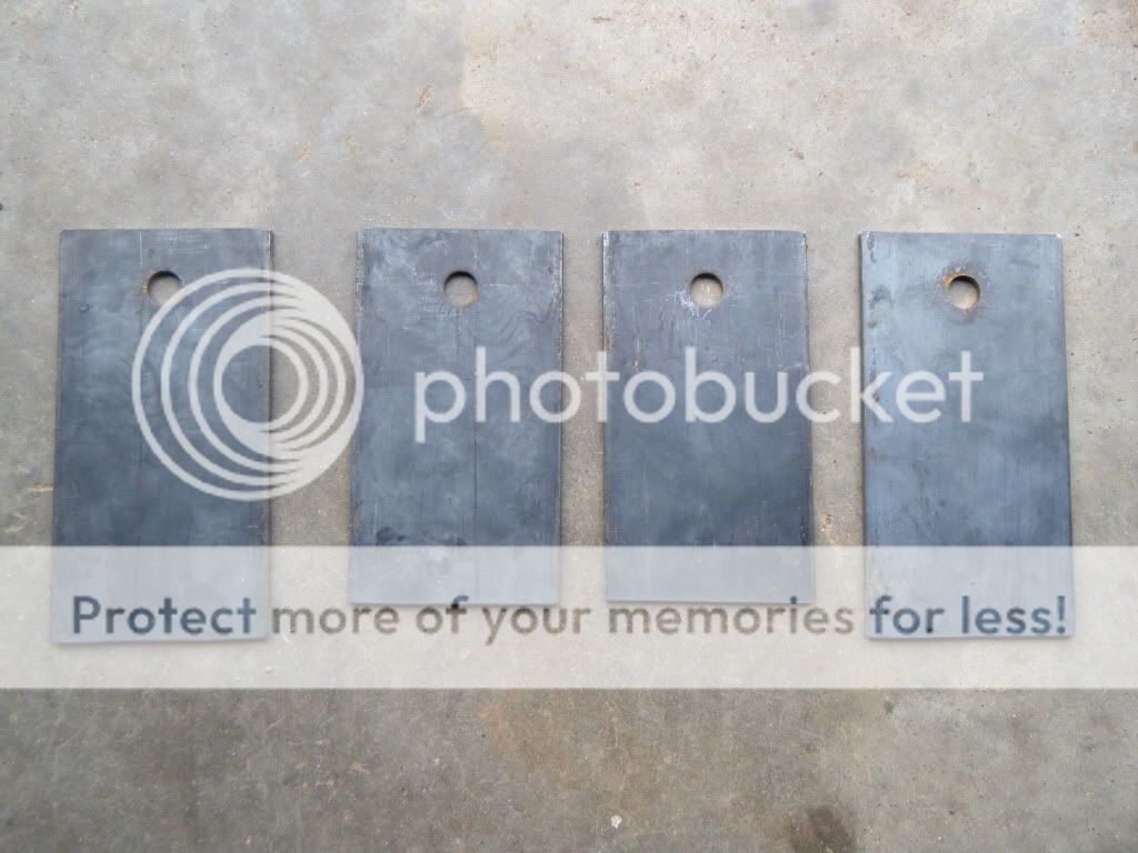

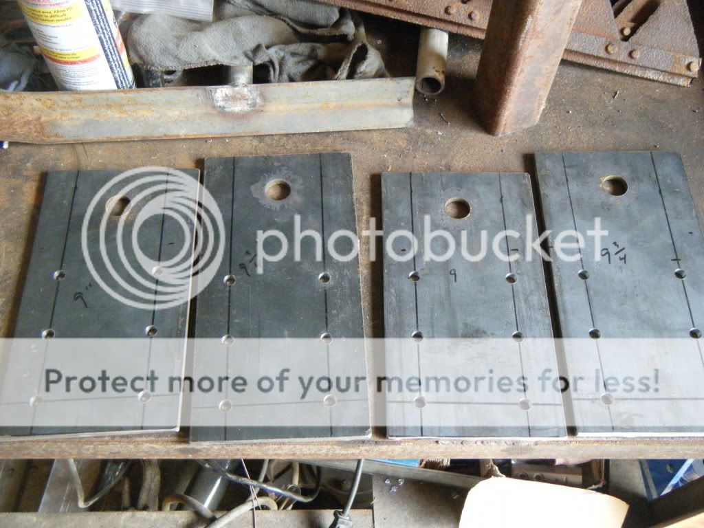

The edges are not perfectly round, but I'm not too worried about that. Since I couldn't do too much work on the case, I also started fabbing the brackets for my sliders. I got them finished, but I didn't get a chance to attach them to the frame. Got called away to get my fire truck from the shop. County just bought my station a truck, and before I get it in service it has to go in for repair :annoyed: Anyways, here are a couple pics from the brackets, the hole in the middle was there when I got the material, will have to fill it in for my plans...
