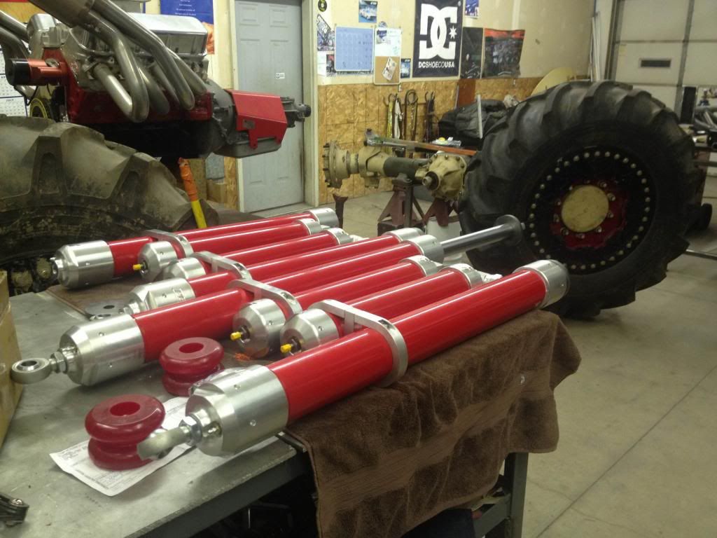

If I didnt already have plans for the axles under SVT, I'd have sold them and have a pair of these. Should be getting a pair in a couple months...
