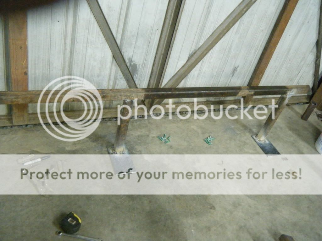

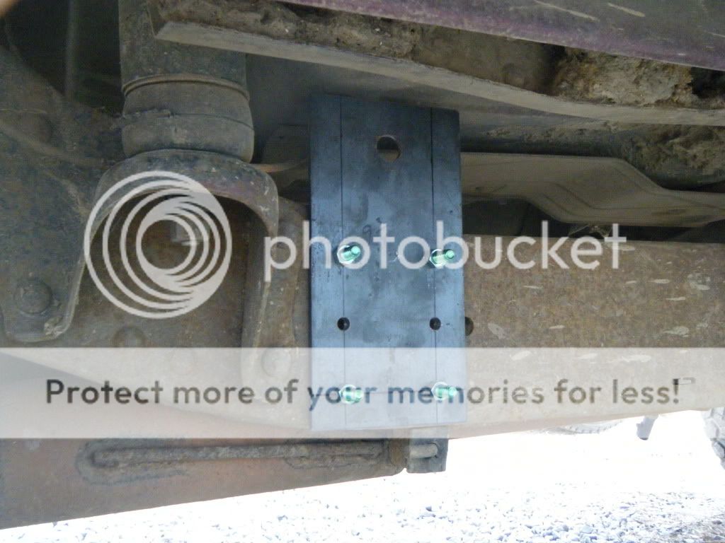

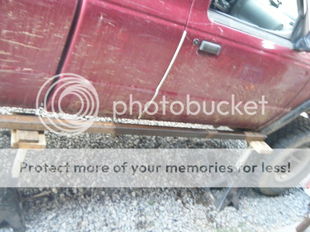

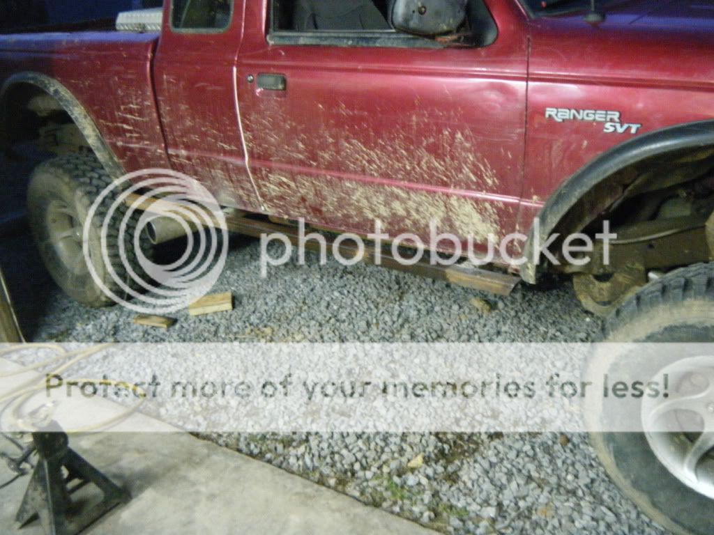

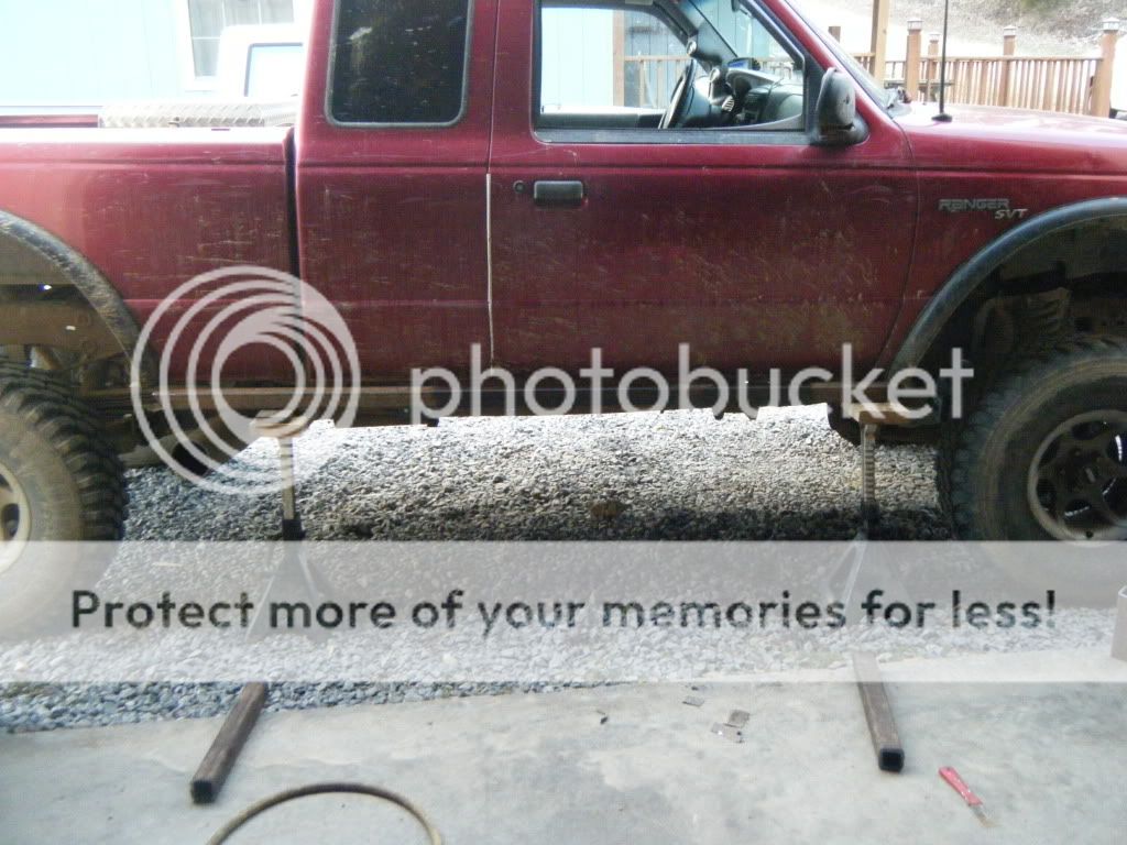

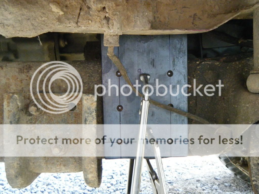

Well, I finally got some work done after 3 days of trying. I started on the passenger side, as it was easier to get to the inside framerail. The driverside I will have to drop the fuel tank, as I need to remove the brackets about 3 times...I'm not quite finished the passenger side, but I got about 80% of it finished. Still need to put another leg on, sand it and prime/paint it...I wanted to use 2x4 tubing thats under the rockers, but I only have enough to do one side...Here are some pics of what I have so far...
If the welds look funny its cause I'm using flux core wire, it's more forgiving on dirty and surface rust material. Hopefully tomorrow I can get the passenger side done, sanded and painted, and finally installed tuesday. Most likely, both weather and calls permitting, I'll start on the driver side tomorrow and should have it done same day so I can get both installed on tuesday...
