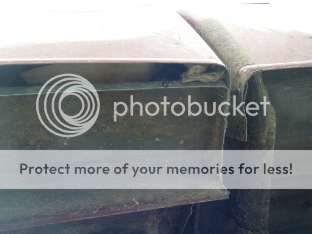

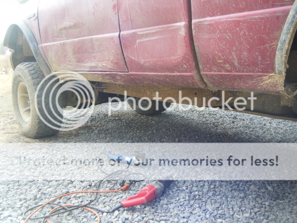

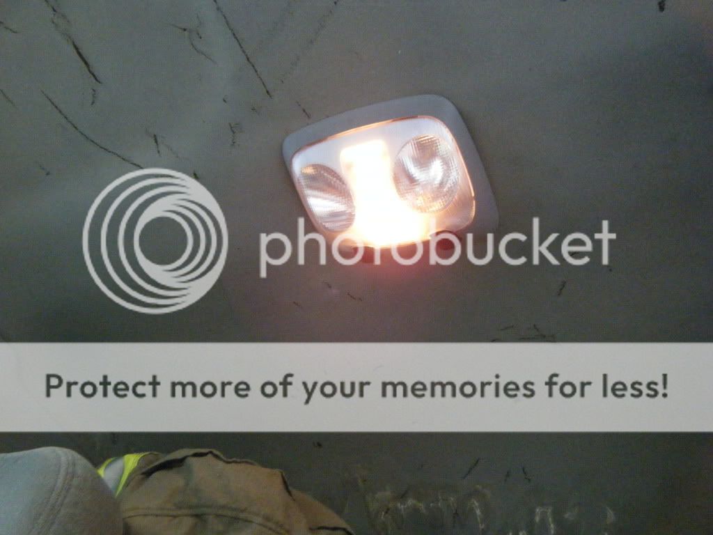

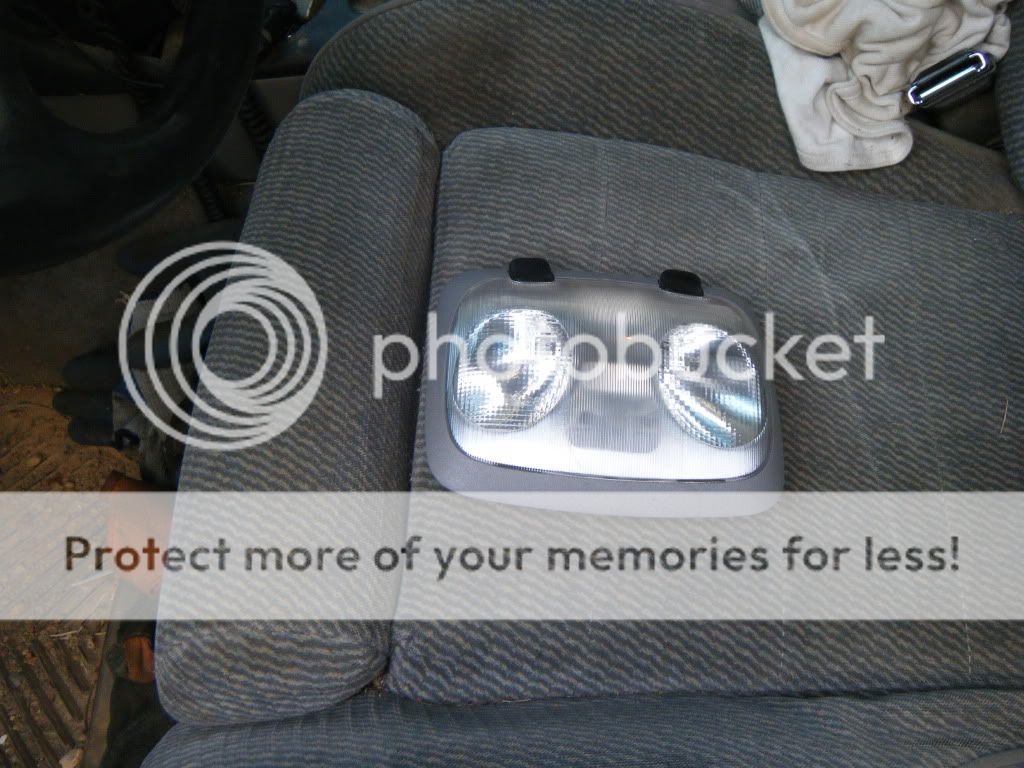

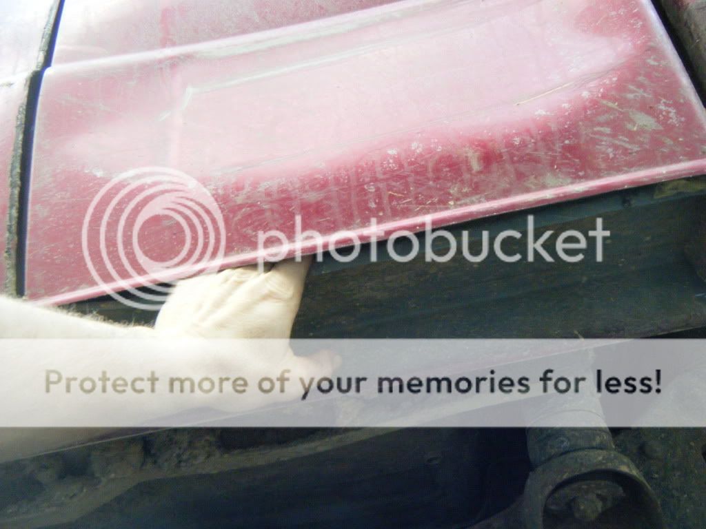

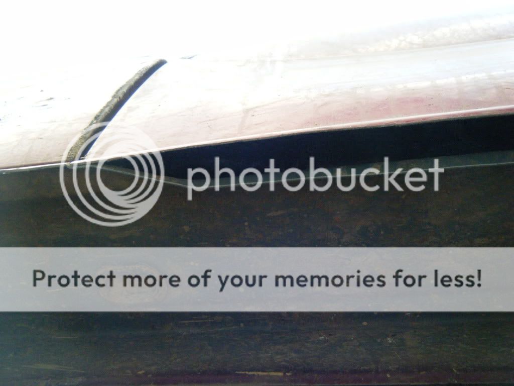

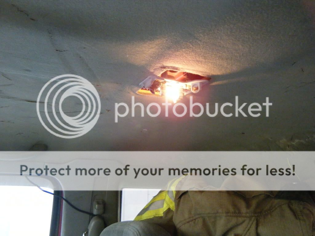

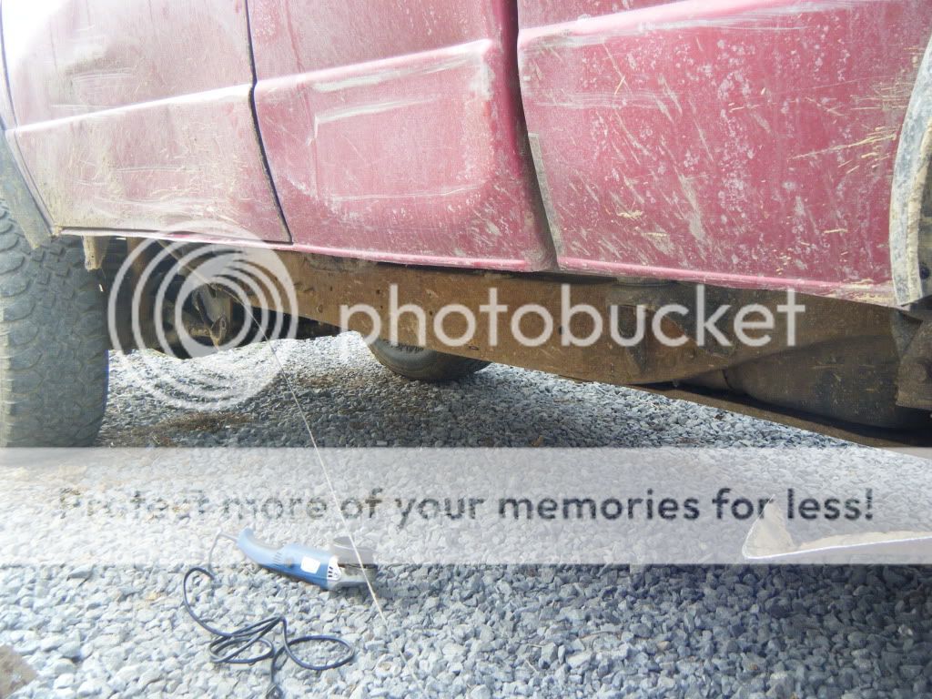

Well, didn't get a whole lot done, I had a call that spent most of my time. I was able to get my rocker panels cut on both sides, and cleaned up a little from the fenders getting trimmed. I need to fill in where the the X-cab is at the rocker panel, as it uses a separate panel to meet the rockers. Think I will use great stuff urethane spray foam for this. I also finally changed out my dome light, I've had the explorer dome light for about 6 months or more, just now got it in...

Ive used it before, it actually seals out the elements...
SVT
SVT
You serious? I've wanted to use it on the Jeep but I was quickly told The stuff holds moisture and I'd rot my panels from the inside out...:dunno:

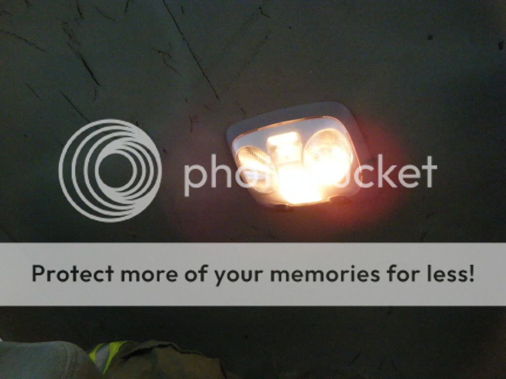

And thanks for reminding me I have a dome light to put in among other things:D Hows it light the cab up at night?
spray foam
As long as what you are foaming is clean and damp [the stuff I use recommends to mist with water to promote adhesion], the foam will adhere very well and block out water. Like anything else, prep is 90%.

Chris, I haven't tried it at night yet, but I know it will be way brighter than what I had, plus I will be swapping out the bulbs to LED bulbs soon anyways. Thinking of Red map lights and white dome lights...
AF, as long as you don't cut the foam once its cured and break the outer membrane, it will stop the moisture buildup. I have the problematic leak somewhere inside anyways, which is why my speakerbox is waterproof. I don't know if its my rear window or my 3rd brake light, but if you look in the pic with my domelight, you can see the water line on my head liner...
