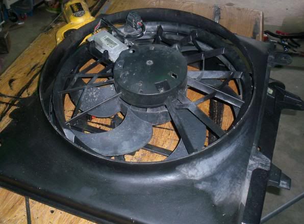

Rain yesterday but had some time in the garage to fool around with the fan. I got a 4 core aluminum radiator out of a 1999 Mountaineer that fits in the original bracket.
I kept the original elect. fan from the CV but it's too big with the shroud.

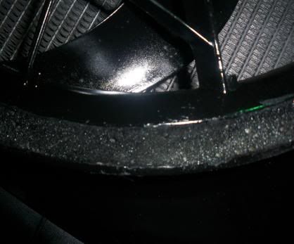

Awhile back I bought some paint at a discount outlet store, it was called Metalcast (Blue) by Duplicolor. If you've never seen or used it, it can really give you some nice effects. It looks like anodized metal when you spray it on shinny metal or aluminum.
I've used it on some other projects and really liked the look. So here's what I came up with for my 2001 Ranger aluminum rims.
I think it came out nice, when the truck is cleaned up and all the wheels done like this I think it will look good with the side pipes. Not to much, just a highlight. What do you think?

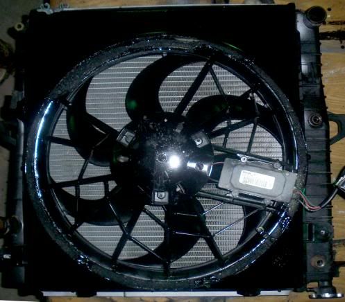

Completed the elect. fan retrofit into the 3.0 shroud today.:yahoo:
After bolting the two pieces together with the spacers I sprayed expanding foam in the gap between the fan and shroud, trimed and painted it all.
Looking GOOOOOOD!!:icon_thumby:

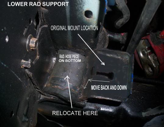

I removed the lower rad. support from the truck to give me room to slip the radiator down & behind the original support brackets. This moved the radiator forward about 2" and down about 2". It fit fine, this let the fan and shroud bolt to the original brackets on the fan and had plenty of space between harmonic balancer and fan.
I cut a piece of used rad. hose and placed it on the lower radiator bracket as seen above, the rad. support will sit on top of this piece.

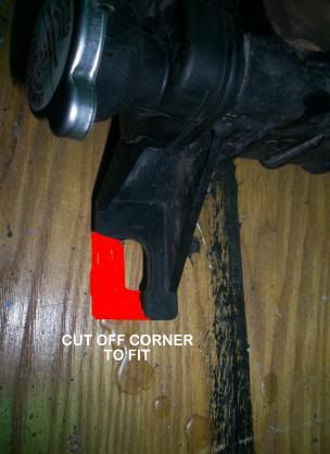

On top I had to trim the corners off the mounting ears to give it clearance under the lip of the top crossmember. I'll have to make a spacer and bolt throught the cross member.

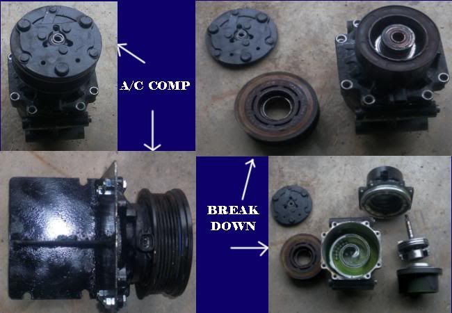

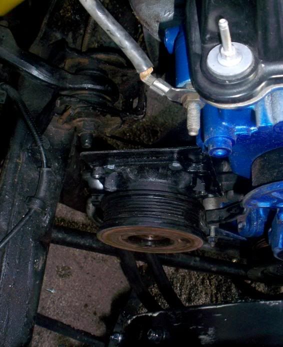

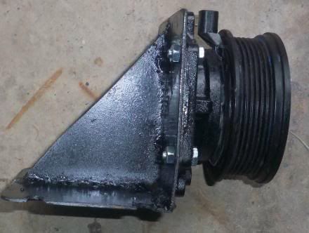

I've been researching A/C Compressor removal and what is the best way to work around it. I see that they make an a/c comp. delete bracket that is just a pulley w/ bracket to replace the compressor and still be able to use the original belt. I made the same thing using the old comp. for parts.
Remove compressor and dismantle it.
Going to use the front flange w/ it's pulley and bearing to bolt to a mounting bracket.

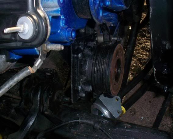

After fabricating the bracket, it will be mounted in the original location and will carry the belt.
Here is the pulley mounted back in the original position of the compressor.
Here it is installed and the radiator installed.
Thing are moving slow but we're moving ahead. Should be able to put in some good time the next couple of days.

If it isn't needed as an idler for clearance I would ditch the pulley altogether and run a shorter belt.
They have the same thing available for my Explorer 5.0 setup, ain't happening.
Thanks for your input, that's why I'm posting to this site. Someone has already done whatever your thinking about doing and it sure is nice to talk to someone with experience. I'm hoping my build thread will help someone else and encourage them to try something different.
I didn't see a way to route the belt without the pulley. I did see another thread somewhere, this guy added another pulley and then rearranged the belt routing. He still purchased and idler pulley and they're not cheap. Mine was quick and easy and best of all I saved $50 by not buying the kit.

I am working on putting together an Explorer FEAD for it right now, and while I have the timing cover off I finally snagged an HO cam to poke in it too.
I did some looking at it appears the older Mods do require a delete kit of some sort. Can't just skip the A/C compressor pulley and run a shorter belt like the old 5.0's.
