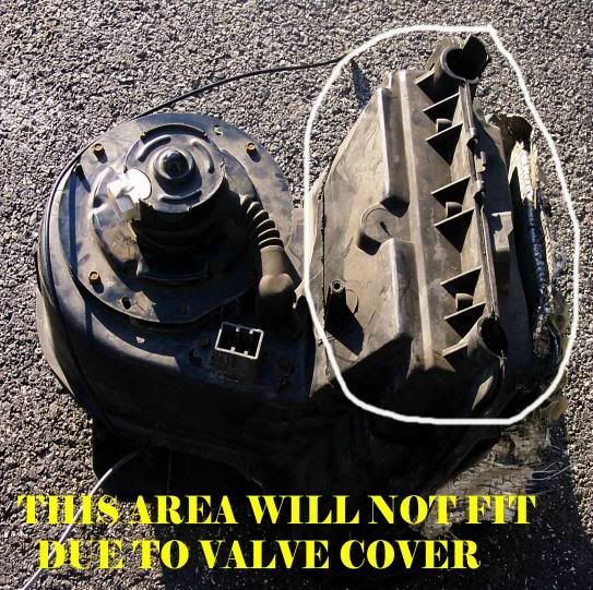

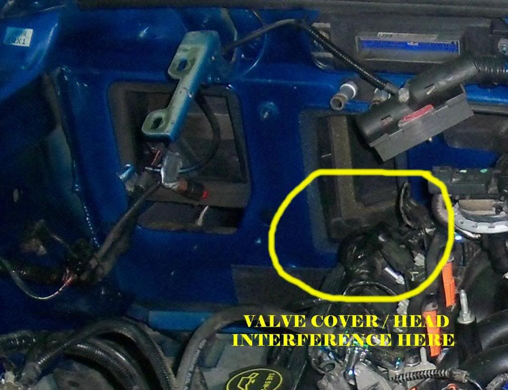

I was able to start some work on the mod to the heater box. As everyonr knows the A/C coils stick out to far to clear the passenger side head/ valve cover.
The A/C coil had to be removed and major mod done to the heater box so that it can be installed to have heat.

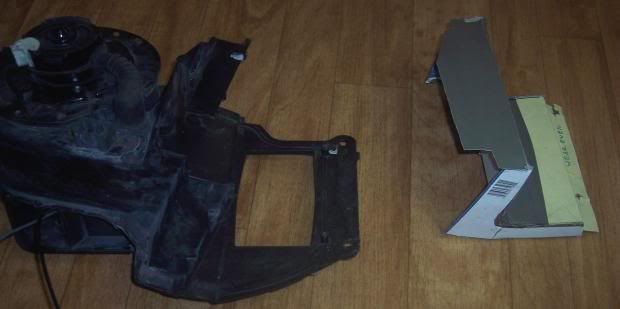

Removal of the A/C coil and cover.
I decided to make a cardboard pattern first to check fit.

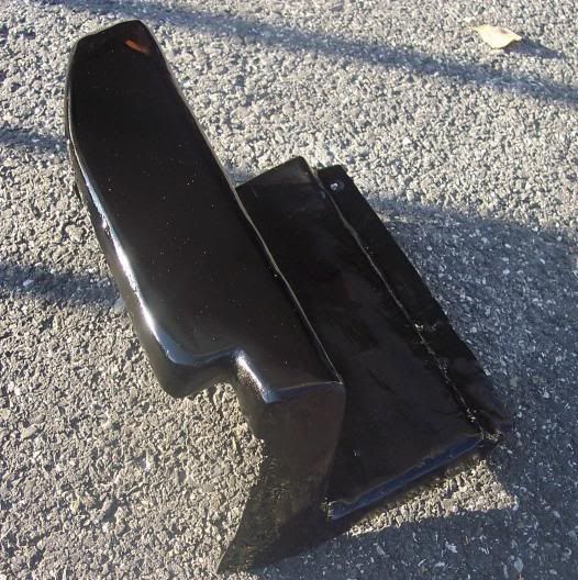

The cardboard pattern fit good so now I smeared it with grease and started to cover it with fiberglass.
Still looks a litte rough but with a little work it came out ok.
And finally a test fit
Not looking to shabby. Still have to finish up the details and attach the cover.
Attached the cover and caulked it, will have to wait for all to dry before the final fit.
