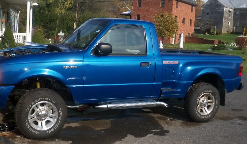

Side pipes are on !!!
:icon_welder:All right, finished the install of the side pipes and I think they look great. Can't wait to find out what they sound like. Everything was tight, hard to make those tight bends. Had to isolate the pipes from the engine so I used a short piece of flex pipe.

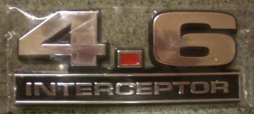

Bought a kool badge off ebay, I think it was off a Mustang police car. It's going to look good on the tailgate.

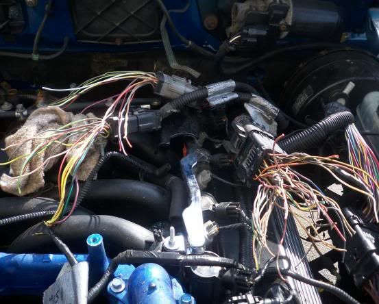

Did manage to get some time to start the engine harness wiring, it's a little intimidating at first but once I began it all started to fall into place.
Project OUTRANGEROUS 4.6L Install / Phase 2
Most of the original engine harness will not be used, the cv engine has 3 connectors that go to all the engine connections.

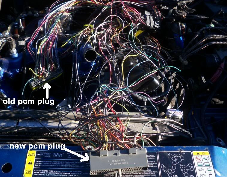

The original 3.0 harness is missing a lot of pins due to the simplicty of the engine and manual trans so I will be rewiring everything to the new pcm connector. I did manage to get both male and female connectors from the donor car. This makes the wiring alot easier. It looks like a rats nest here but it will all clean up nice.Managed to get 40 wires connected today.

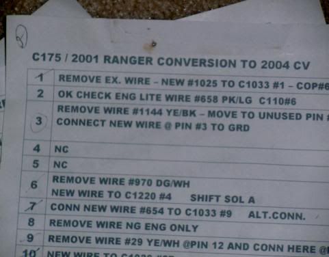

Here is my wiring schedule I made up to make the switch and get everything right. This schedule was made comparing the 2001 wiring to the 2004 wiring.
