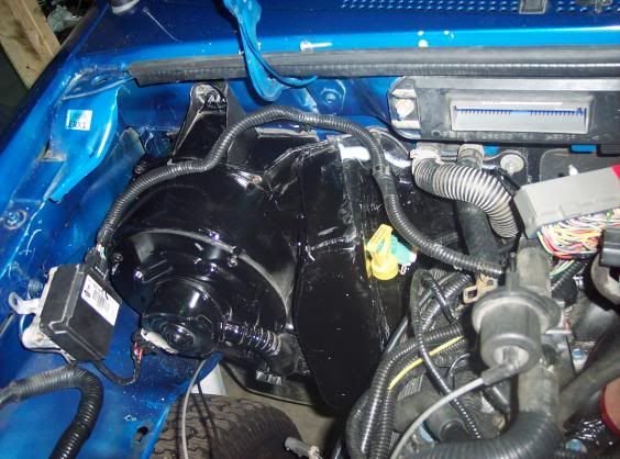

Well I got a little time today and installed the heater box. It fit great :yahoo:
As an added bonus it even had enough clearance on the inside corner of the valve cover to install the transmission dipstick.
Another item checked off the list

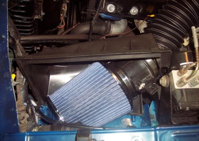

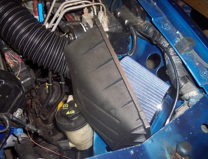

Cold air intake

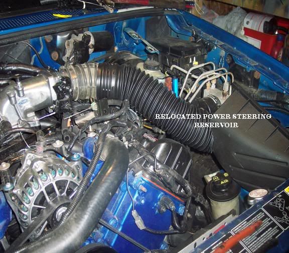

The throttle body intake on this engine faces the drivers side but there was no room for the air intake and filter box. I moved the battery over to the front passenger side and freed up that area but the CV air tube would not fit.

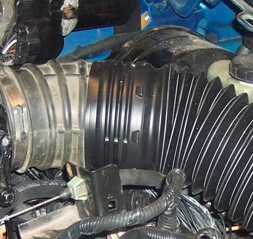

After much trying and testing I think I came up with a good installation. I searched the web for some ideas and found some guys being very creative and using some very unusual equipment. I looked at some speed shop parts for the intake and new air filters and found out quickly how expensive these units are. I didn't see anything that would fit my application without some mods so I decided to try and create my own out of available materials. A quick trip to Lowes plumbing dept. and I had a bag full of possibilities.:icon_rofl: I had the original 3.0 snorkel and air filter box but the diameter was too small however the connector fitting at the throttle body fit good and made approx a 60 degree turn which aimed it in the correct direction.
I cut the fitting just beyond the turn in the tube, I had purchased a piece of 3" flexible drainage pipe at Lowe's that would expand from 12" to 24", it also had a metal spring inside to keep it from collapsing. The flex tube kind of screwed onto the ribs of the rubber fitting on the throttle body so tightly that no type of adhesive was needed.:yahoo: It was a great fit and this flex tube would now get me down to the new filter area.
I bought a Specter 3" conical air filter. I cut the CV MAFS out of the plastic tubing being careful to save enough material on each end for hose clamps. Now the flex tubing will clamp on one end of the MAFS and the filter on the other end.

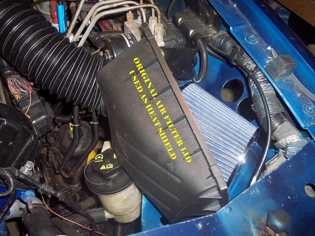

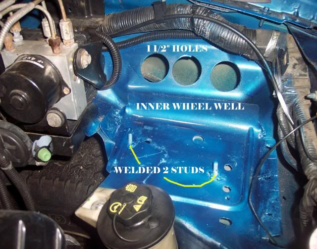

I cut 3 - 1 1/2" holes into the inner wheel well to permit some cooler fresh air in.
The air intake area will still be behind the plastic inner wheel wells so area should not be exposed to the elements. I welded a couple of studs in to mount the shield, the plastic is flexible enough to bend back to clean and change the filter element.
I took the CV plastic air filter box top and mounted it as a heat shield behind the filter to try and encourage more air input from cooler outside air.:icon_confused: We'll see???
Not sure how well the flex tubing will hold up under the hood ???
All in alll I think it came out ok.

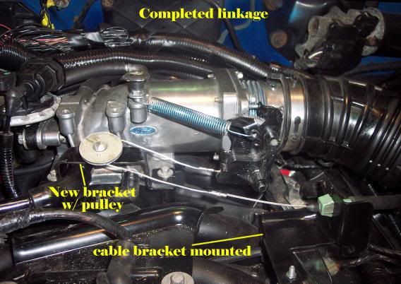

Throttle linkage
Pulling the lose ends together on this build, the accelerator cable pulls in one direction and the throttle plate pulls the other so something had to connect the two.:icon_confused:

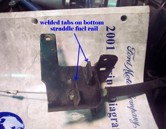

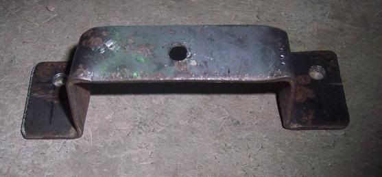

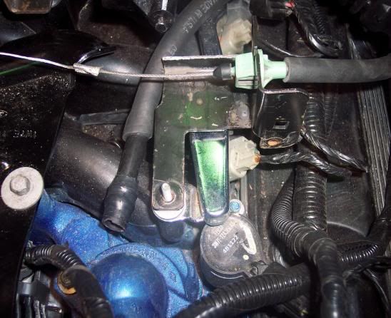

The original cable bracket looked like I could adapt it and bolt it down over the left side fuel rail.
There was already a stud available to bolt it down all I did was weld a couple of tabs underneath the bracket that straddled the fuel rail.
Just put it in place and bolt it down.:yahoo:

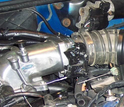

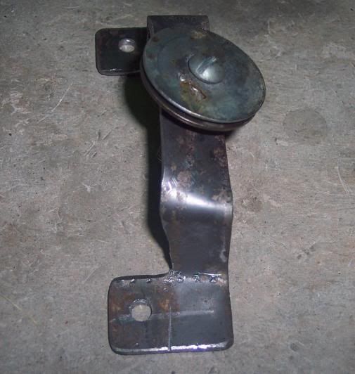

Now for the other end, I used the two bolts that hold down the throttle body and made a bracket to hold a homemade pulley which will hold the throttle cable and reverse its pull.:icon_confused:.
I used a piece of 1.5" x 8" x .125" flat stock. and bent it up to fit.
I made up a pulley out of 1/4" fender washers with a flat washer in the center, these three washers were soldered together and put a 1/4" bolt through the middle.
After test fitting it all I had to do was paint it up and bolted it on.
It worked nice and free. Should do the trick !!!
