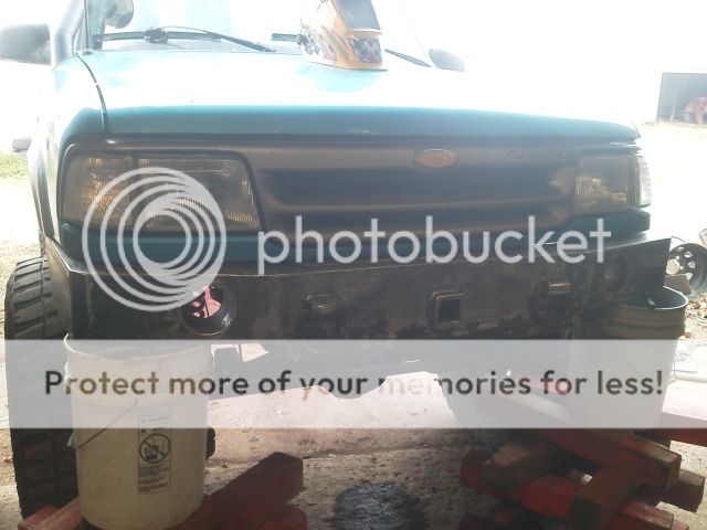

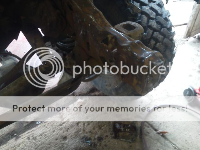

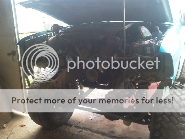

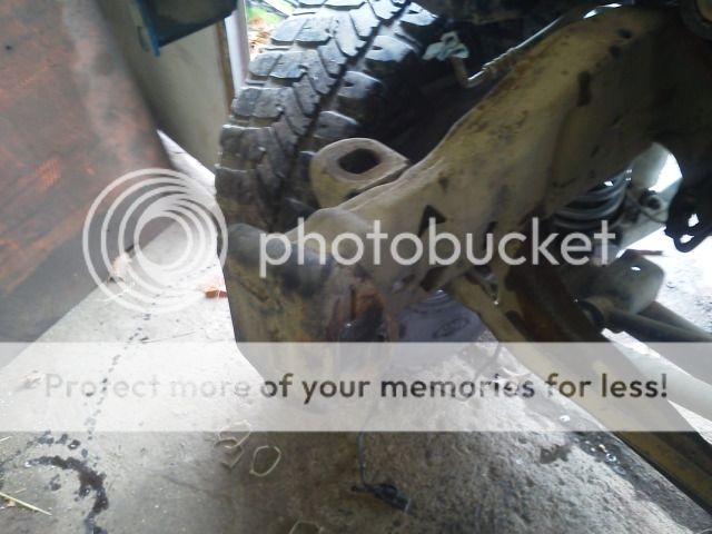

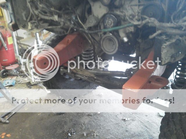

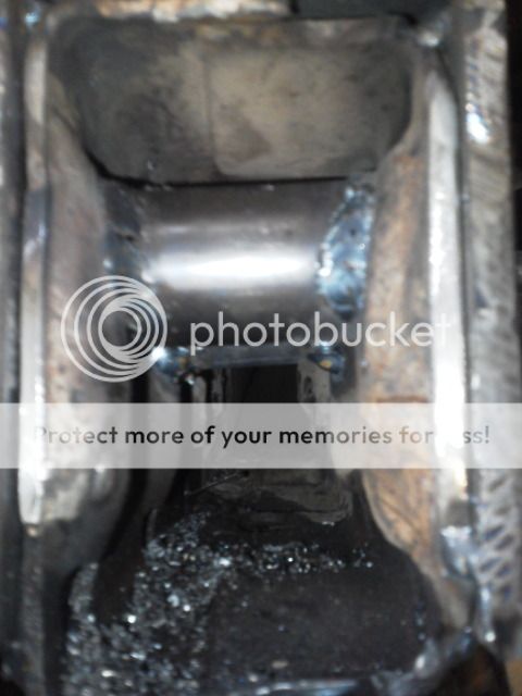

I took my bumper off to trim/straighten/reinforce. I plan on adding a winch some time on a receiver, but I dont trust the accordion crumple zone frame rails in the Gen III.

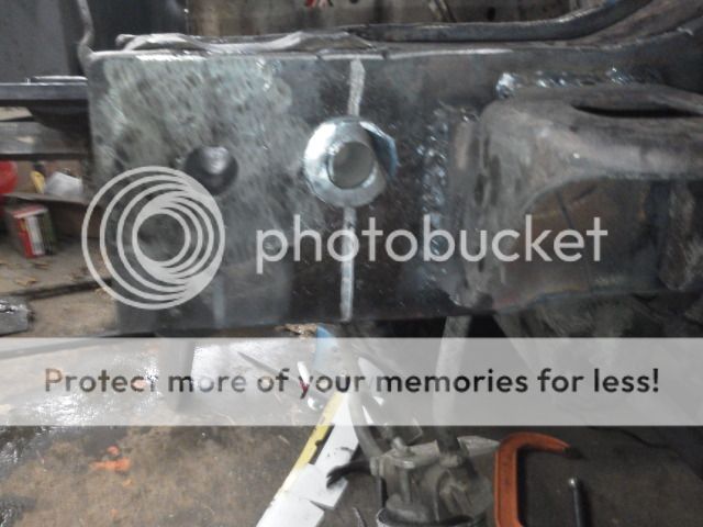

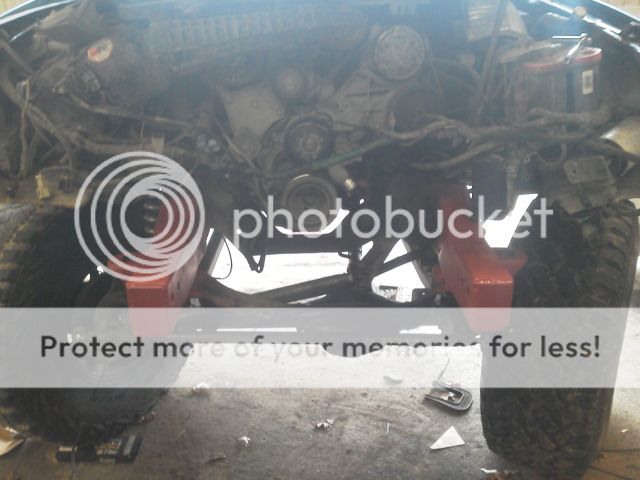

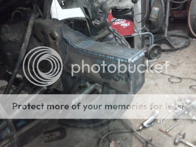

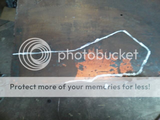

Decided to pull the core support and radiator off and plate both sides and the top of both frame horns.
PlumCrazy's Build
PlumCrazy's Build
PlumCrazy's Build
PlumCrazy's Build
Used 1/4" plate

I also drilled and sleeved two 3/4" holes on each side to mount up the bumper with new brackets.

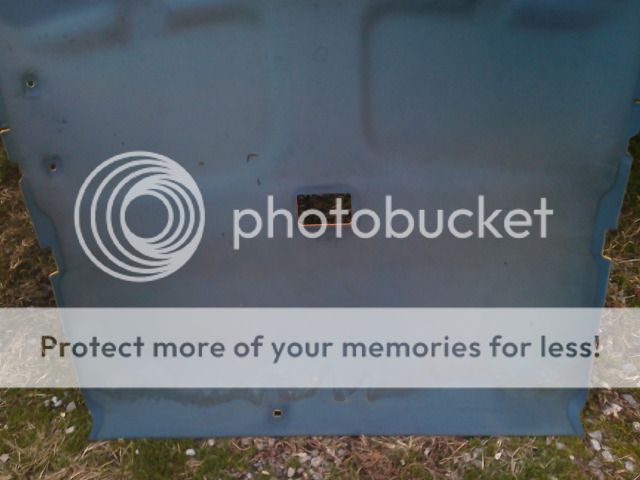

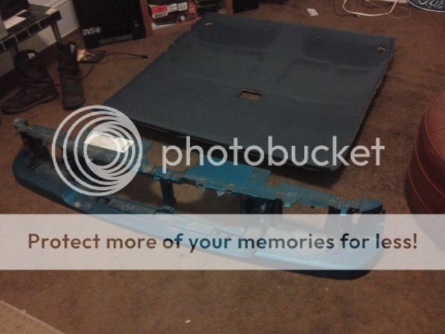

I also scored a mint blue super cab headliner. Which may not seem hard to find, but most blue interior trucks were single cab XLs. Took 5 years to find it. And they are a bitch to get out of a truck with windshield in.lol
PlumCrazy's Build
Also got the new header panel in Lapis blue from the same truck. Since mine has a small crack I figured why not. Only payed 10 bucks for both.

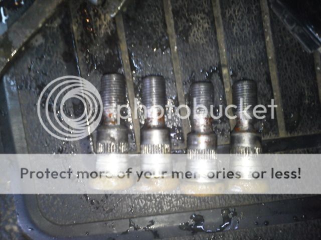

About an hour into my 2hr trip to parents house the front end started growling and shaking. I was doing 70mph or so and I figured a wheel bearing was going so I pulled over to check it out.
Found that 3 lugnuts were missing and the last two were on by a few threads. Last time the wheel was off was 500 miles ago and tightened up with a breaker bar? All the other wheels were tight.
So anyways. I trashed my rim, lug studs were worn to almost nothing. My buddy bought my spare and i replaced the studs on the side of the freeway at night in the freezing rain.

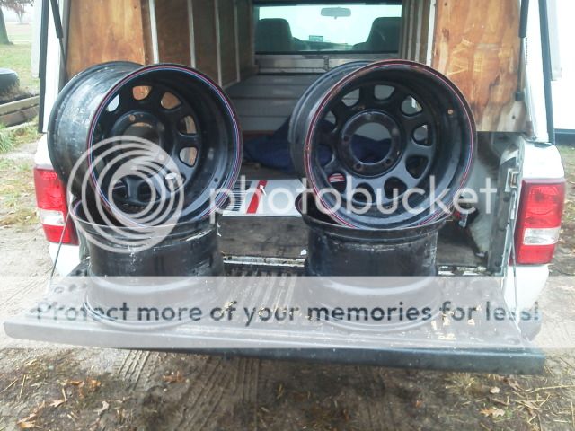

Picked up a set of rims for 80 bucks. Perfect timing.lol. I am using one to replace my junk one, and another for a second spare. The other two may end up with boggers or something.lol

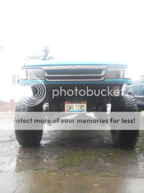

It looks so tall without the bumper.lol

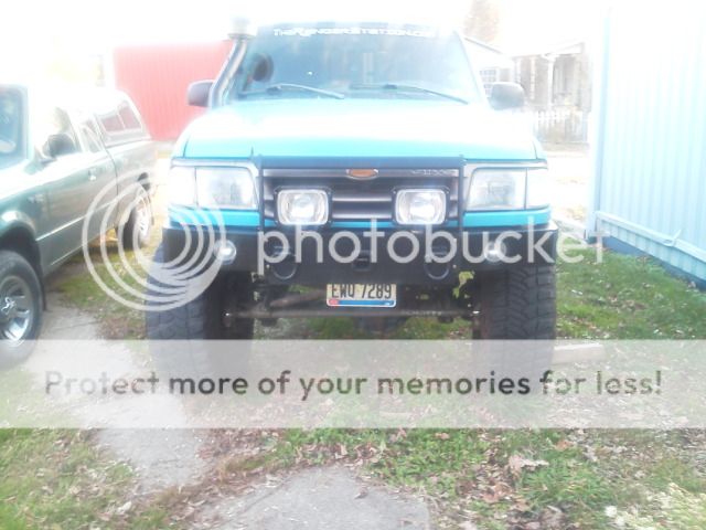

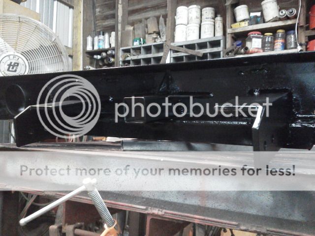

Got my bumper straightened out finally. With enough heating and beating and a come-a-long its almost perfect.
PlumCrazy's Build

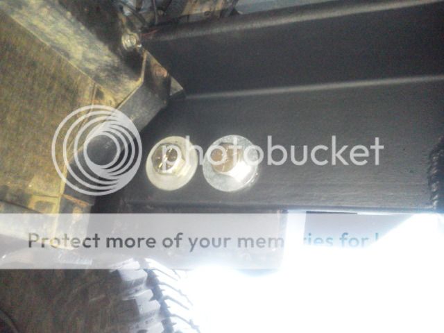

I also remade the mounts to bolt up to the new frame rails. I used 1/2" thick 4x3 angle this time and bolted it to the frame with 5/8 grade 8 bolts. Should be pretty solid.lol

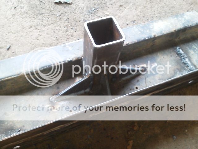

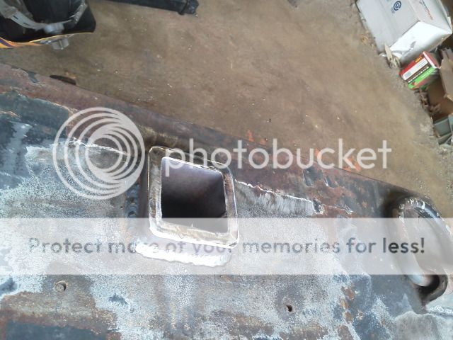

I decided to add a receiver while the bumper was off. I gusseted the shit out of it. Plan is to use it for a winch, so I wanted it to be stout.
PlumCrazy's Build
PlumCrazy's Build
Sorry they are upside down.lol

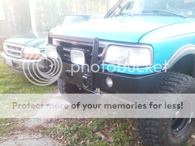

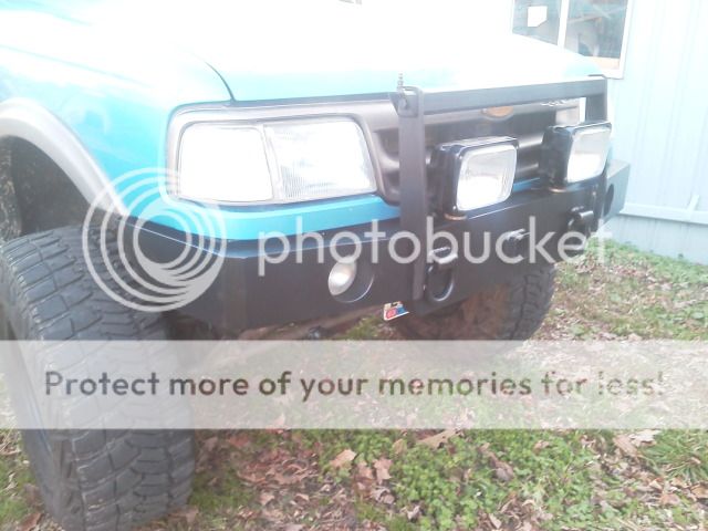

Bumper is done. Pulled it off and slung paint. Bolted up lights too.
PlumCrazy's Build
PlumCrazy's Build
PlumCrazy's Build
5/8" Grade 8s

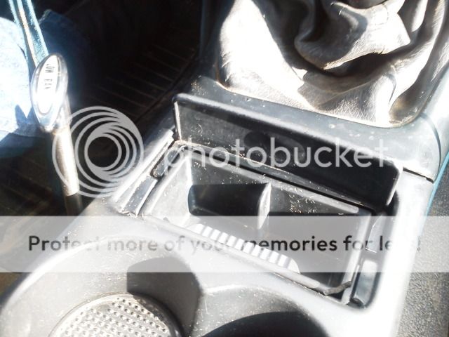

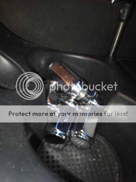

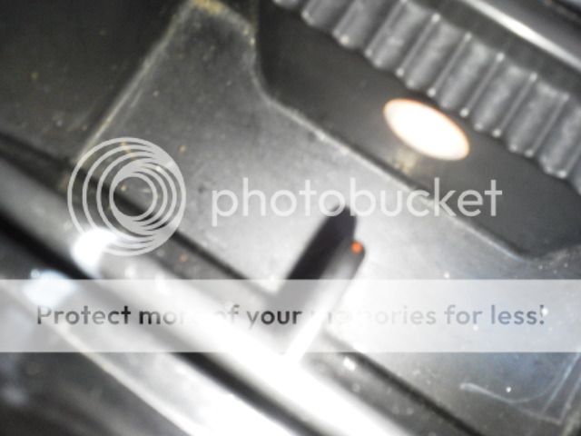

Swapped my cupholder portion of my console out for one out of a Eddie Bower with the lighted ashtray.
I threw and Amber bulb in and pulled power from the old unused 4x4 switch plug.

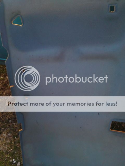

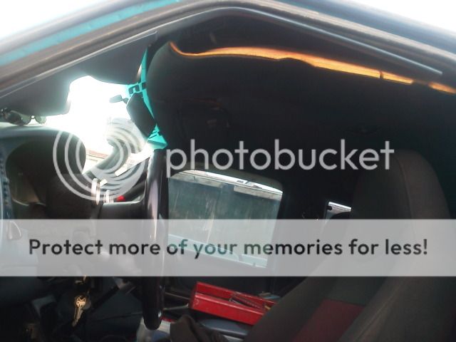

Decided to swap out the headliner the other day...
What a pain in the ass. 2 door Super Cab headliners are a pain to do with the dash out, let alone with a dash in. I had to take out the center console the passenger seat, the pain in the ass rear plastics that are held in with a million xmas tree popper things.
I should have dropped the column too, but it was late and I wanted it done.lol. Its easy to get loose in side the cab, but sneaking it out the door without bending it blows. It is physically larger than the door opening.
Here is the old one. Pretty nasty and ripped. I sealed up my leaky third brake light too. Thats what made the last one so gross.

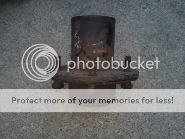

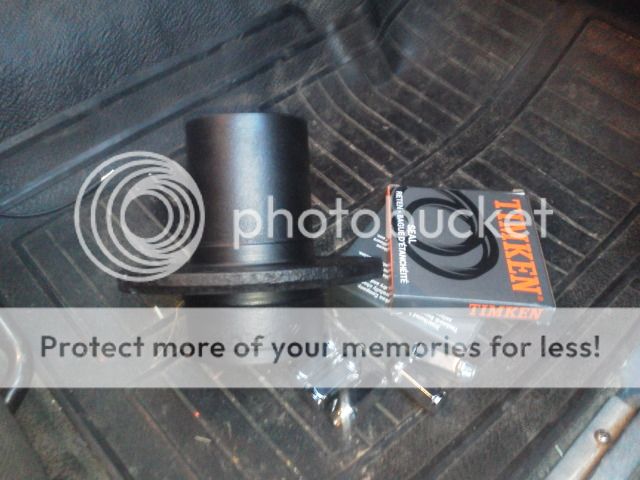

My hub showed up today. Thanks 1BadExplorer.
When I trashed my rim it wore just enough out of the hub that the new studs dont quite press in.

Also got new lugs that match the rest (except t''hey still have chrome and are shiny)
