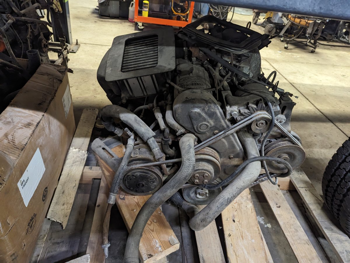

Snagged a some 2.3T stuff a few weeks ago. Two complete long blocks w/ turbo , three 2.3T short blocls and heads, freshly built stock turbo and manifold and a bunch more junk.
Plan is to drop one of the long blocks in my 88 SuperCab and toss a PIMPx at it.

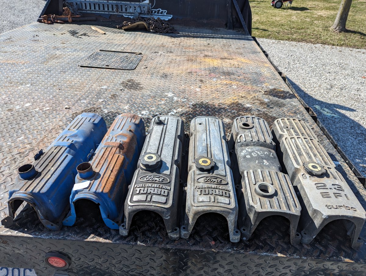

Want to sell one of those "Fuel Injection Turbo" valve covers? Want to do a turbo build in the 85 when I start working on it. Would love to find one of those style valve covers for it.

$125 Shipped for a turbo valve cover

Awesome! Price sounds good to me. I'll PM you later for more info on paying and shipping. It'll probably be a bit before I can start working on it, but I'm hoping that truck will end up similar to your first gen except regular cab long bed. Maybe a little closer to Perry's height though.

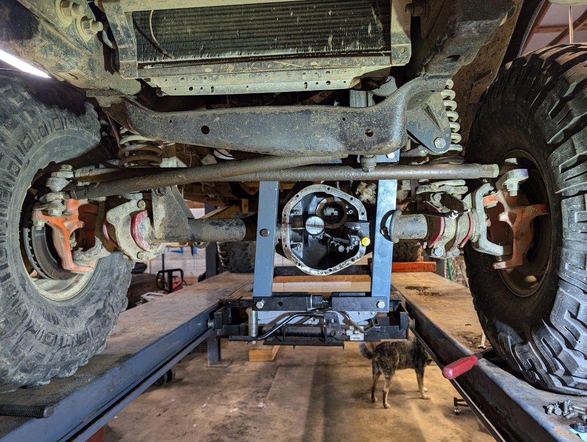

Right off the trailer I had some noise in the front axle....figured it was a CV joint and sent it. It never caused an issue, just clicked when turning in 4x4.

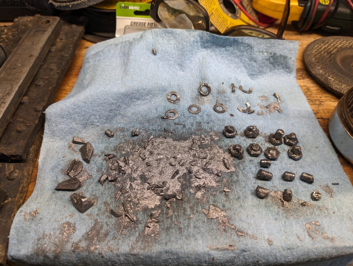

Pulled the cover for the first time in nearly 10 years to find this. Bolts backed out of the locker, ate up the bearing cap and went through the ring/pinion.

Talked with OX on the phone a bit and found that it was common issue on the original design Dana lockers. They have since upped the bolt size and added a retaining ring to keep the bolts in.
I can get all the parts to repair/update my current unit for less than 1/4 cost of a new one at least. I can't complain, this D44 has seen some D60 level abuse for years.

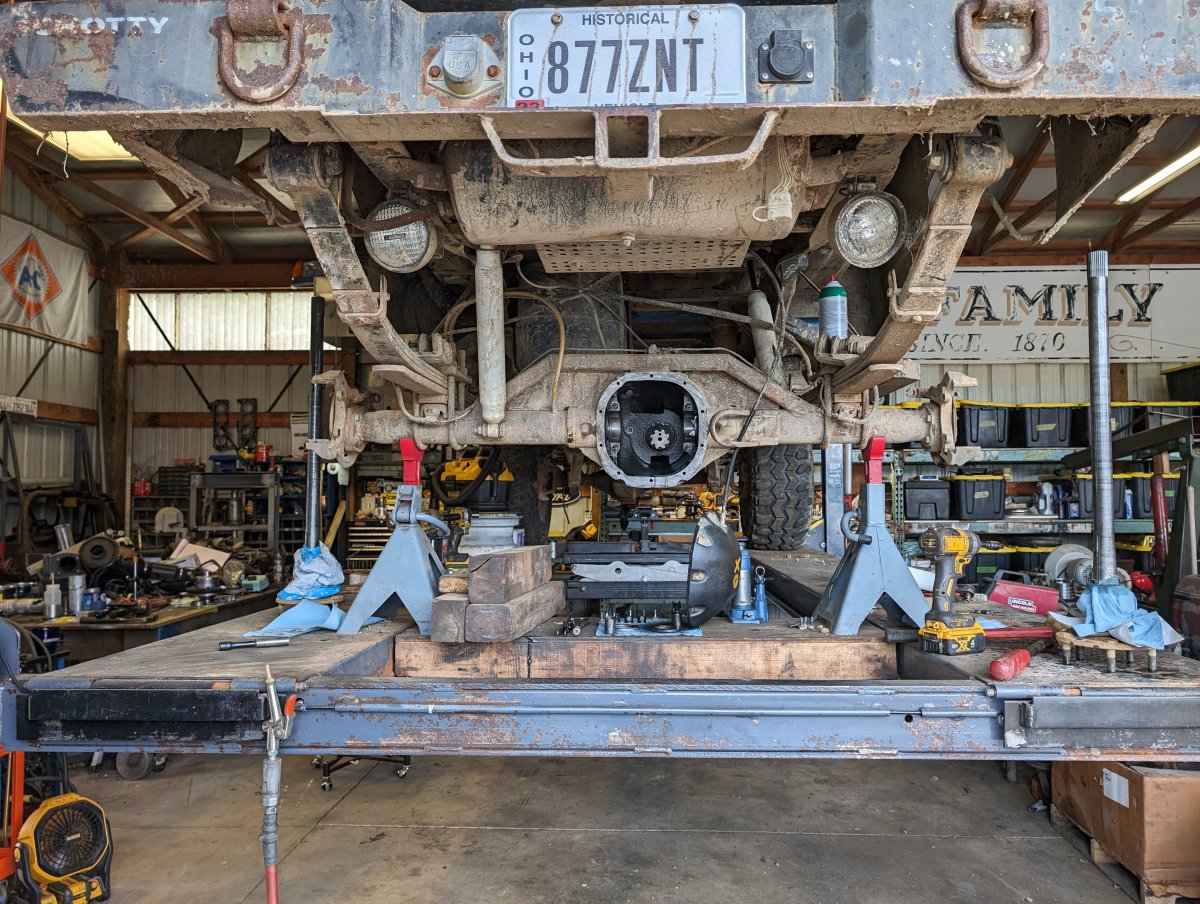

Got the 4x4 back together finally.... Ended up doing ball joints, front brake pads, ring and pinion, locker housing, repacked the wheel bearings and CVs and picked up a set of well used 38.5s to get the truck back in the woods for now. Haven't really serviced anything in the front or rear axle in like 8 years, so it was due.
New locker housing has bigger bolts and a retaining ring.

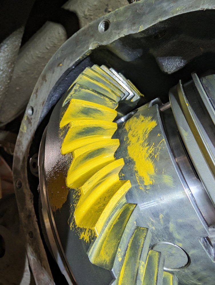

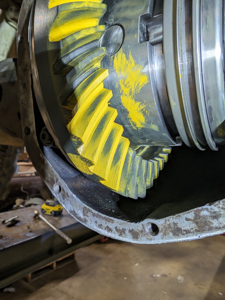

Setup gears. Pattern was good enough for this thing.

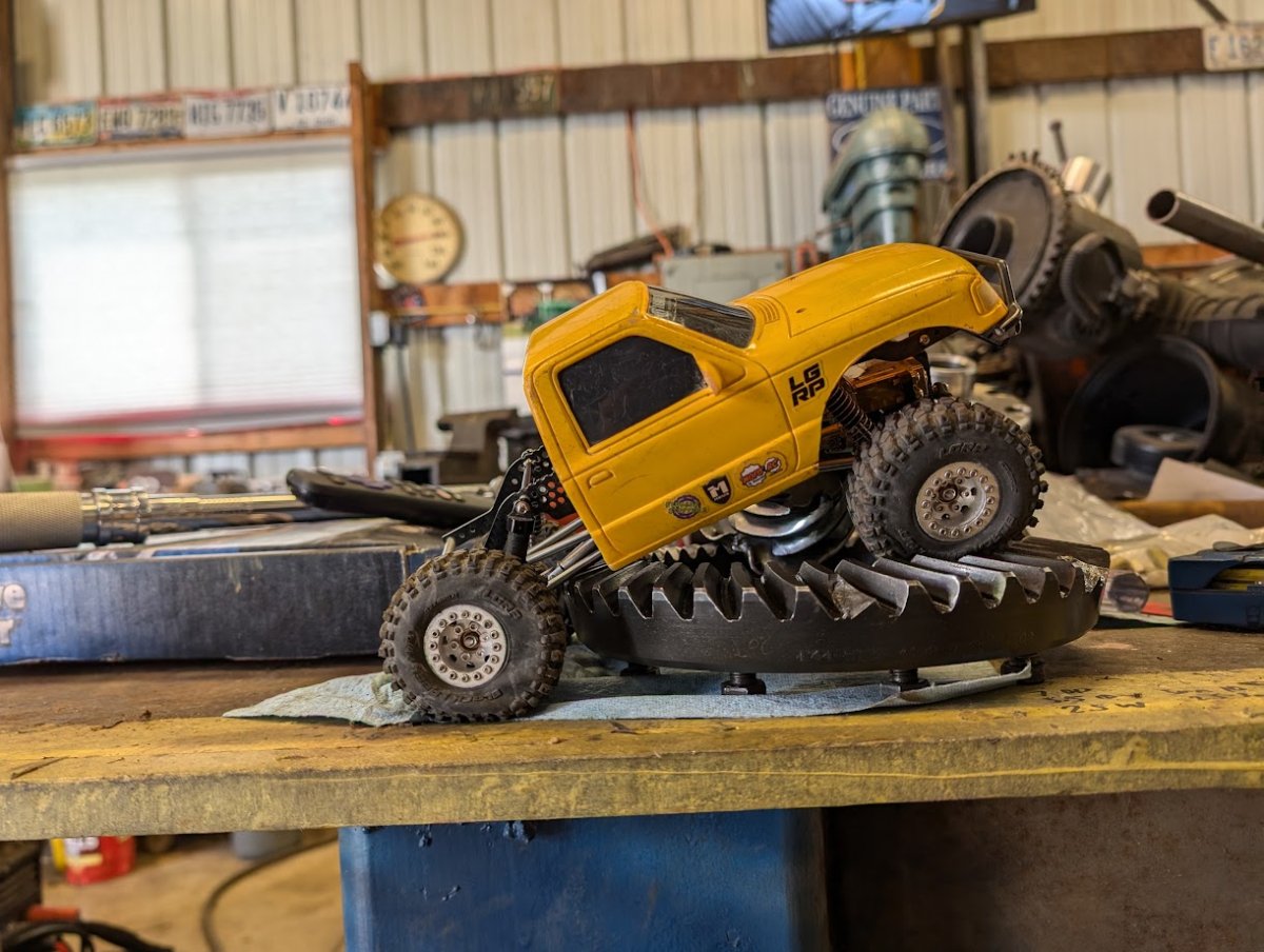

The Little Guy got new links and high steer.....still working on getting a bed designed and printed for it.

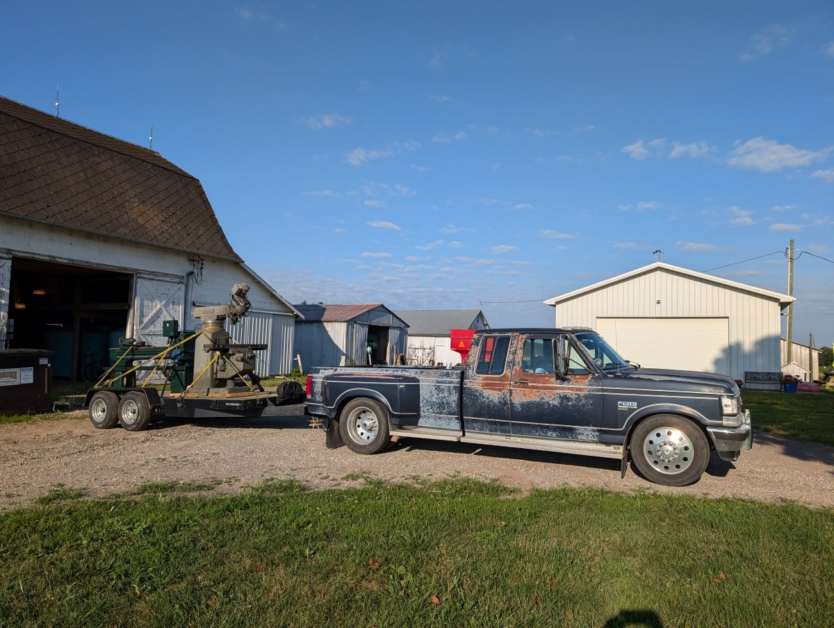

The tow rig has been doing tow rig things.
Everything from logging to moving a machine shop.

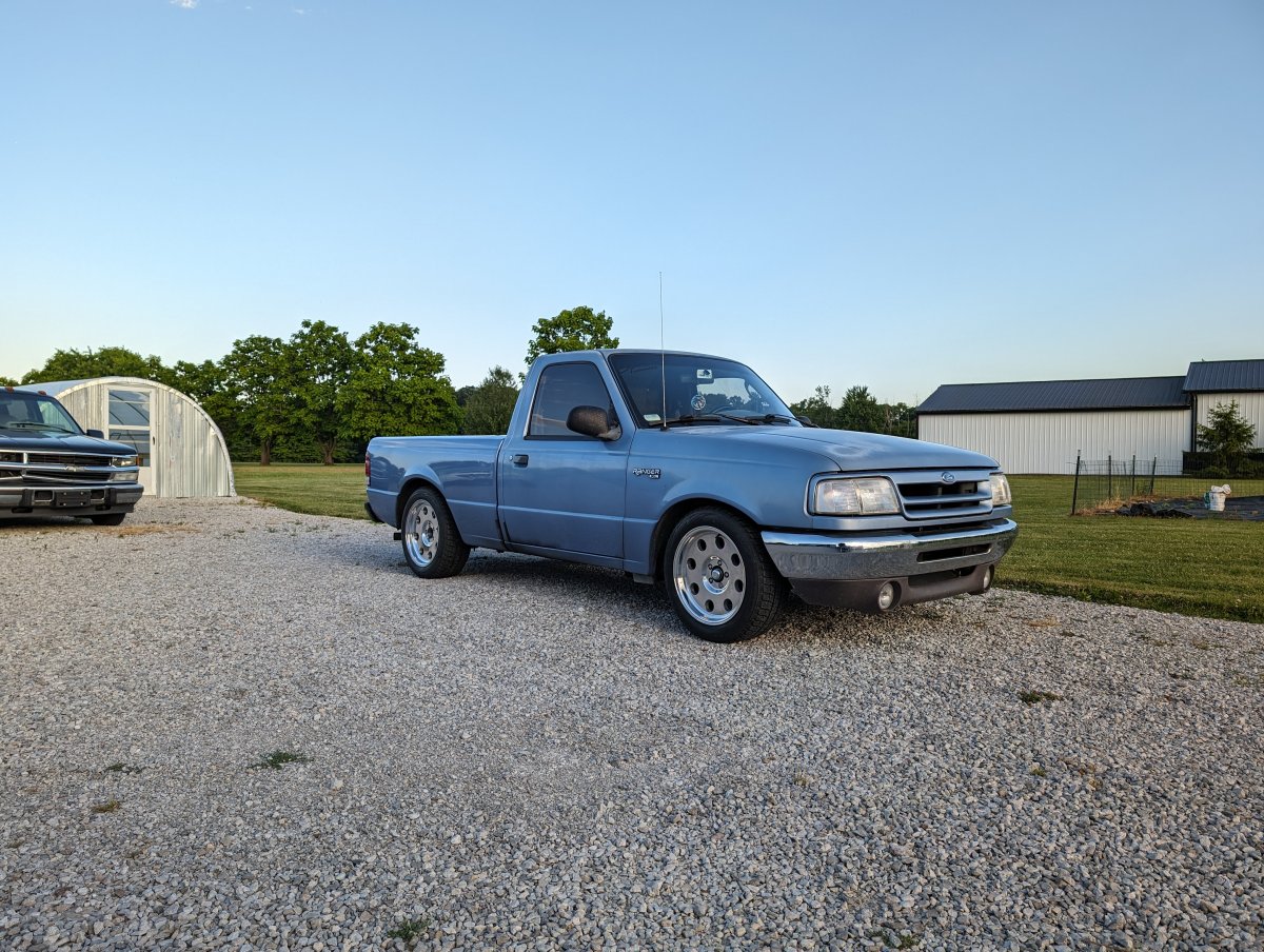

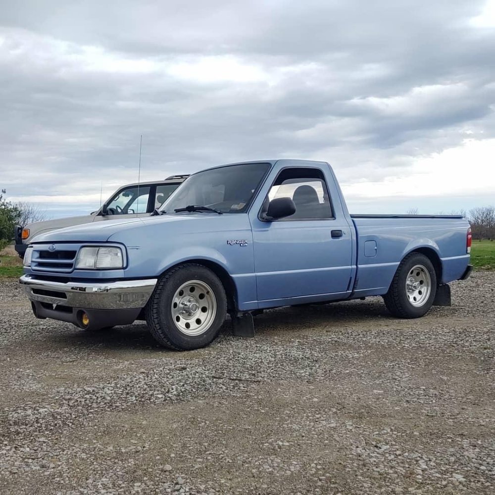

And the 5.0 Ranger has officially passed 12k miles since the swap. No swap related issues to date. Been racking up miles since it has the coldest AC in the fleet.
Dude I'm digging that blue ranger. There's a reg cab ranger in mint shape close to my work Im thinking about doing the same thing too. And its already the same colour as my other ranger.
Cheers bro.
Cheers bro.

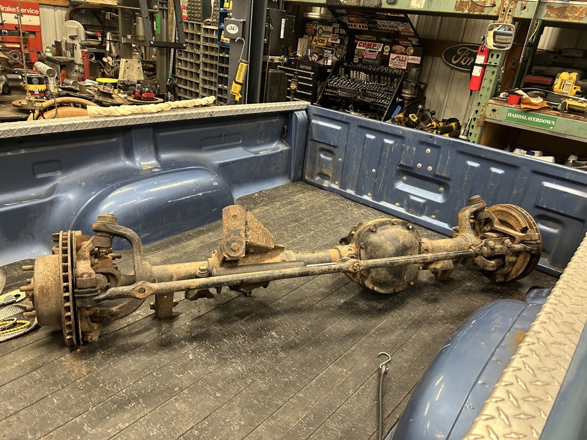

Thanks man! I have started down the path of another SAS truck now too.....Picked up a YJ D30 for the little black truck.
