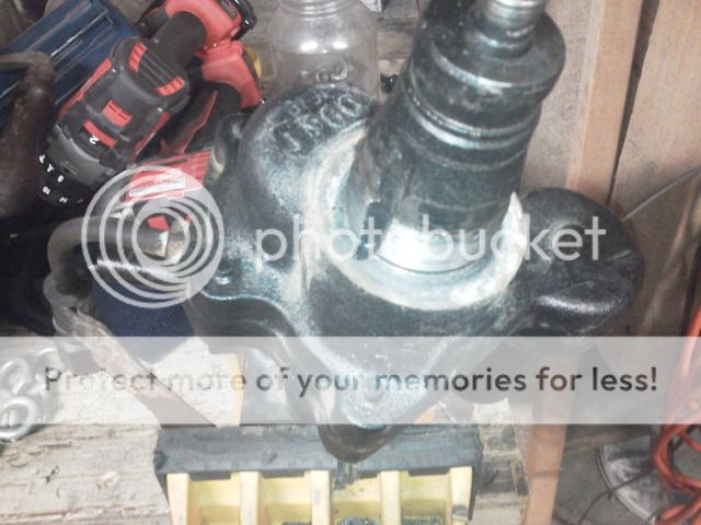

I still need a hub for the pass side.lol Mine has a chip missing where the lockout o ring is supposed to seal. I have always just RTVed it, but I would like to fix it someday.

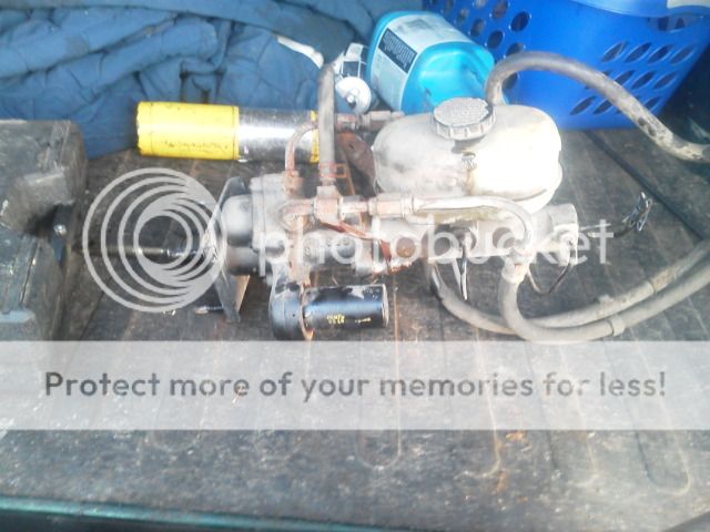

Got hydroboost?
I picked up the whole setup for 35 bucks. I want to keep my 1.25" master though, I think the 1.38" that is on it is way to big. Still have to do some measuring and figure out what lines to order. I pulled it from a 98 Super Duty and it had oring swivel on the box and a the newer oring fitting on the pump.

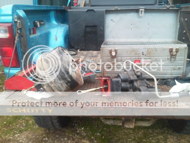

Did a little tinkering with the hydroboost last night. Looks like the RBV master will bolt right up to it as well as the 94 1ton master I am currently running.
I read about a lot of people saying the OBS master wouldn't fit on a newer Super Duty HB unit, but they were also "diesel" people. No offense to all the diesel guys on here. But a lot of guys think if it doesn't bolt right on or plug right in it won't work.lol.
Looks like late 80's F-SuperDuty pressure lines will be the ticket. I will need to shorten the pedal pushrod about 2" and remake the mounting plate since the 4 studs are spaced different.
Also looks like the pushrod coming out of the HB is .125" too long and not adjustable, so my plan is to cut it shorter and drill/tap the end for an adjustable set screw.

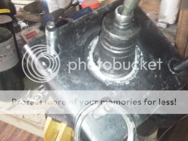

This little guy showed up yesterday.
I figured out how I'm doing the HB mount and pedal pushrod. I knocked the nut loose on the mount and pulled it off. Plan is to make one that A. Pushes it 2.375" forward, and B. Fits the Ranger bolt pattern. By pushing it forward I wont have to shorten the pedal pushrod. I wasn't real crazy about having a welded joint being the only thing between having brakes and not having brakes.lol

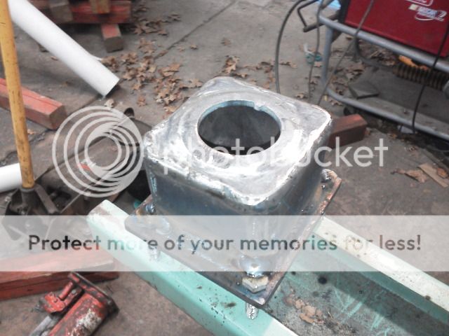

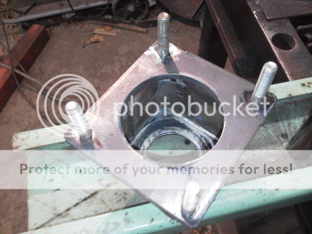

Made up my hydroboost mount/bracket.
It moves the HB forward 2.375" so the stock Super Duty push rod works. Unfortunately I will have to re run my brake lines.

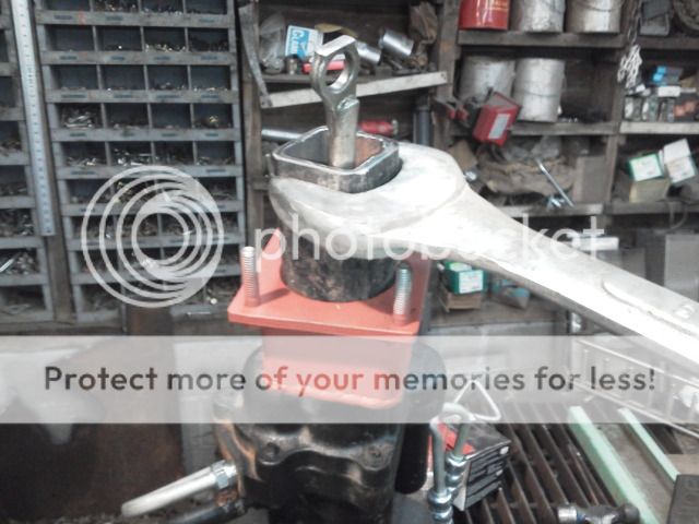

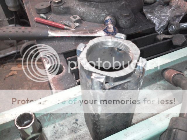

I made a socket to remove/install the mounting nut since it is recessed down in my bracket now.
Lines will work perfect I believe.
I was concerned that the 98 HB would have metric fittings and I wouldnt be able to find a standard line with metric on the HB end and the old oring style for the Saginaw on the pump end, but it turned out they have the same thread as the 88-89 F-SD I ordered the lines for.

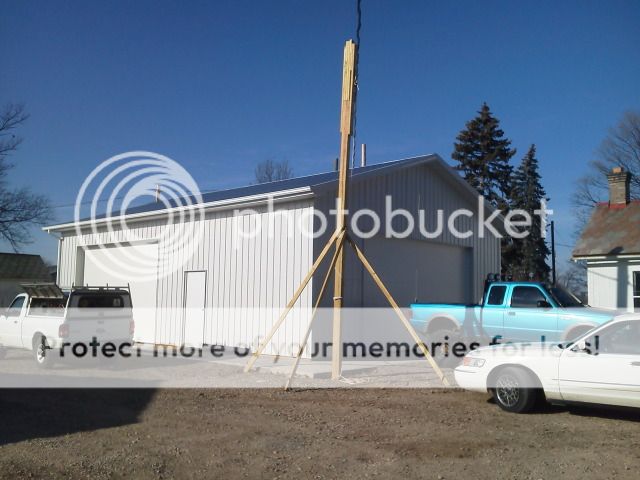

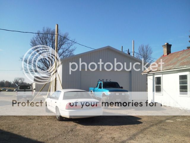

And a few pics of the new shop going up at my parents farm. Spent my thanksgiving running drainage tile for the down spouts and floor drains.
16' ceiling, 18' doors, 2 post lift, polished concrete, heat, running water too bad its 2 hrs away.
I see myself "visiting" more often.
I built my truck half outside less than 20ft from there.....why couldn't my dad have done this sooner.lol

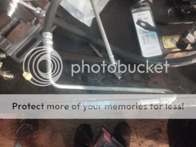

Pics.

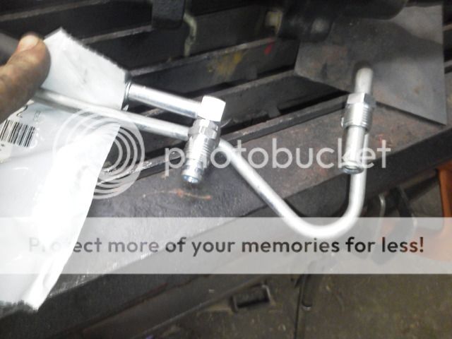

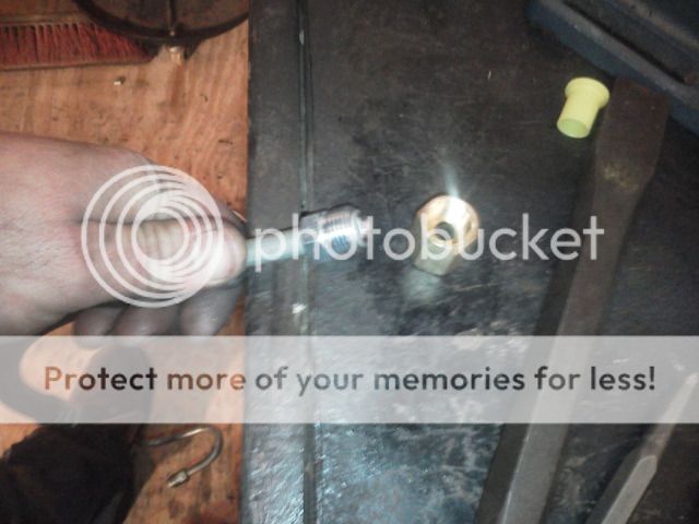

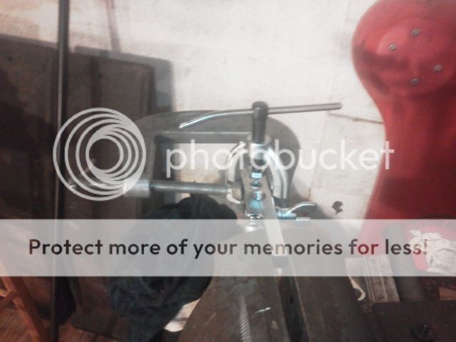

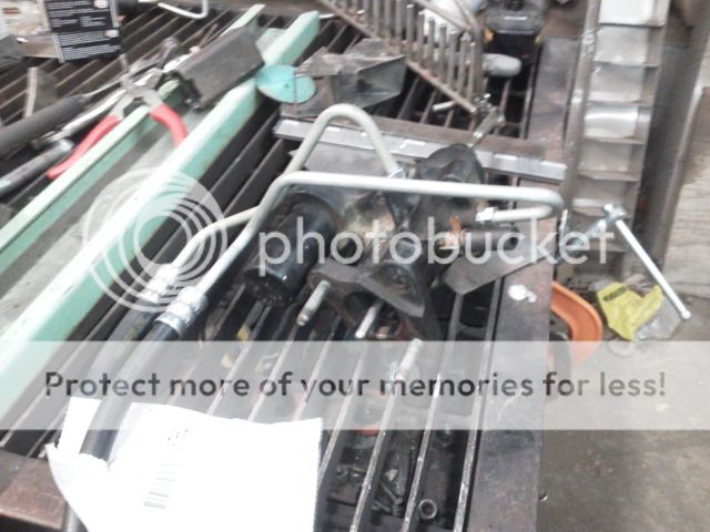

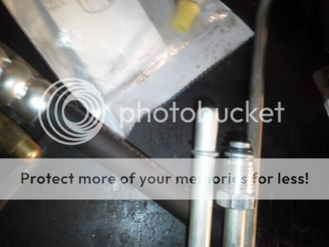

I chopped the tubing portion off the HB to box line and flared it so I can bend another piece of tubing how I needed.
My flaring tool needed some help getting a grip on the tube.lol
I had trouble finding a piece of tube with the end I needed.
I found a fuel line repair kit with the correct rib crimped in, just had to trim the "nose" shorter.

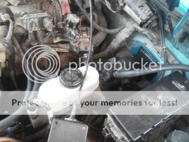

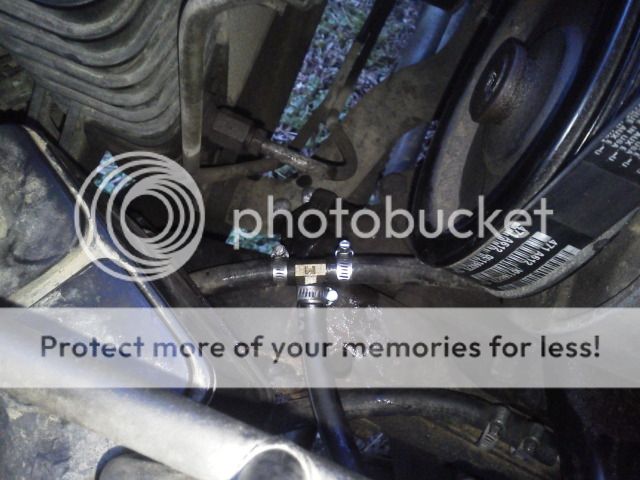

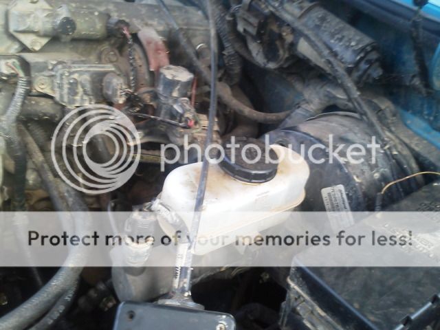

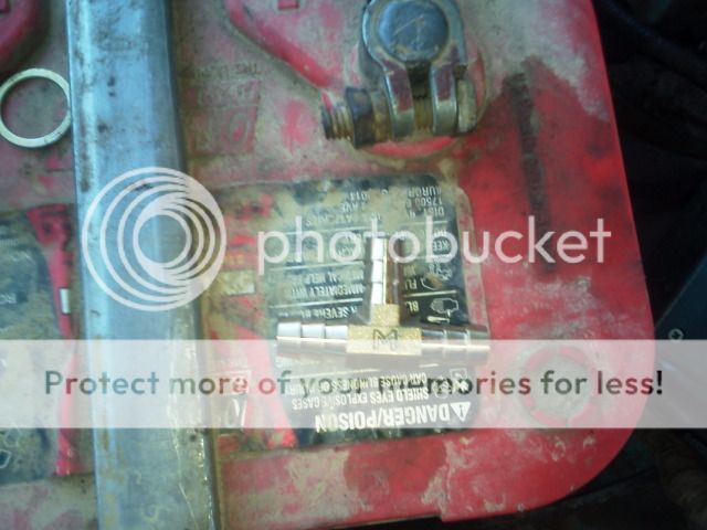

I threw a tee in the return line for the HB.

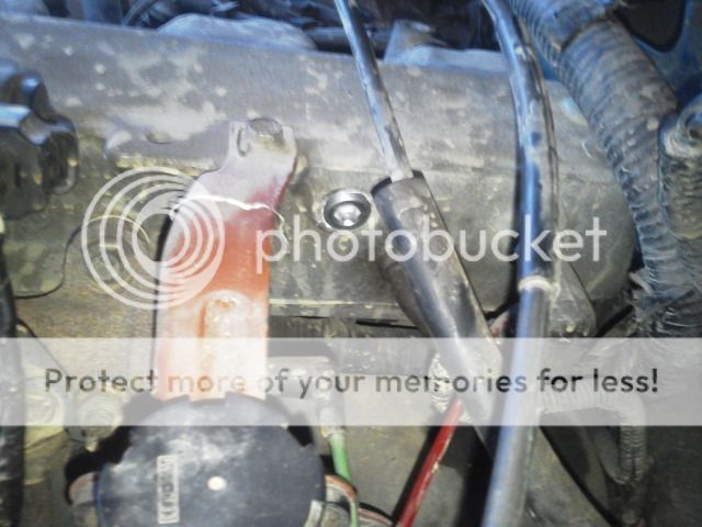

Plugged the intake where the booster vacuum line was.
More to come tomorrow when I get tube bent.
