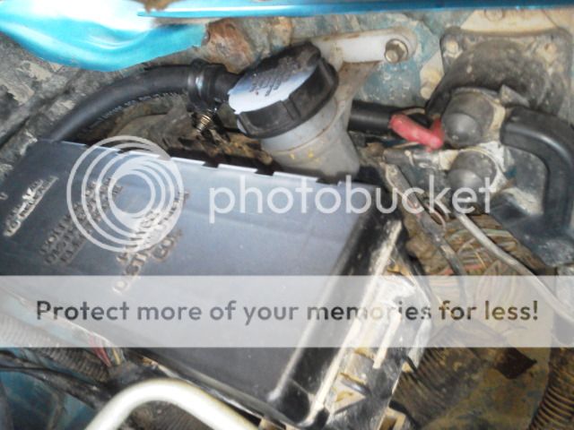

Hydroboost complete.

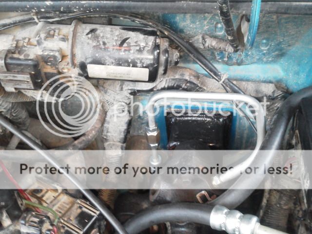

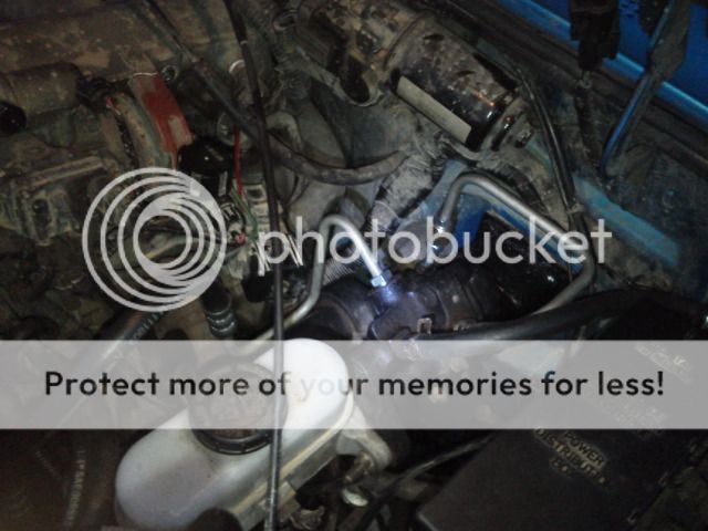

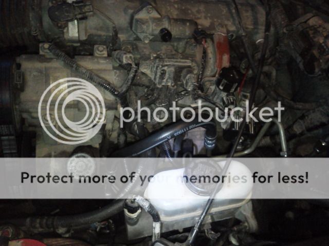

Bit the bullet a bought a nice tubing bender for 3/8. Ended up bringing home three more bags of tools....damn black Friday pricing.lol
I was able tweak the existing tube on the pump to HB line.
PlumCrazy's Build
I bent up a new piece entirely for the HB to gear tube.
PlumCrazy's Build
Put to clamps on the return line.
PlumCrazy's Build
Night and day difference. Definitely worth it. Now my brakes in my 99 feel so inadequate.lol.
-PlumCrazy
Looks like it was factory-made/assembled!
Thank you sir.

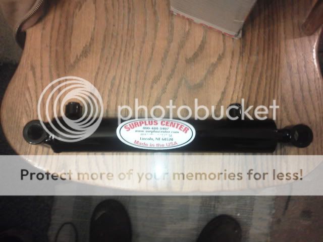

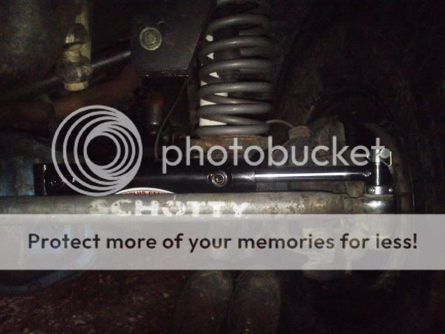

Also my steering cylinder should be here today.

UPS man showed up.
PlumCrazy's Build
-PlumCrazy

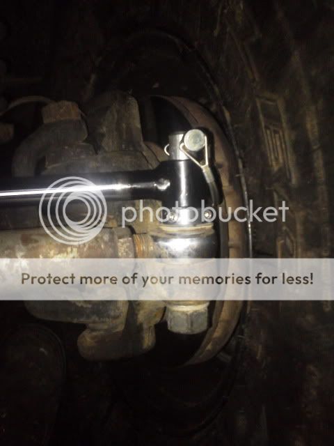

Has 3/4" ID ends. Plan is to add grease fittings. I am putting quick disconnects on the hoses and using removable pins on the mounts. I want it removable for a few reasons, A it will allow me to still have fast acting steering on the street, B keep the cyl out of road salt and what not, C save wear and tear on the pins/cylinder eyes.
https://www.surpluscenter.com/item.asp?item=9-4410-08&catname=hydraulic
I did some test fitting last night, it should work. Plan is to build a mount off the diff cover and the rod end will bolt up with the tierod on the knuckle.
-PlumCrazy

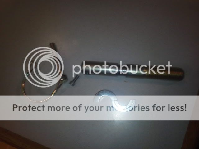

Made up my rod end mount last night.
I took a long Grade 8 3/4" bolt a cut the head off, then I trimmed down a groove to 5/8" for a split collar to clamp around it. Then i popped a hole through it for the pin.

I wanted to use a lift arm pin from a tractor, but they only come in 5/8 and 7/8.
The head end of the cylinder will be attached to a mount built off the diff cover via removable 3/4" pin.

I plan on running hard line off of the box to bulkheads with the quick disconnects on the frame rail beside the trackbar mount. That way they will be easy ti get to and take the strain off the fittings on the box.

I have been thinking of different ways to go it over the last week, I settled in this one for now. I would really like to find a.one piece stud to use though. Like this but 3/4"
http://ecx.images-amazon.com/images/I/31WxiNjkXJL._SL500_AA300_.jpg
But I have searched for 3 weeks with no luck. I need 2" of pin above the shoulder and 2.5" under with threads. Apparently they do not exist in 3/4"
-PlumCrazy
So are you going to upgrade the pump?
