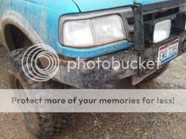

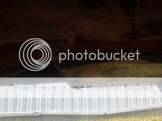

Also found out that need to clearance my bumper a little more. My tire caught it pretty bad when i stuffed it.lol. I twisted it up and nearly blew a tire.

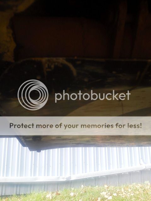

Skid plate did its job and it shows.lol
I wish I had a vid of the launch that stood the truck up on the back bumper and smashed in the skid.lol

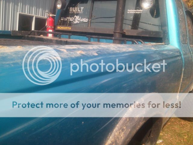

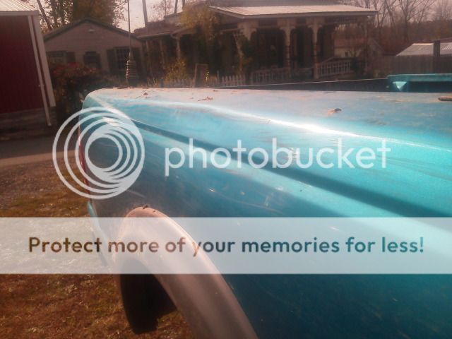

Also scratched the bed a little more.
We all took a little body damage, but I'm pretty sure Sampson took home the most.
