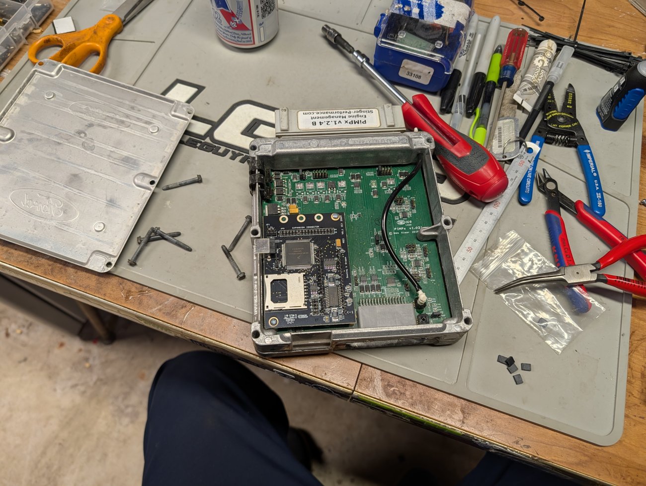

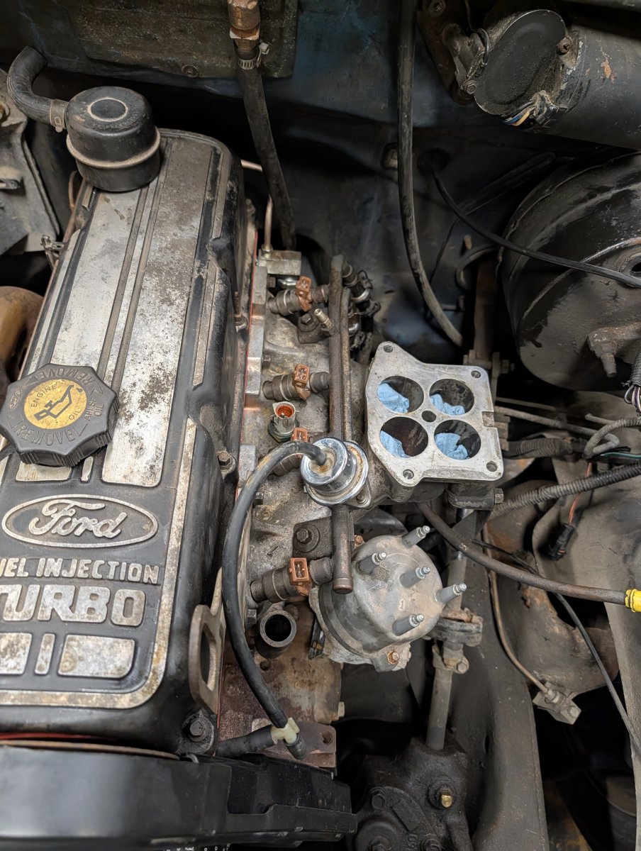

PiMPx can run low impedance, but XS and XShift cannnot.I'd double check the pimpx can run the low impedance injectors. Most of the MS lineup won't run them without additional resistors (and even then it's not optimal). It's possible Stinger added that functionality however. My PimpXShift did NOT have that capability.
As far as tuning goes, you are much better off biting the injector bullet at the beginning.
