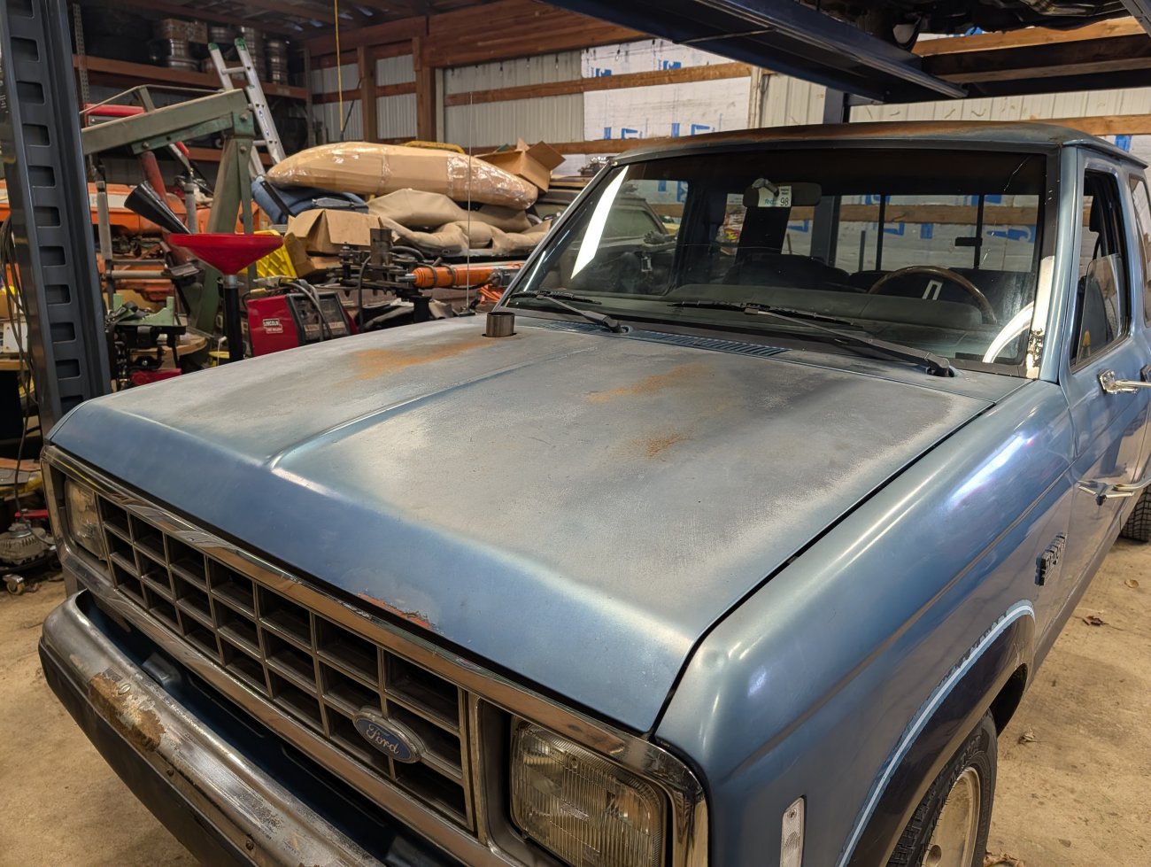

I plan to cut the pipe down to whatever the tallest it can be and still have a functioning hood with only a 3” hole. I’d rather not do a bolt on hood stack…but I may.
Probably a stupid question, but why not go down?

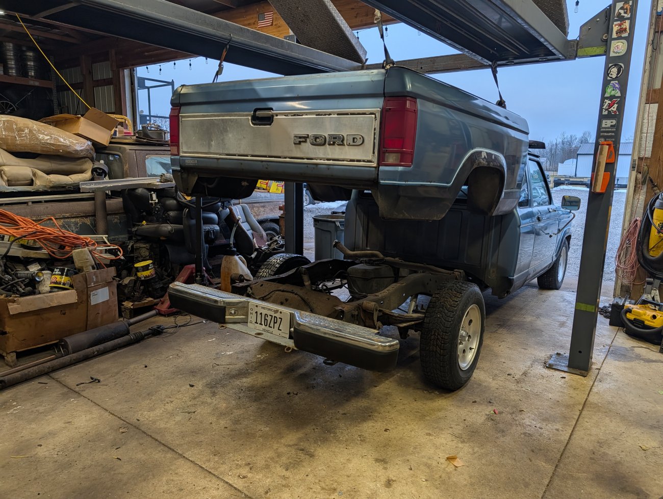

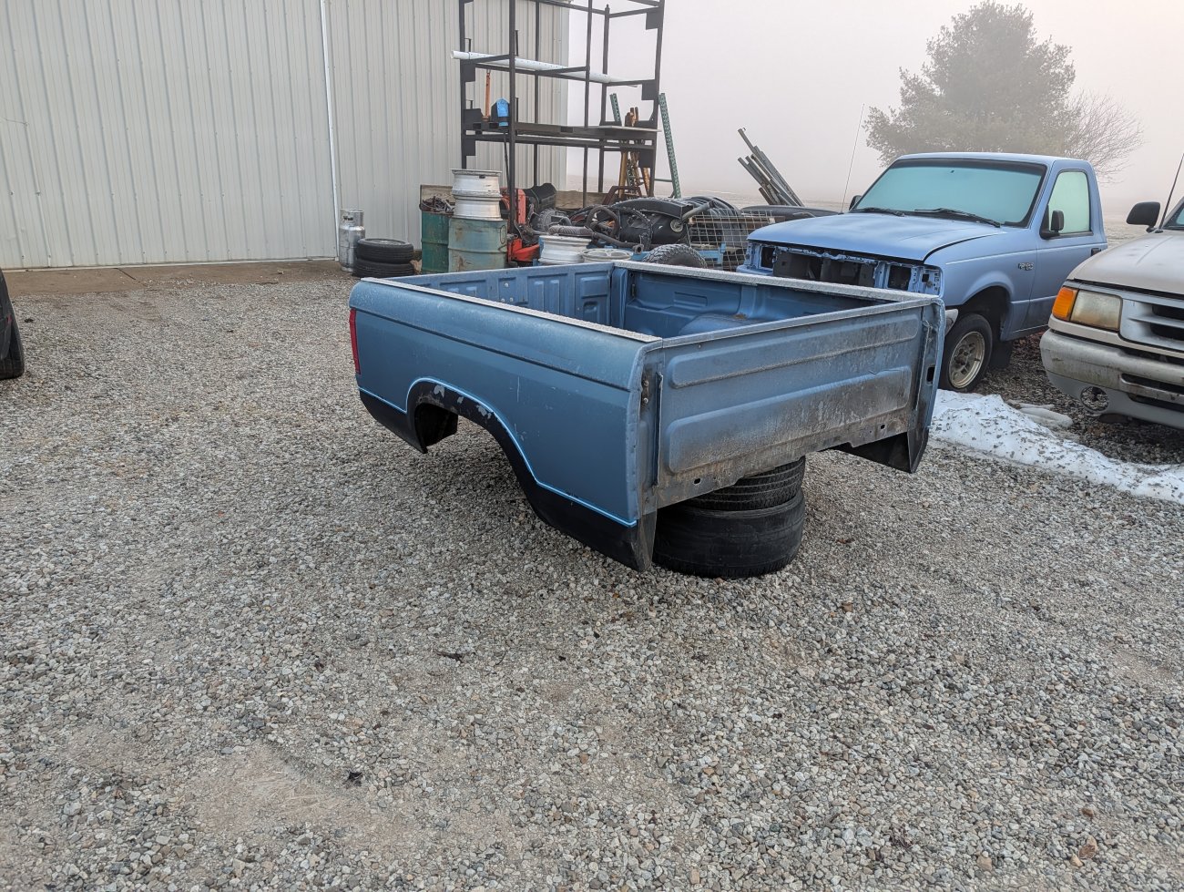

Got the bed yoinked off.
Set it aside

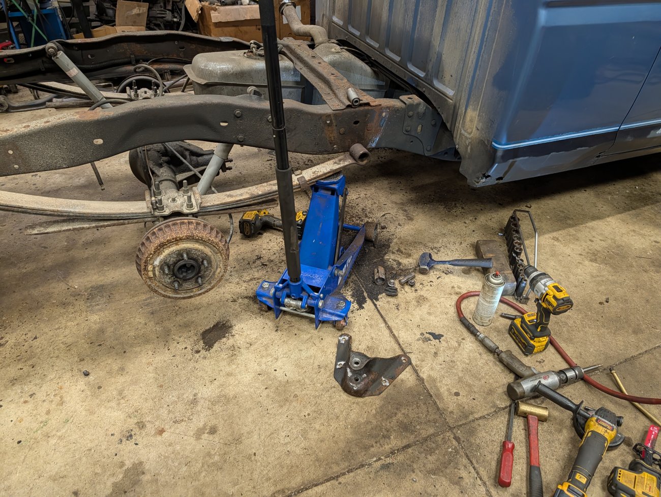

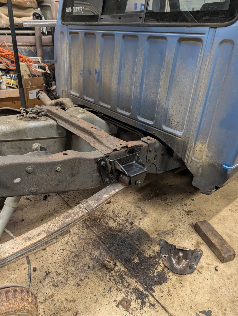

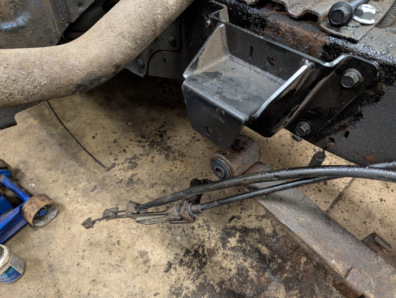

Put the front drop hangers on. I tried like hell to free up the bolts so I could reuse the bushings....but in the end...I cut the bolts and punched the bushings out. Exactly why I stopped trying to mess around doing them with the bed on a few months ago.

Quick RockAuto research says I'll need a different RH parking brake cable for the 10" brakes.

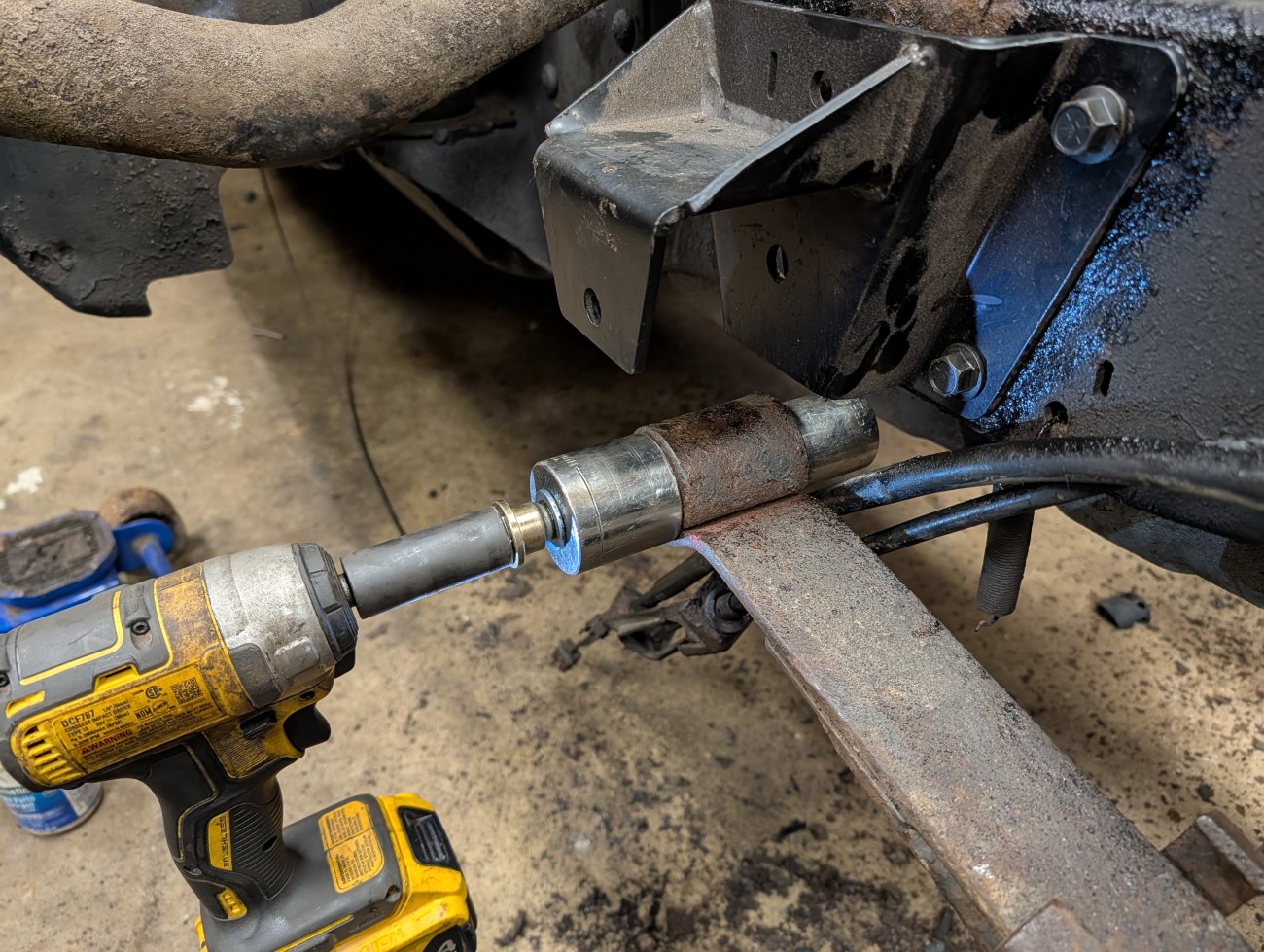

Popped new bushings in with some all thread, a few sockets and a lug nut.

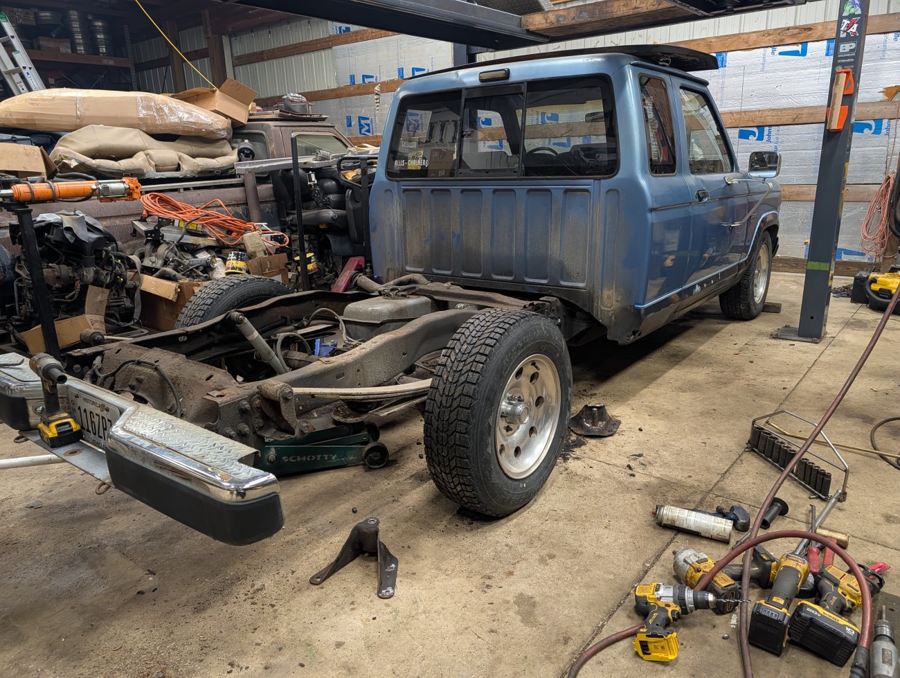

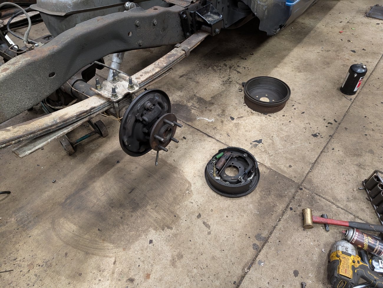

Dropped the 7.5 out and bolted the 8.8 in its place. Had to re-flare the brake lines to swap the ends from 7/16" to 3/8" thread at the wheel cylinders.

Everything was going smoothly up until this point.

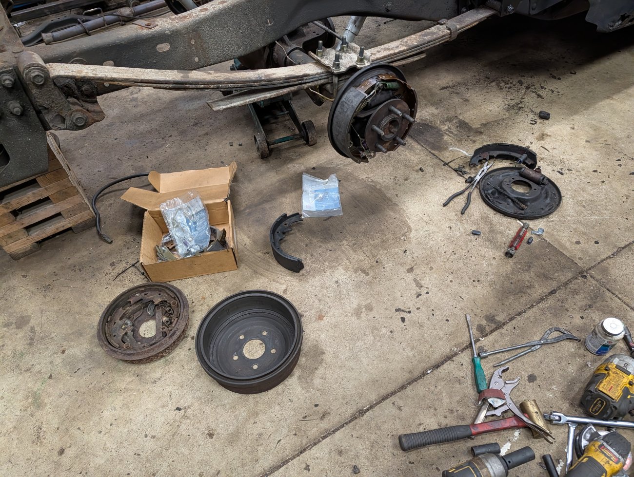

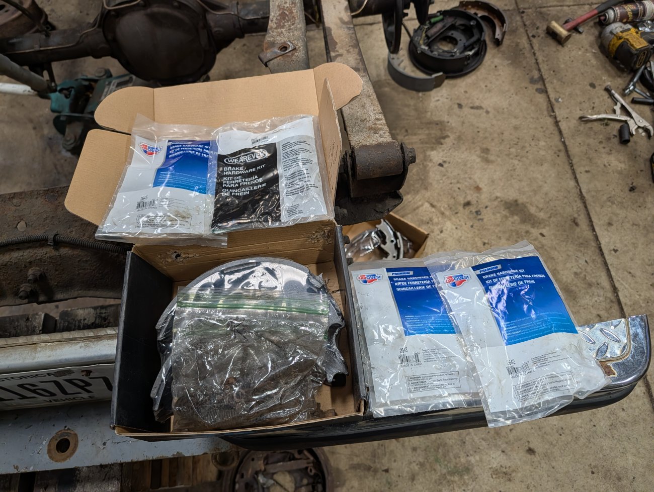

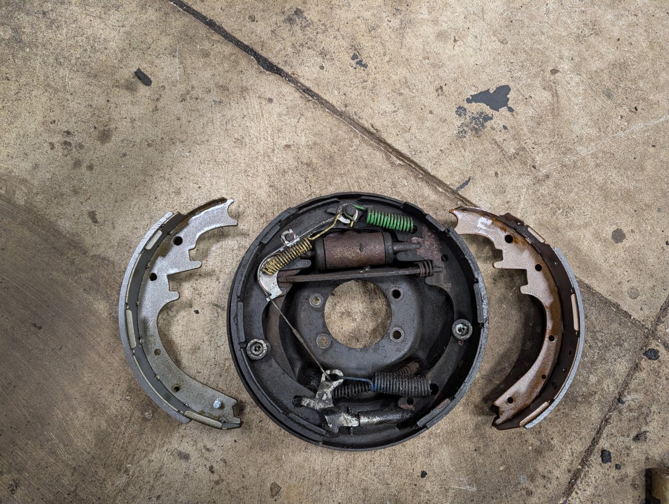

The 1999ish 8.8 came as you see it with bare 10" backing plates....no worries. I have loaded backing plates and drums from the 1994 8.8 that I swapped into my black Ranger and reused the original 9" brakes on that truck....I also have some wholesaler closeout Motorcraft shoes.
Where things get weird is that the new shoes I have don't have the correct holes for the adjuster/lower spring setup...no worries! I have a box of wholesaler closeout out adjuster hardware that worked!

Perfect right? All installed pretty smoothly... besides the parking brake arm is a different shape on the newer brakes and the 88 cable may need some modifications (TBD later)

Apparently the 1999 axles have a larger hub pilot....so the drums I have won't work.
Never realized there were so many variations in brake hardware over the years....but between this truck and my black truck I have found a half dozen things that don't play nice depending on year

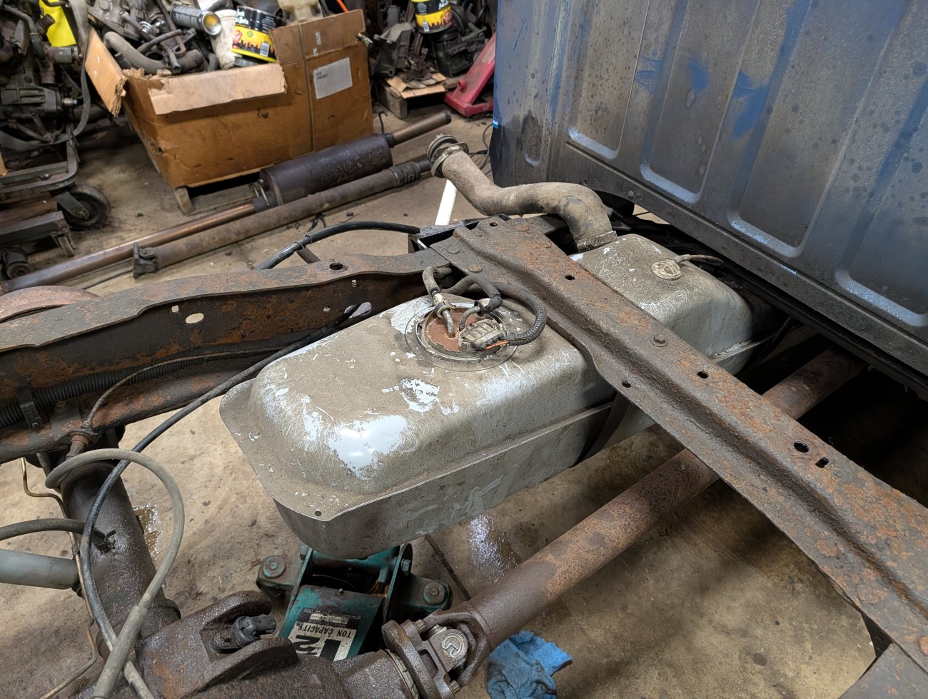

Next on the list is swap the in tank pump for a high pressure 255lph and bypass the frame rail pump. I need to look at wire sizes, but I may need to run a larger power wire to the tank.
Walbro 255 installed with a fresh strainer and a pigtail.
PlumCrazy's 88 SuperCab 2.3T Build
Back in the tank like nothing happened. (Also driveshaft installed)

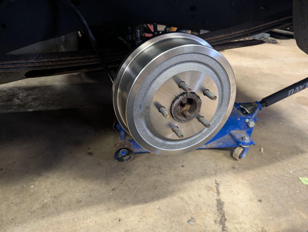

New drums should arrive Friday so I can move this under its own power. Then it's just toss the bed back on bypass the frame rail pump and take it for a test rip.

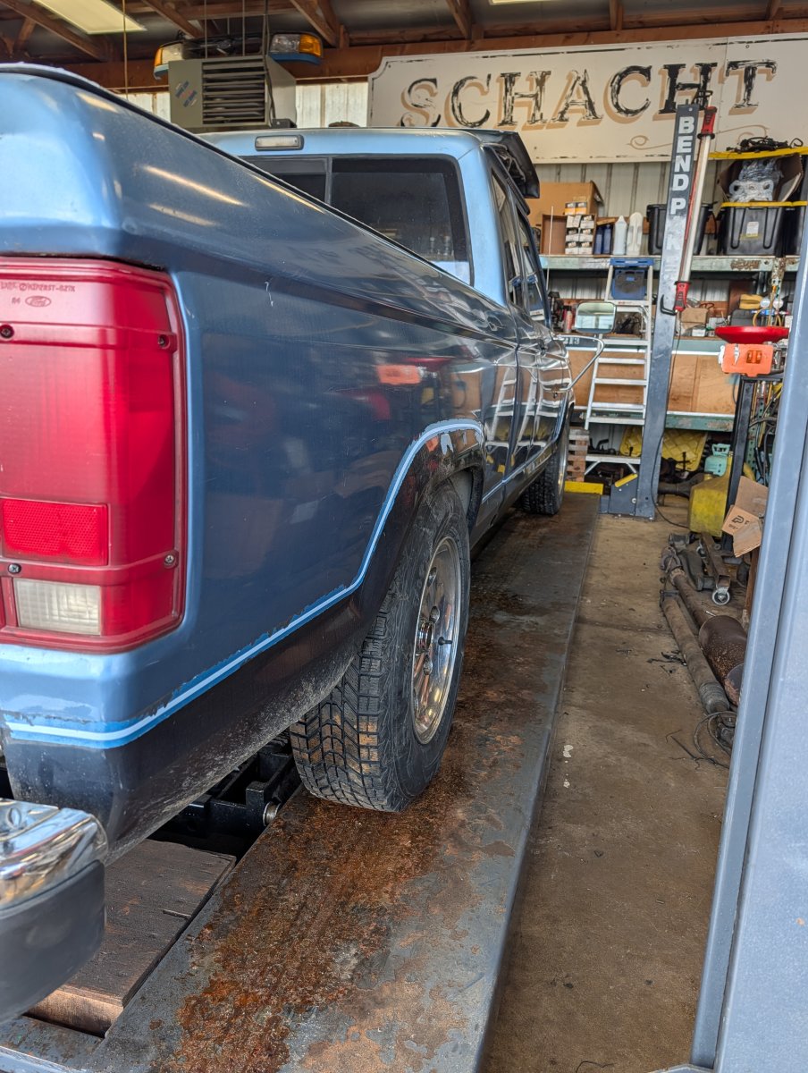

Bed re-installed

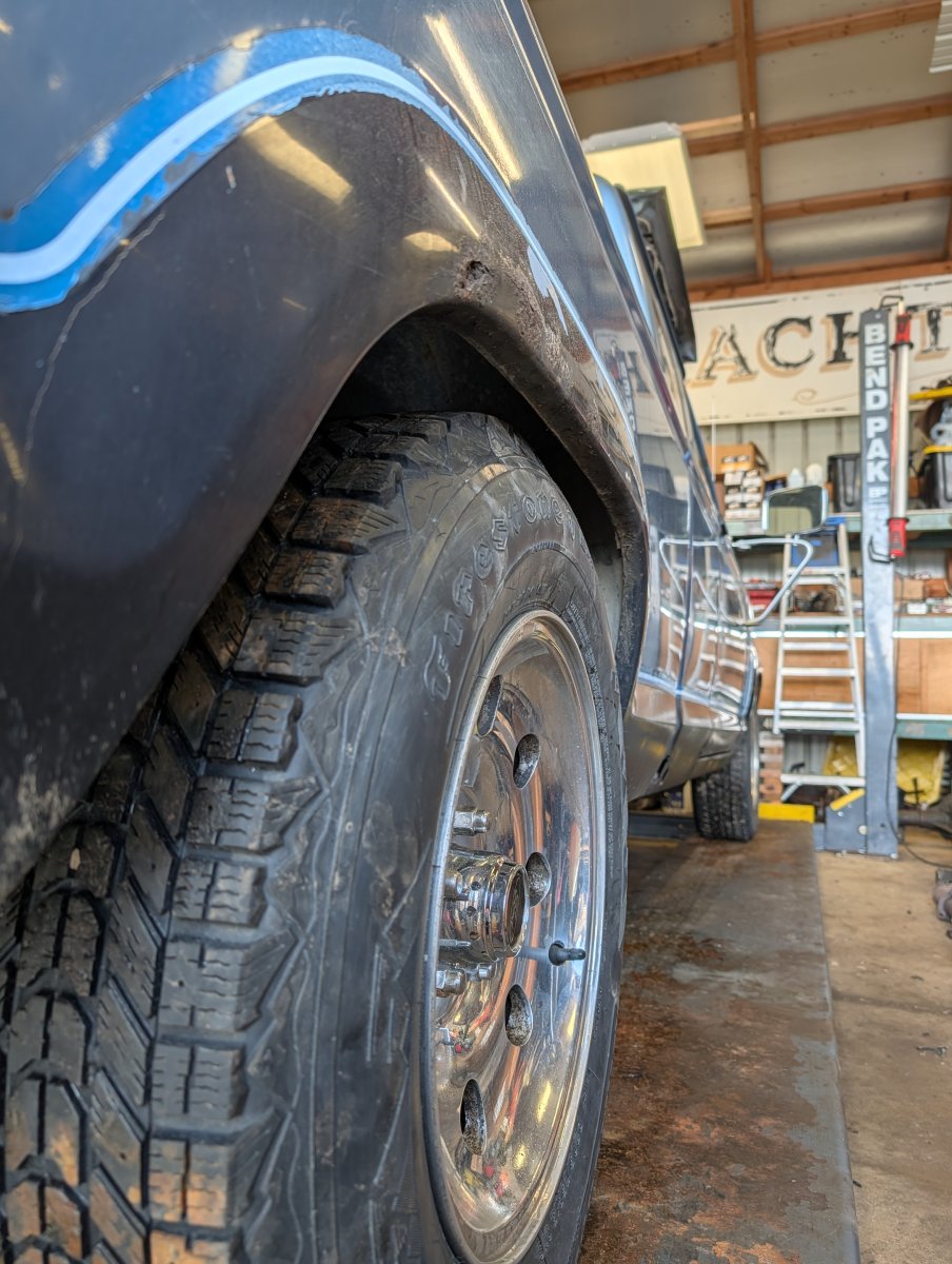

Put the Alcoas back on and they clear! I will probably trim the lip of the fender back a skosh, but bouncing on the bumper there is no contact as it is.
I'm pretty happy with the fitment now. It has had a wider track width upfront ever since I put the drop beams and 95-97 spindles up front. Now it sits pretty even all the way around

Broke my last pilot bit making the old brake drums fit over the rear axle pilot so I could move the truck and check wheel fitment.....so the hood got to live another day.

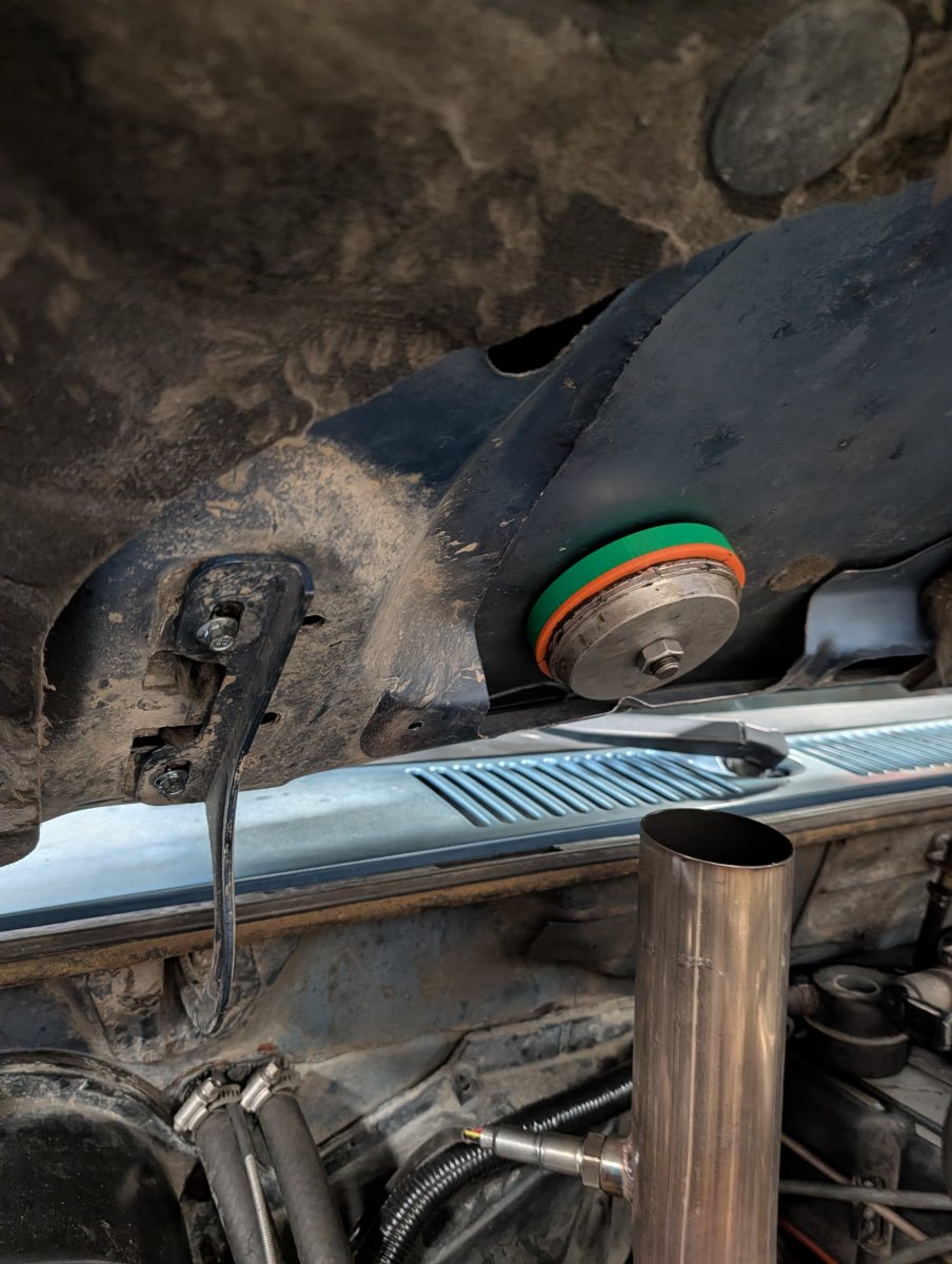

Got the exhaust hole cut, I think I'm going to dimple die the hole upwards to keep water from running into the hole if its sitting in the rain.
Drew up some dies and they are printing now

New drums are on

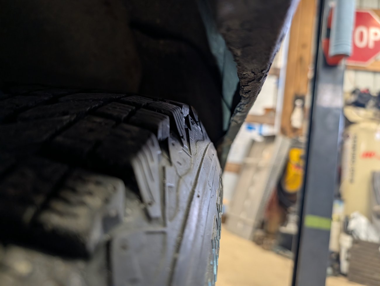

I trimmed the fender lips back after seeing the pass side had rubbed the tire during my test drive. This bed is too rotted to try and roll the fenders so I just trimmed 1/4" off the lip.

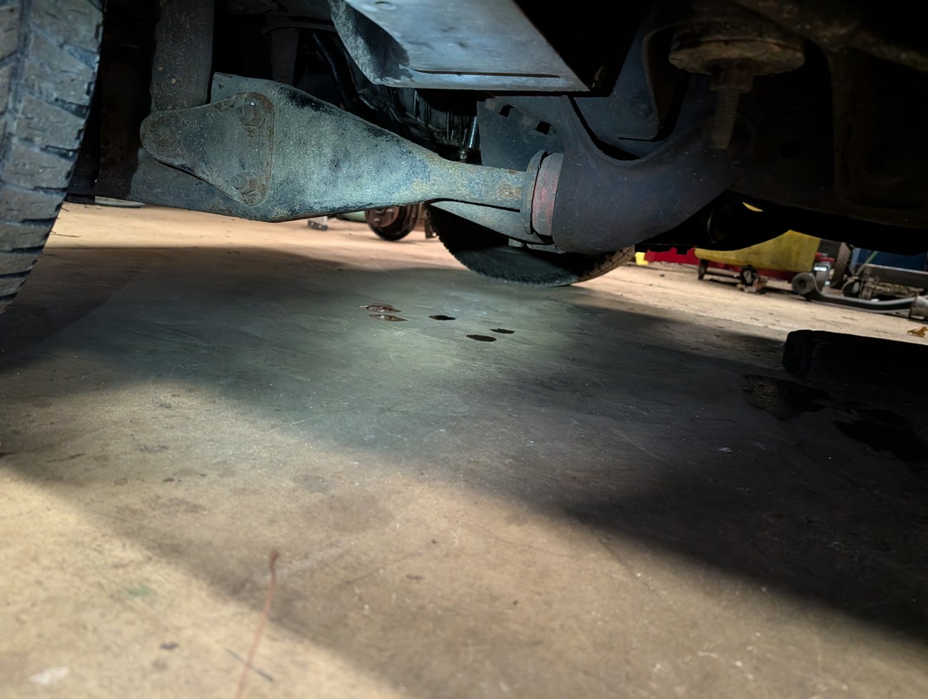

As for the oil leaks, welcome to the turbo Lima life! Mine has been plagued by them from the start, I finally have a handle on most of them but still get spots here and there...

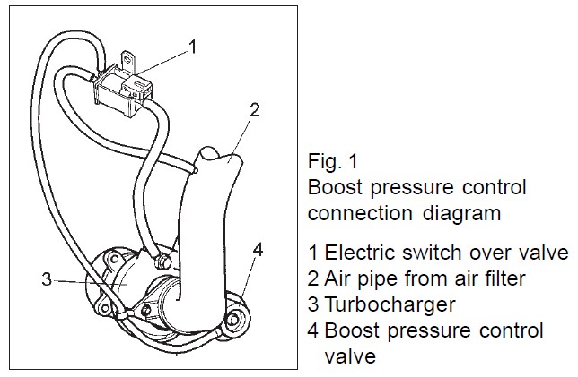

My internet sucks so I'm not scrolling back pages this second but on your boost controller setup do you have the reference before or after the throttle? I just have a boost fooler thing in mine and have it adjusted for about 14psi but it just goes from just after the turbo to the wastegate. Also sometimes the valves are directional if you have an electric controller
It's from the compressor outlet to the actuator through a boost control solenoid that is not enabled in the tune yet. Boost control solenoid is wide open while running based on me blowing through it (plumbed properly as per Pierburg diagram) Besides I’m venting to atmosphere not back to the inlet
The waste gate has a Chinese actuator that came with the v-band outlet... allegedly they are all 8psi. Idk if it has bad diaphragm or what.
Edit: I know I plumbed correctly originally…maybe I flopped the hoses when I had the turbo off to seal everything up….I’ll double check this evening
Dimple die worked kinda okay. I didn't make it aggressive enough so it only added an 1/8" lip or so which should be enough for what I need it to do.
Used up all the random colors of filament that came with the printer and I would probably never use. With some all thread, impact socket, and some seal driver bits we have a dimple die.
