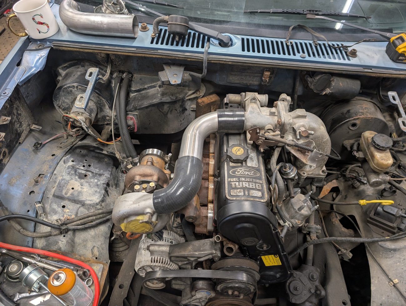

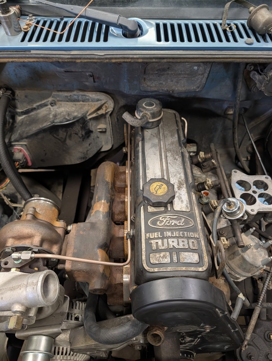

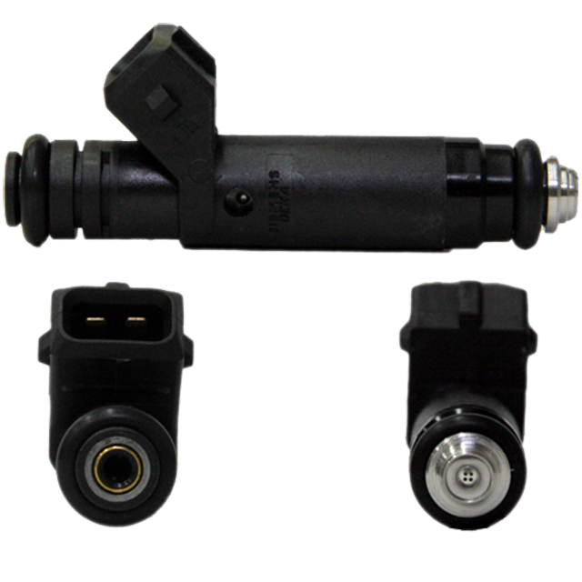

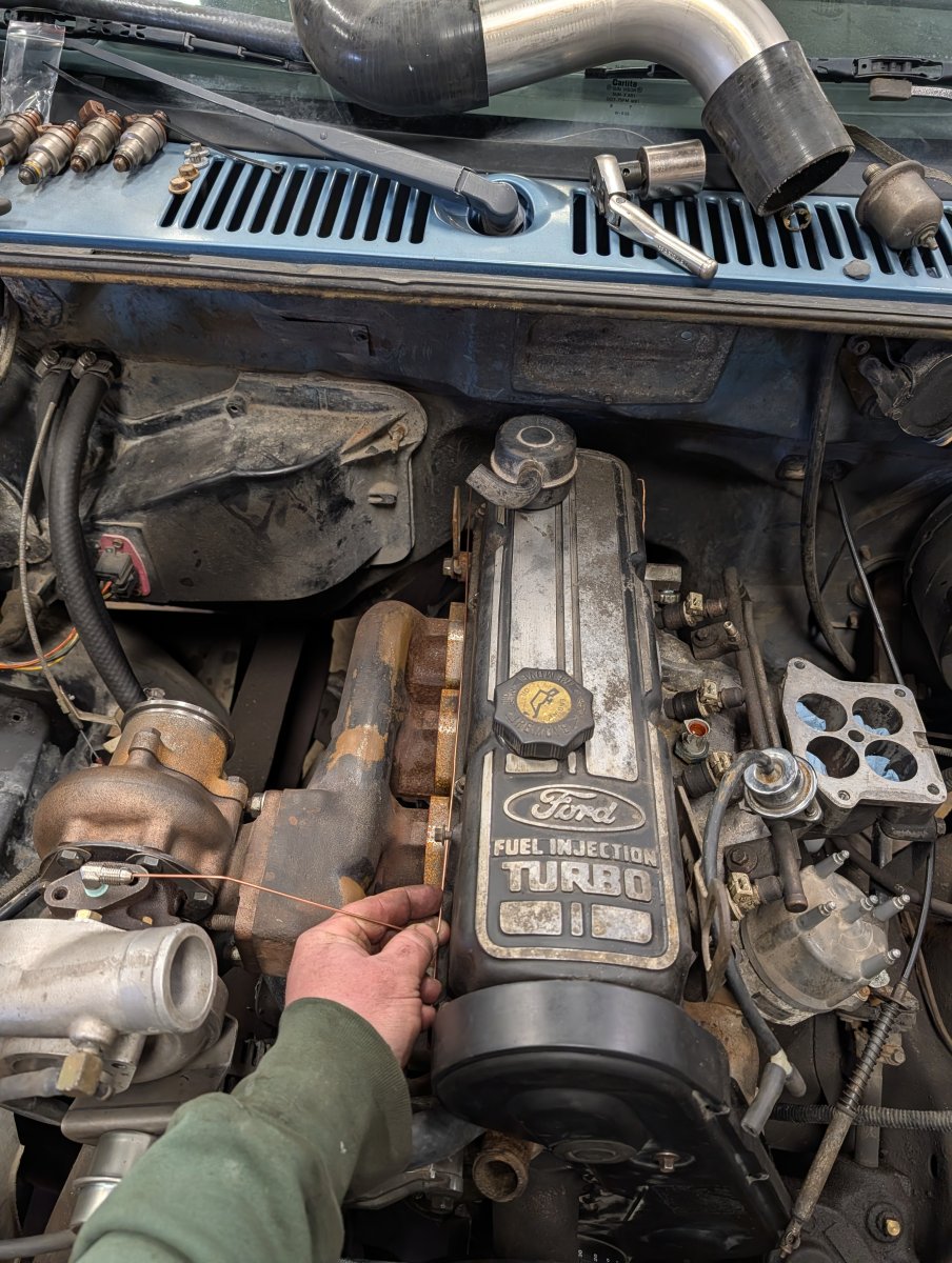

I've been on the fence with what to do with injectors. I see two of these injectors have different o-rings and tips on them making me think someone has been through this before. I will likely end up putting a fresh set of injectors in this setup eventually.I don't recommend using the brown top injectors. They are low impedance and are known for leaking with age. Racetronix is where I buy mine.
