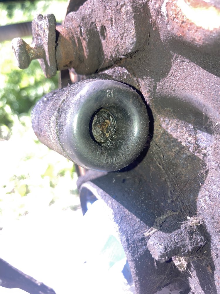

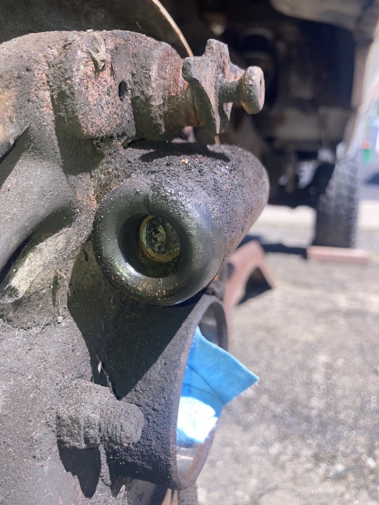

Also here’s my right cylinder.
No idea what the insides should be looking like… ?
I don't believe those wheel cylinders use the pins. The shoe has the the "pin"
Roger that. Looking at the pics I posted of whole assembly, sure looks like it.
I guess the next step is to fire up the truck and press the brakes and see what these things do?
When you press the brakes the master cylinder will send fluid down to the slave cylinders, which is what you have pictured. Most likely you will pop one of the pistons out then have to bleed the whole system. Wait until you have it back together before pressing on the brake.
