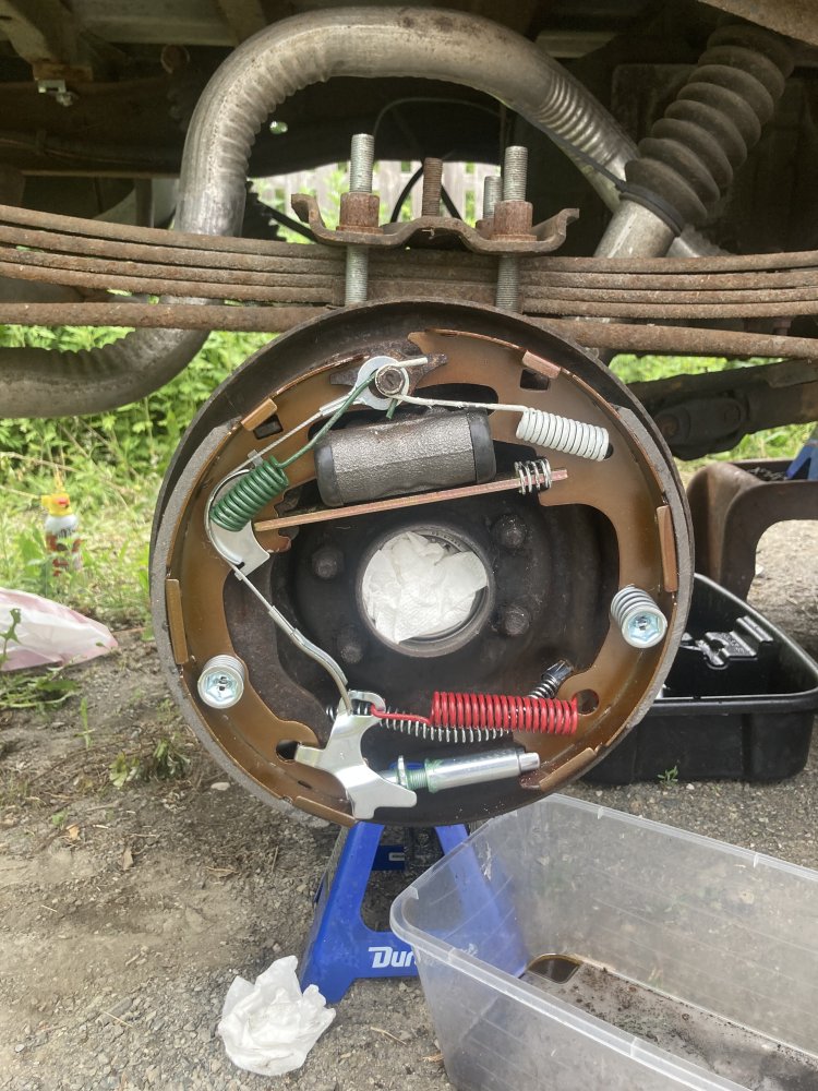

Installed both rear parking brake cables and also the rear right brake assemblies. Took a while to wrap my head around it since half the parts were non existent for me so I only had a couple incomplete references online.
The parking brake engineering perplexes me. I don’t understand how it works, like how it applies and holds brakes to the drum. But all I need to know is that it’s installed correctly, which I’m unsure of. Anybody able to confirm? I don’t see how else it could be differently installed so it’s my best shot. It’s in a little notch in “rear”shoe, but otherwise kinda floating functionally speaking.

Here’s a pic of the rear right all fresh. I don’t see how else the parking brake could go.
Your park brake is way to tight.
The top of the shoes should be firmly up against the anchor pin.

At the moment, my two rear parking cables are connected to nothing. They’re just dangling at the juncture to the front cable, so nothing is pulling them so I’m not sure what tight means.
Also there is only one relationship / angle the parking brake piece (not the shunt) can connect to the rear shoe. Shoes has a triangular notch in it which receives a matching triangular peg on the brake piece. It’s in place.
The shoe towards the front should be resting against the top pin. It's not. It may just need a shove in the right direction.
The brake cable I'm unsure. Is it the correct cable? Maybe it's meant for a 10" and you have the 9"?
Another look at what you have... the primary brake shoe doesn't appear to be seated properly in the wheel cylinder.
