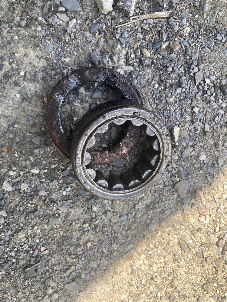

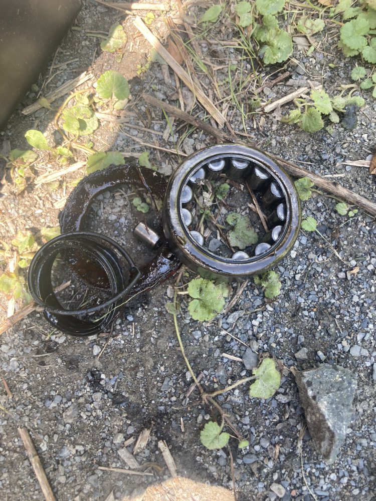

Got it all out. Wasn’t easy, even with the right tools.

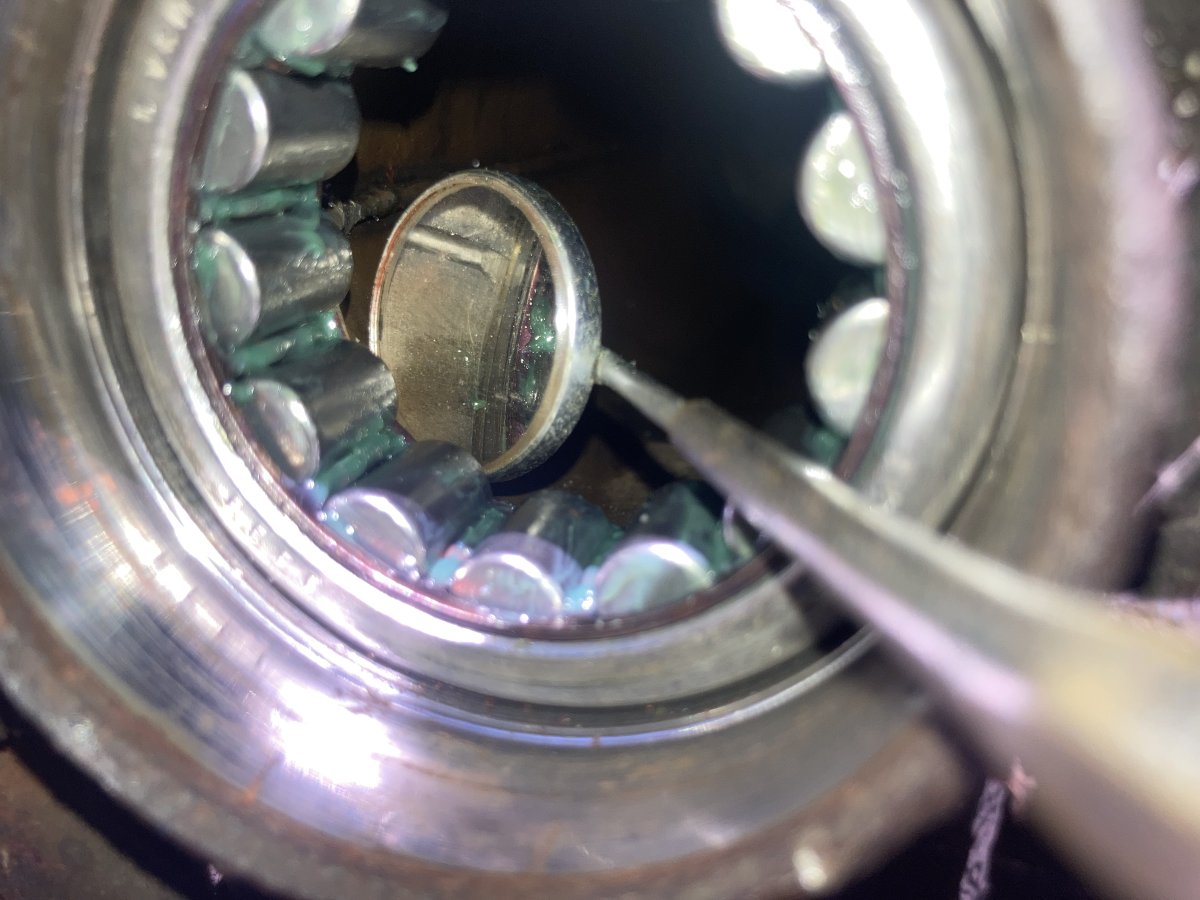

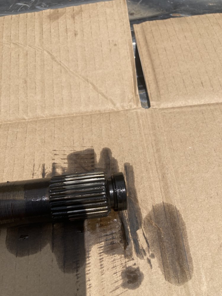

Second one was the leaking one. At some point I also yanked out a single bearing in this process. It wasnt loose inside.
No idea how worn these bearings are but I’m glad I’m replacing them.

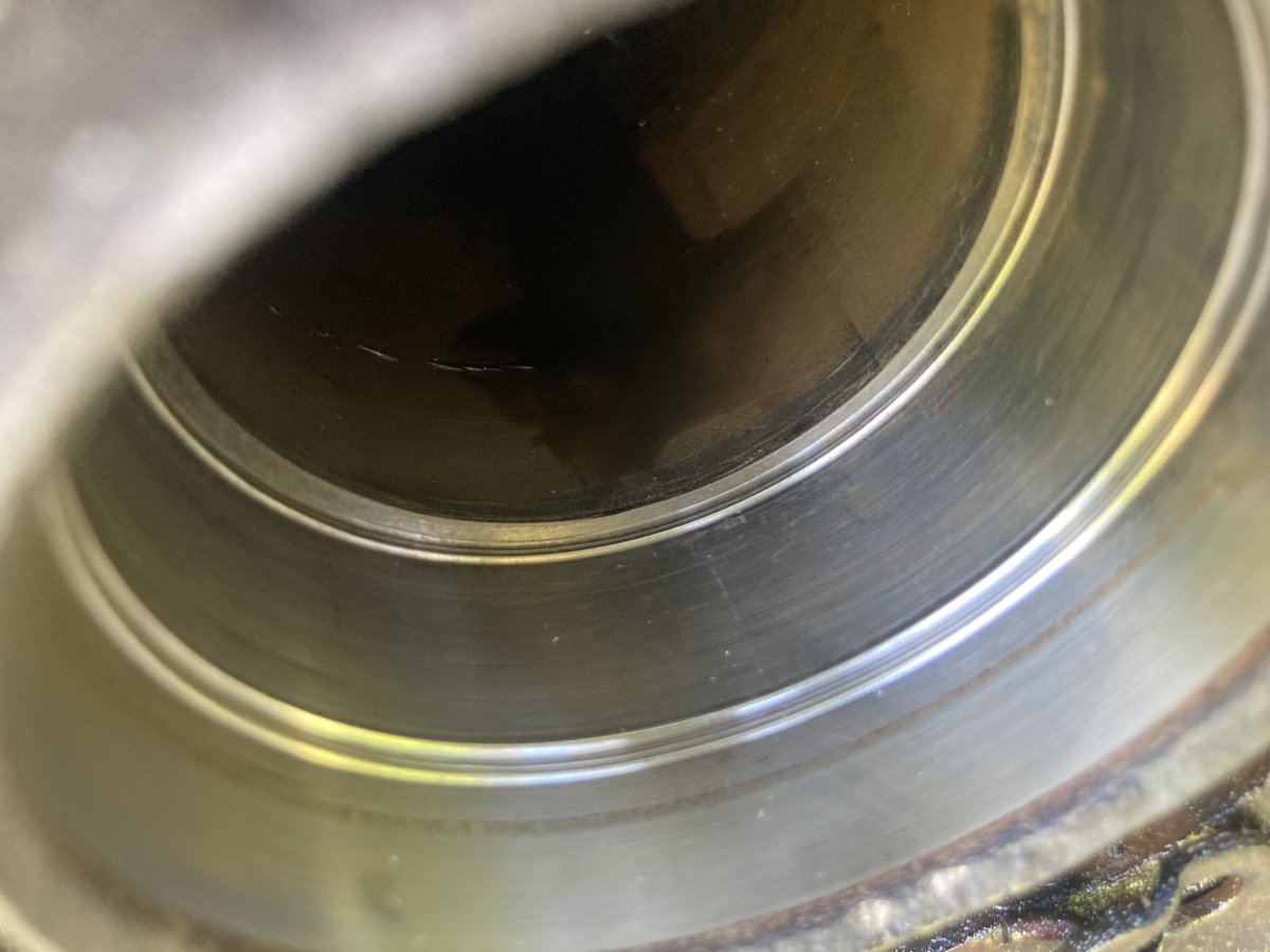

Got a bearing installed but am uncertain it is in fully. Here are pics, sorta showing the inside edge. I’ve banged at it bunch more times and it seems to not go in any more. However you can see a little lip of those seat edges. It’s in evenly, just not sure deep enough. Will try other side and compare results, maybe that will reveal something.

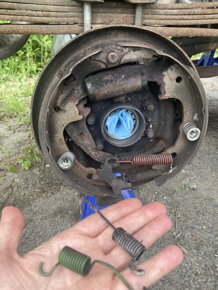

Ok, it seems I am missing a whole bunch of components in my rear drum brake system. And, that the same exact set of components are missing from both sides.

Here's a pic of just having removed the first two springs up top. That's all i had touched at this point.
Comparing it to this brake disassembly vid of a 1990 Ranger, https://youtu.be/rlUeUk8swLg , (skip to 4:00) I have several things missing including some cables and pivot bracket type things.
Additionally, the parking brake piece/strut is not what i was expecting. I was expecting something like this https://www.rockauto.com/en/moreinfo.php?pk=11585&cc=1137642&pt=10715&jsn=952 , but all i've found is this wildly different piece attached to a spring/cable shown in last pic.
No idea where to go from here. Am i missing pieces? I'm happy to thoroughly clean and recondition what i have, but i can't tell right now if i'll ever be able to make these assemblies function/complete.
On a side note, I'm almost positive i've been rolling with zero rear braking since i got the truck.

Right, disassembled and showing parking brake thingy dangling:
Your missing the self adjuster cable and guide. Also missing the park brake strut and spring.
But I can't find a listing for the spring that goes on the strut. Also, make sure what you order is for the size of brake drum you have.
I don't see the pins in the cylinders.
You're right.
Go to the junk yard and get the parts. Or order wheel cylinders as those are probably pooched anyway. Is the master cylinder empty on one half? With nothing to hold the pressure in the wheel cylinders all the fluid is probably gone. Or is this a rear end that you bought to put into your truck?
You're right.
I did an edit, now I don't think there is supposed to be pins. instead the pistons contact the shoes directly.
