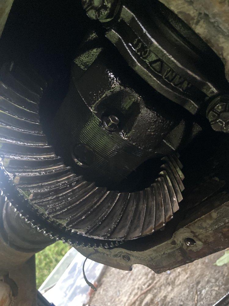

Status update on the rear project w the axe seal leak and doing new shoes and bearings.
My truck’s bolt for the cross pin isn’t 5/16” as mentioned in the Rear Axle Seal guide here at TRS, instead it’s a smidge smaller so the 12 point end of wrench just slightly strips the corners of the head and has a lot of free play otherwise. Gonna have to go pick up a 7.5mm or 7mm and see what works. Or maybe 9/32”.
I have both drums off and one is quite rusty on outside, had to hammer it off, but it seems pretty much ok on the inner braking surface.
Looking forward to getting the axle shafts out and seeing inside. Really hoping the bearing removal/install isn’t a monster.

that bolt has lock-tight from the factory. it can be a challenge to get out.
I use 6 point tools on it. slow steady pressure, and be sure to not induce off-center pulling force. that's where the tool pops off sideways.
You use a 5/16? Maybe a six point will work.
If you have metric, 8mm is the same as 5/16".
8mm = 0.3149"
5/16 = 0.3125"
not much of a difference, but if the bolt is already partially rounded that extra .0024 is going the wrong direction.
however,,, tools have tolerances, find the one that fits best.
I have a 5/16 snap on 6 point extra long brake bleeder wrench I use on that bolt.
in the get creative department, I have an 8mm allen socket with a removable bit.,
that makes a nice thick and deep 6 pt socket.
does it have the rounded or sharp angles?
for those tough bolts, get out of the box.
Hmm that’s a good point. I have one of those too, with an 8mm removable Allen bit. Only question is can my smallest socket wrench get in there too. Will give it a shot.
I also am curious to put calipers on the bolt head. I tried both a 5/16 and 8mm crescent just to see how they fit and both were pretty oversized regardless of the corners being a little worn. Kinda weird
