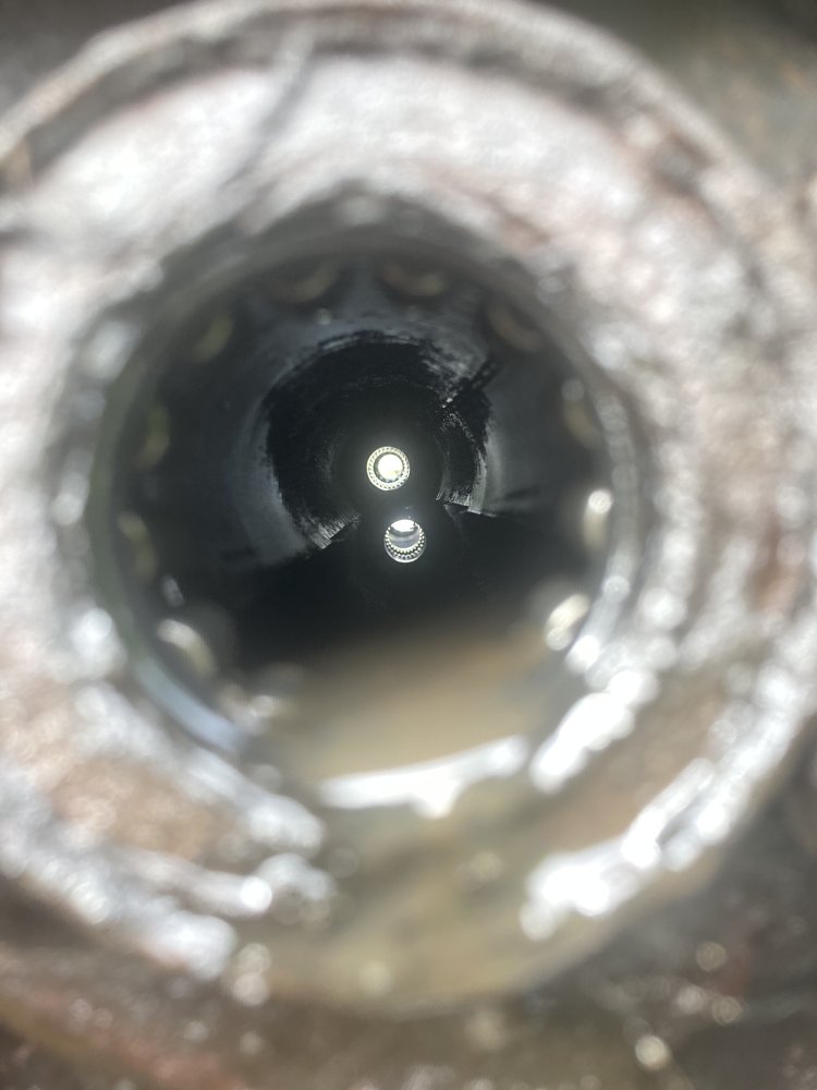

Earlier in the day I made this video for you guys (linked below) but didn't post it since you all had already answered some questions in it, such as possibly needing to dremel a gear or two to get the pin out.
But this video is still helpful just to be able to see the current status and also some detail of the pin. It's like 3 minutes, and I explain where I was at with it all, the biggest new concern being i can't get the damn pin back in place.
Now, i'm actually starting to think maybe i don't even need to get the pin fully out. Maybe i can just leave it dangling mostly out and that's enough clearance inside to get the C clips out.. WHILE those Z clips are still in too, hahahahahhahaahhah oh boy...
(Btw, those few white specs in the gears aren't metal shavings, just some crust from my gloves that i'll clean out. I haven't seen any shavings so far, except for on the drain/fill plug whenever I was adding oil.)

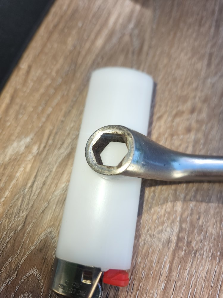

I looked at the Snap-On catalog, those are very expensive now.
maybe because they know how much it costs to dig out a rounded lock pin bolt.

Oh dude, if that's where you're at, you're golden. So the pin is hitting the ring gear; I guess the "thick gear" cutoff on the 7.5 rears must be lower than on the 8.8s, where that interference doesn't become an issue until 4.56 gears. But more importantly, the back of the pin appears to be clearing the axle shafts, so you can pull the c-clips.
If you haven't already, pull your wheels and drums. Leave the crosspin hanging out, then firmly press one of the axle shafts in towards the differential. You'll see the differential-end of the shaft move into the space the crosspin used to occupy, and the c-clip will come into view. Spin it with a pick or a screwdriver or something until the open end is either facing up, and the c-clip falls off, or if you have a magnet, until the open end is facing in towards the pinion gear, then you use the magnet to pull the clip off and out the front. Repeat with the other axle.

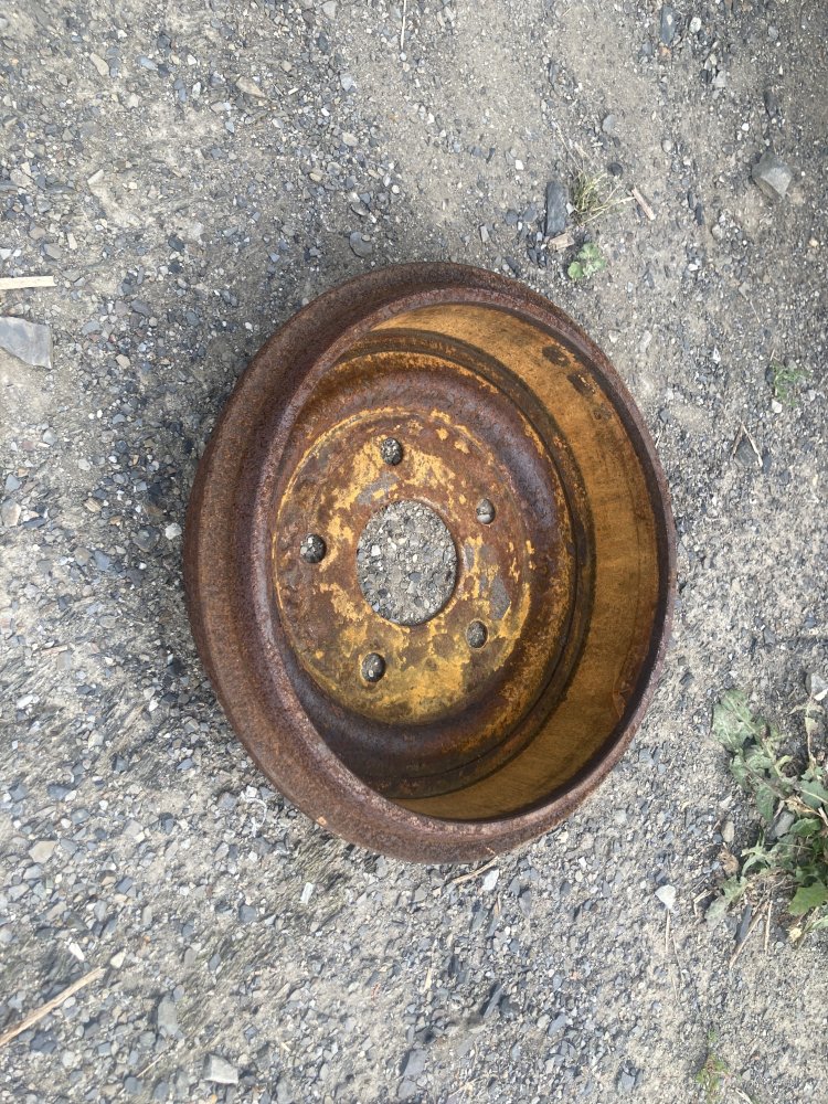

On a side note, one of my brake drums is covered in surface rust. It does scrape off via fingernail, with a little work. I have a media blast cabinet so am thinking I could clear the whole thing off, or at least just the braking surface.
But am I vitally wrong about the braking surface? Glass bead blasting sure makes things smooth. But it won’t be the OEM surface. I guess maybe I try it out and then if I hear strange noises I just have to replace it.
The other drum is completely rust free. This is because that one is covered in gear oil!

Success! The c clips were in fact accessible through the Z clips. Just had to rotate them then carefully knock them back with screwdriver on top and bottom and they fell down.
