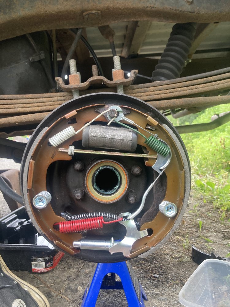

He's just got to get everyone comfy with their new homes. Yes, the primary shoe needs to be seated against the top pin, then naturally the tab seats properly in the wheel cylinder
You want a strap around the brake shoes before you pump the brakes. Otherwise, you will eject the pistons from the cylinders and get brake fluid all over everything. And remember to pump softly - brake cylinder would be forcing the shoes against the drum hard enough to lock the rear wheels. You wouldn't want the strap to break.

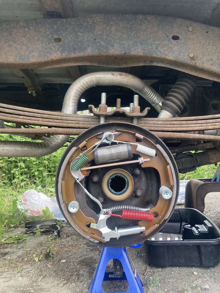

Another look at what you have... the primary brake shoe doesn't appear to be seated properly in the wheel cylinder.
Yeah agreed, didn’t catch that when took the photo. However it’s just a matter of bumping it down a little. Will use a rubber mallet tomorrow to fine tune it.
Overall I am unsettled by how loosey goosey the assembly is. It seems to really just depend on the drum for staying in position. One can just push from the side and move the whole contraption around. Same goes for the other side. I tested that side for this before taking apart becuse I was like huh did I do something wrong?
This leads me to be concerned about one thing though.. should the surface of the inner plate be somehow treated or lubricated for the smooth motion of the inner edge of the shoes? I mean there is inherently a ton of friction there, making it difficult for the shoes to move this way or that. Like did they design the system assuming the inside face of the plate will be super smooth metal forever? Isn’t all that friction going to also make it hard for the springs to pull the shoes back away from the drums after driver let’s off the brake? Seems like they’d get stuck in weird positions all the time.
Or am I just not realizing how powerfully the cylinders push out and how strong the springs pull back.
Seems like a total waste of energy. Couldn’t there be pivot points and otherwise the shoes float away from all neighboring surfaces?
You typically lube the backing plates on the high spots. You only need a little.
The brake shoes should swing front to rear... that's how they self energize and self adjust.
Mind you... they shouldn't be sloppy lose.
On post 56 you can see the 4 spot (light rust) where the shoes sat on the backing plate - you need just a dab of high temp grease at those locations.
The brake line pressure might hit 1,200 psi from the rear drums, the piston is 0.75", so when you slam on the brakes, you are getting over 500 lbs forcing each the shoe against the drum.
And you only want the shoes just clearing the drums.

Excellent info thank you.
Interesting about the parking brake. One of the reasons I’m focusing on this project is because I really want to have a parking / E brake for regular use. Good to know it’s supposed to be used frequently.
As for those points for high temp grease, hopefully I’ll be able to get some in the passenger side in photo, by shimming it all around a bunch but if I can’t I’ll have to undo it all and grease those points.
When I set the adjuster for the drum I’ll make sure to get them with close clearance.
As for the parking brake mechanics, I wish I understood it! If I have it installed correct, and the cable is pulling at the bottom of the special little floating bracket thing seated behind secondary shoe, and that bracket is pulling down/over the top of the secondary shoe at its connection point, then it must be using the secondary shoe to force the brass cross strut over and into to the primary shoe via a spring which forces the primary shoes against the drum. That’s the best I can make of it at this point.

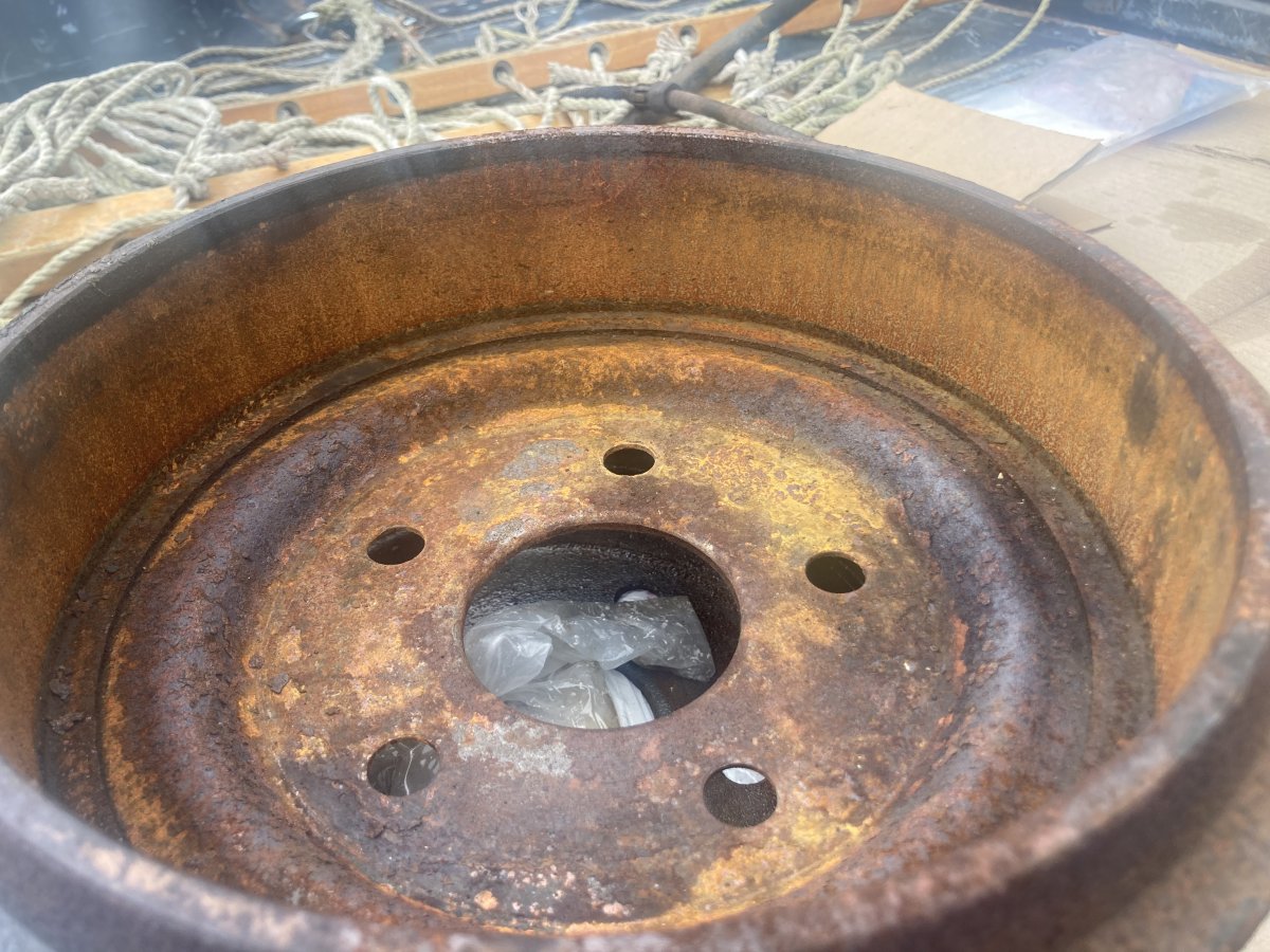

So here’s one of the drums. Cleary it hasn’t seen shoe action for a while. Other drum probably hasn’t either but due to my axle seal leak it has been covered in oil and been perfectly preserved!
I want to just spend a half hour attempting to refurbing this rusty one to save cost. Any harm in using a wire wheel on inside braking surface? Just not sure how much that will screw up the shoes if they make contact with a surface with a zillion zig zag scratches on it. Probably not much of an issue.
Another option is media blasting it. Would need to do it outside and let the media just fly off into the wind because I can’t have all this rusty stuff going back in through cabinet lines and through gun. Would make a smoother surface than wire wheeling though. But more time and effort and setup.
Maybe I just wire wheel inside surface and go over it with a 220 sanding sponge block.
Opening up wheels/brakes/axles for projects, could use some parts selection help
Wire wheel is good enough. Rough surface will help break in the shoes.
As a far as sandblast, what are you worried about? Contamination of rust? I wouldn't worry about that. Contamination of oil... I would clean that off with Brakleen or gasoline then sandblast.
Ok great I’ll just wire wheel.
Sand blast this thing inside cabinet is a little risky because of this stuff coming off and possibly passing back through takeup lines and back through gun and clogging it. Blasting outside cab is fine of course just messy and a waste of media

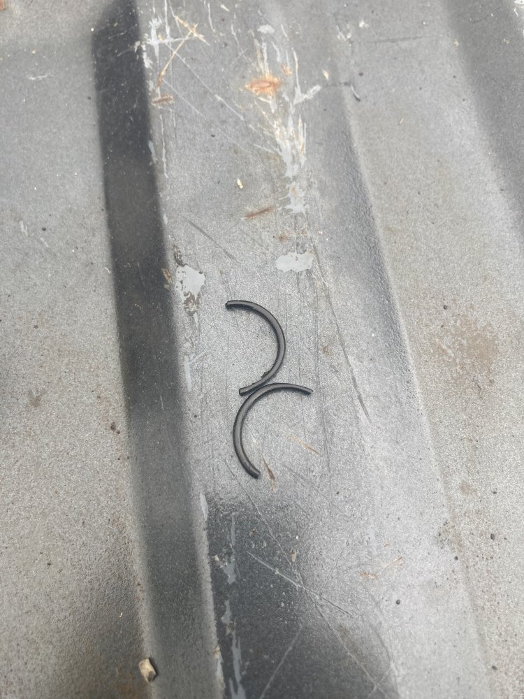

All right, one of these O rings fell apart when I was installing C clips.
Do we really need these Orings?
Seems like maybe there used as an assurance to keep the C clips perfectly vertical and not wiggling around. They can’t be used for locating the clips since mine had one shaft in one place and the other shaft in the other place and both seemed to not be a problem i guess.
Haven’t looked for replacements yet but will.
Are they needed though?
Decided to delete the orings, cut off the one from other axle shaft.
Looked into it and found that mostly they are a factory aid during axle shaft install. Install is fine without. In fact, the rubber is what made my c clips really fastened on VS others who refer to using a magnet to remove C clips. Mine required some force to remove also made it super difficult to install c clips today. Without the o rings, install was as easy as it gets and the c clips are nestled in fine inside the axle.
