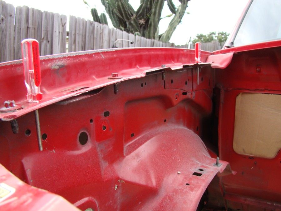

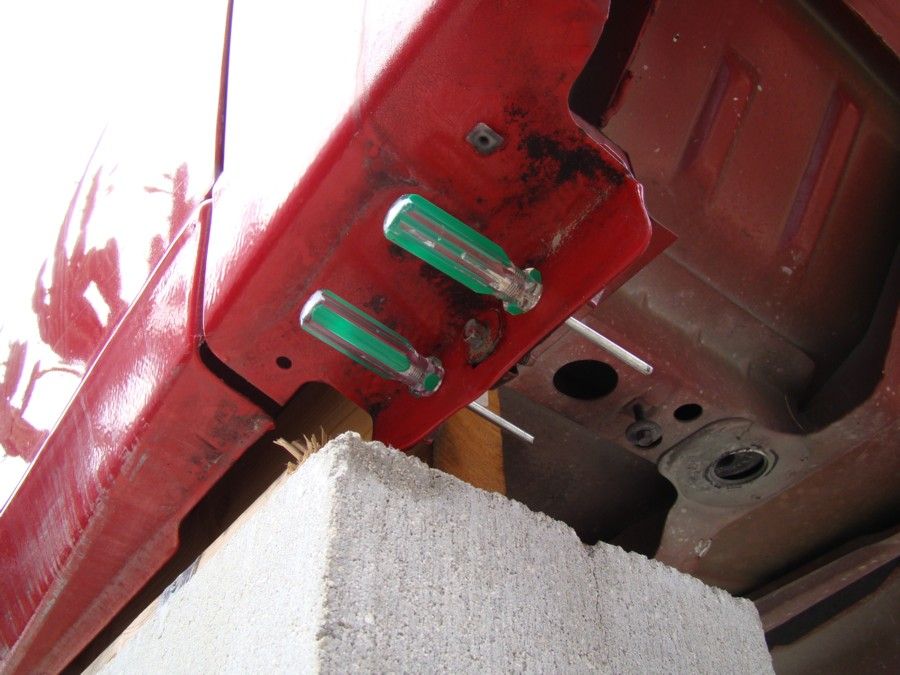

At this point the doors and fenders have been aligned with the rest of the body as close as possible. The final adjustment of fender/door panel transition can be finished up with a sanding block. During the body prep and paint stages the fender panels and doors will be removed and reinstalled multiple times. To make it easier to return these pieces to the exact same location small alignment holes are drilled through the fender edges and door hinges and removable alignment guide pins are fit into place.

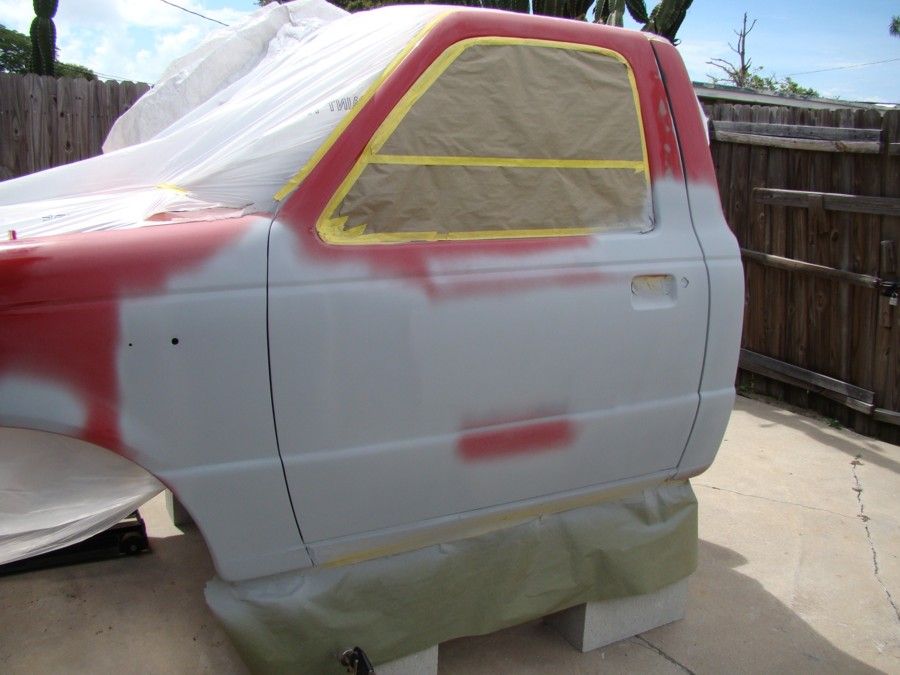

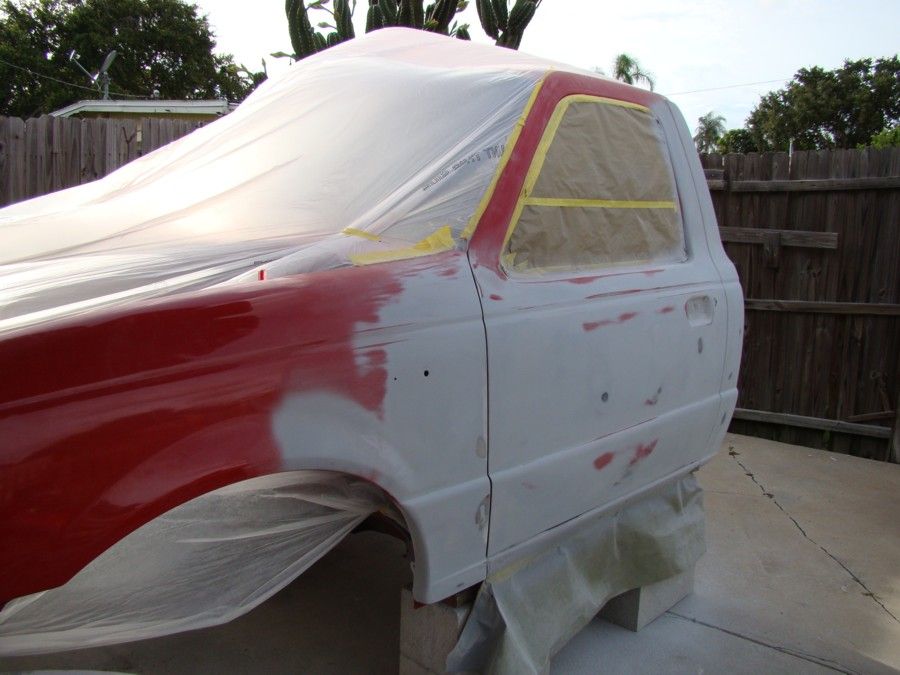

After block sanding the original paint on the driver side and filling a few minor imperfections I got the first round of primer/surfacer on the truck today.

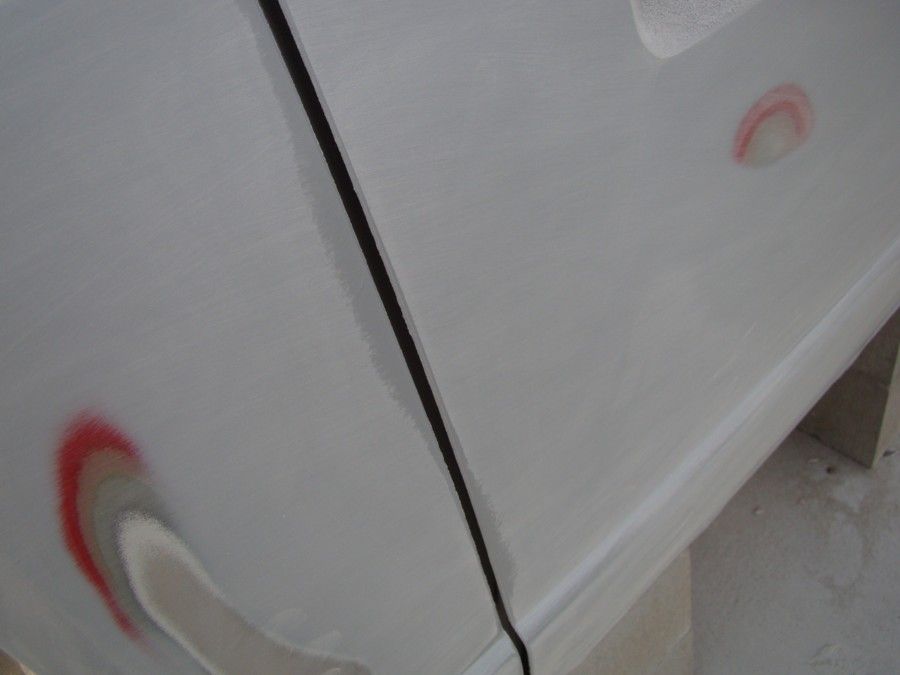

Once the first few coats had set up I started block sanding across the fender/door gap until the high spots started to pop through. Using a cross hatch pattern with a 15 inch file board and 180 grit paper it didn’t take long to get an idea of just how close the transition is and how much work lay ahead.

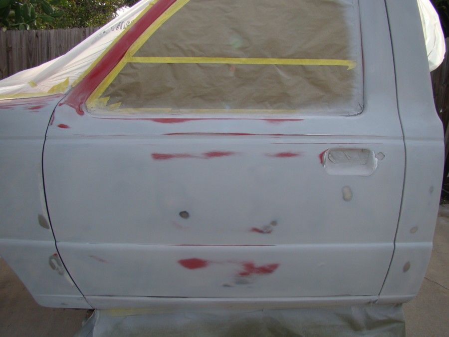

Once this area was done I moved to the opposite end of the door and used the same method on the door/cab gap. Finally moving across the panel from one end to the other until the high spots popped through.

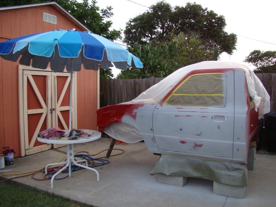

Working outside with no overhead cover through the day in the hot August Florida sun is a killer!! But I made the best of it and even set up a little shade with my wife’s beach umbrella for the occasional break.

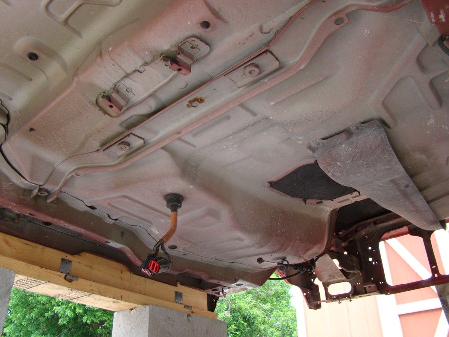

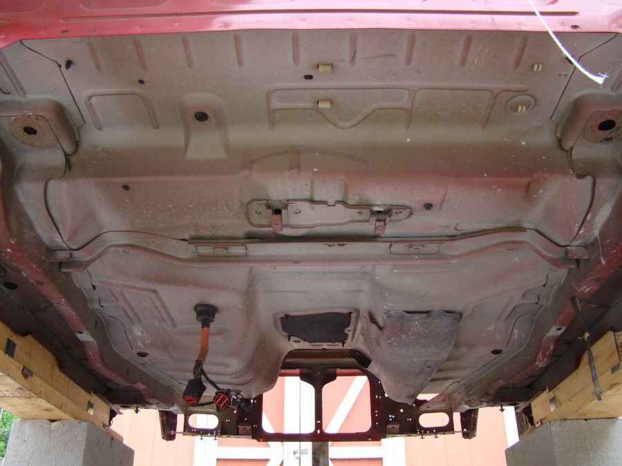

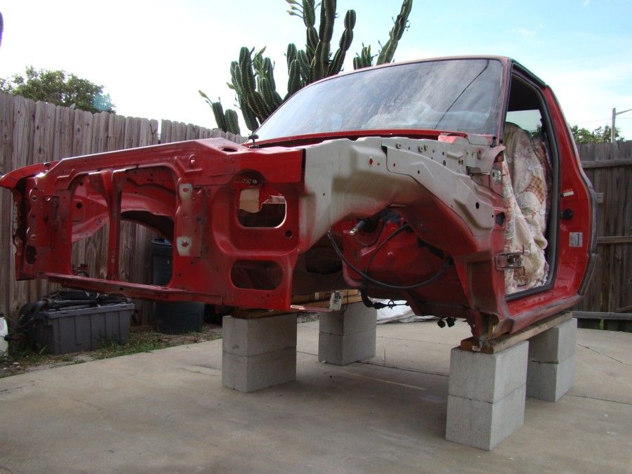

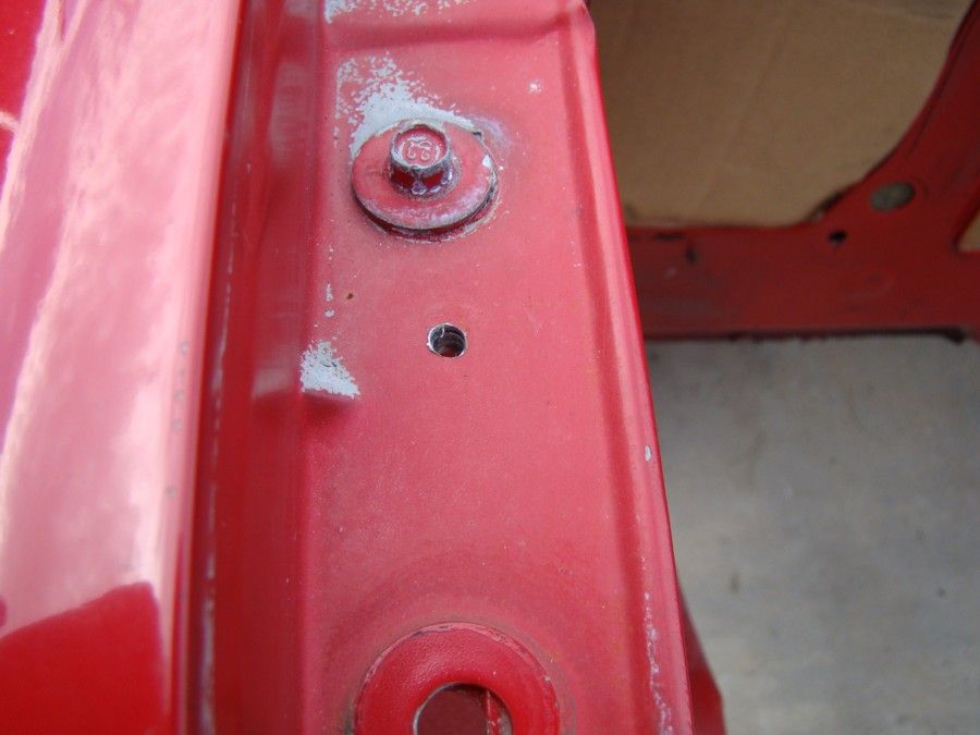

I am still working my way around the cab of the truck trying to get the body arrow straight. In between coats of primer and block sanding I have been knocking out a few smaller items getting ready to join the body and frame in a few weeks. Here are two photos of the body mounts, before and after a good cleaning and touch up.

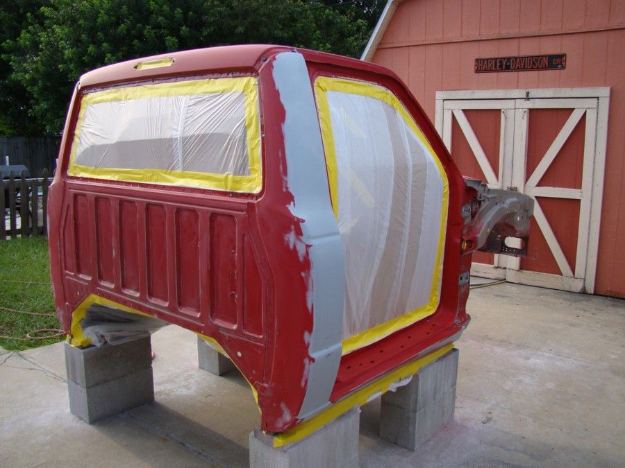

The driver side of the truck has been block sanded with 180 grit paper and primed four separate times. It now sits perfectly straight in the 180 grit stage and all the gaps blend seamlessly from one panel to the next. The passenger side is about three days behind but coming along nicely. Once the passenger side has been brought to the same stage as the driver side the rest of the cab will be DA sanded with 320 dry and the sections currently in primer/surfacer will be recovered with two light coats of primer/surfacer to fill the 180 grit scratches. After that point the entire cab will be hand sanded with 400 grit wet and prepared for paint. I am still planning on getting paint on this thing around the first of September if all goes well.

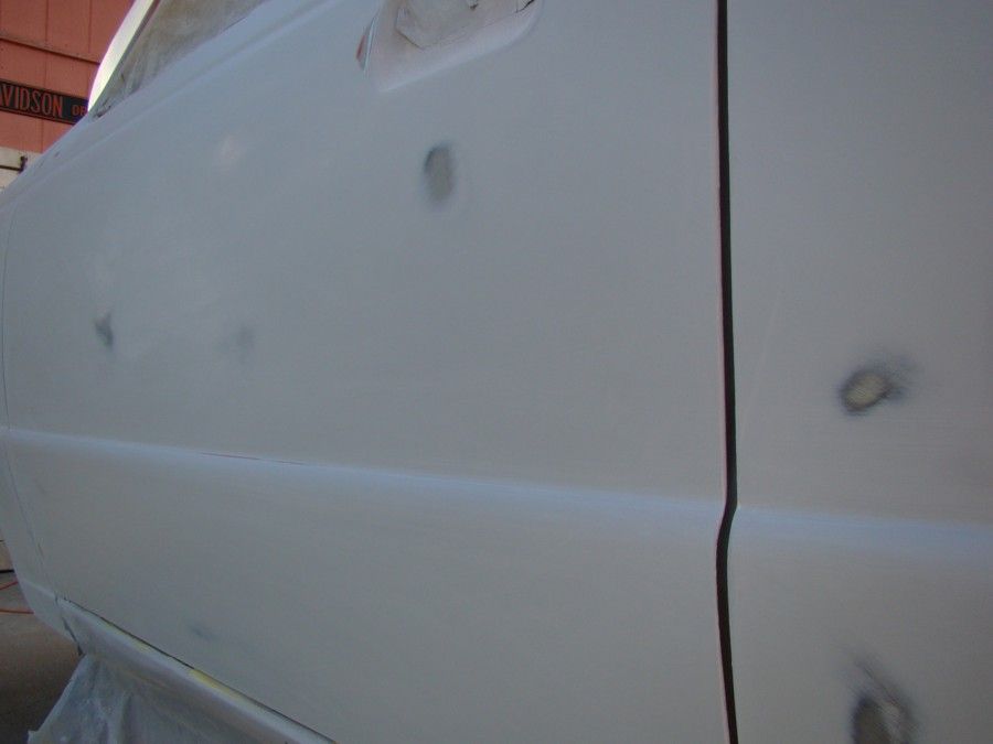

The passenger side has been a real pain in the aXX. Other than a lot of rain, this is what has been slowing me down.

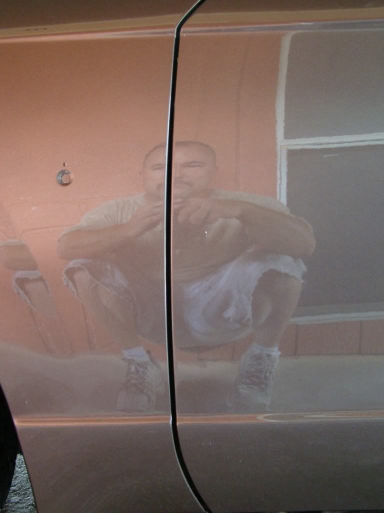

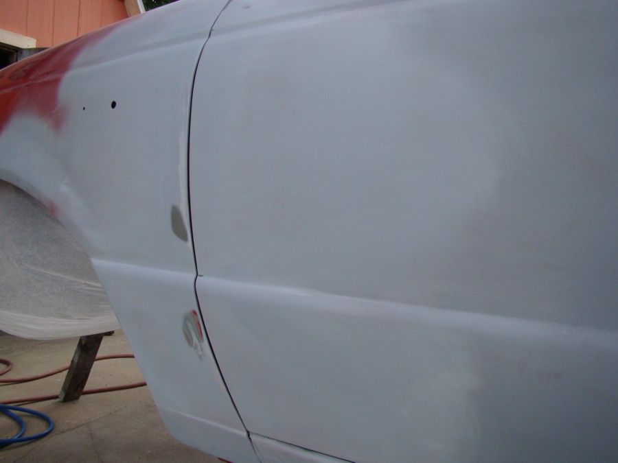

Trying to get the body lines on the passenger side to be perfect has taken more time than expected. The rear of the door and the cab panels line up fairly well but both roll off the edge slightly because of how the metal panels were stamped from the factory. This plays havoc with my “fit and finish”. After blocking and priming the area several times I still have a very slight low spot in two places. Although it doesn’t seem to be bad this is the sort of thing that will create a distorted line in the reflection of the paint. The panels need to be perfectly flush with one another in order to cast a clean reflection in the finished product.
As you can see there is a small gap where the panels come together in this location. I will need to take a step back and add a very small amount of fill in these two spots to get it correct.
The extra time it will take will be worth it once the paint is color sanded and buffed out. The goal is to have the side of the truck look like it was cut from a single piece of billet on a CNC machine!! (Just joking, but you guys get the idea).

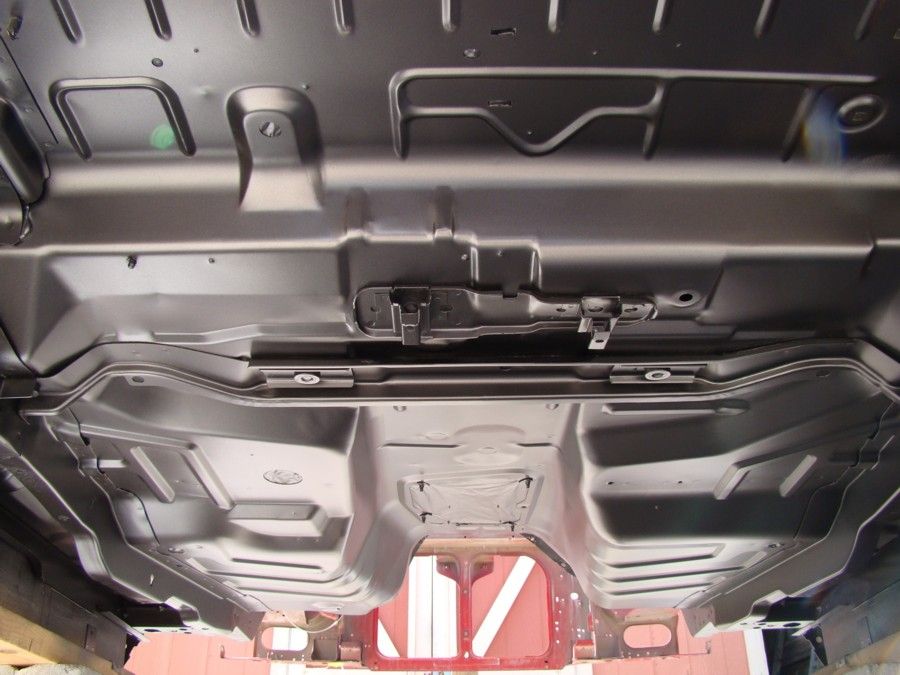

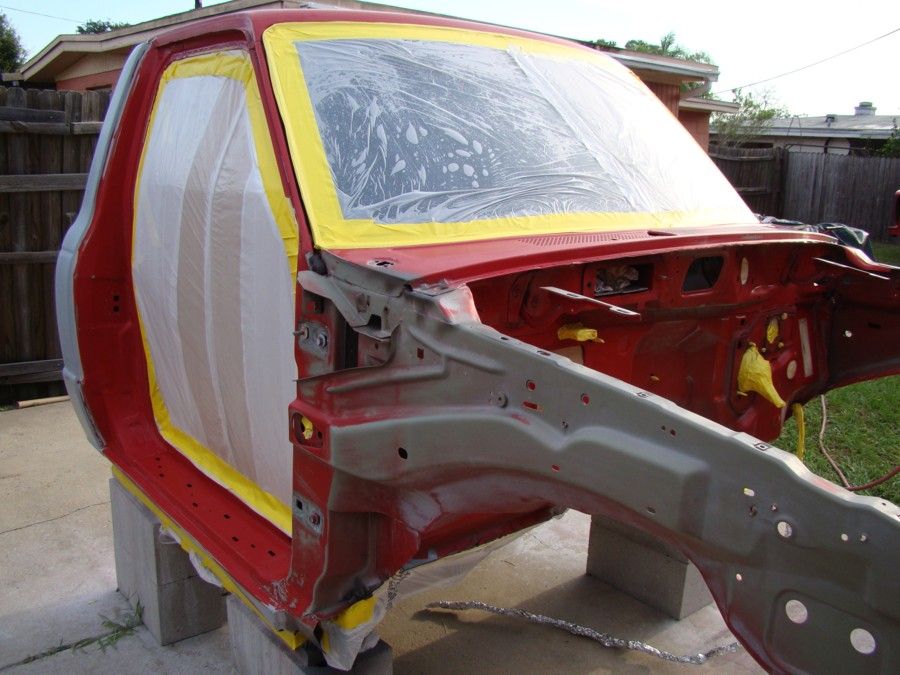

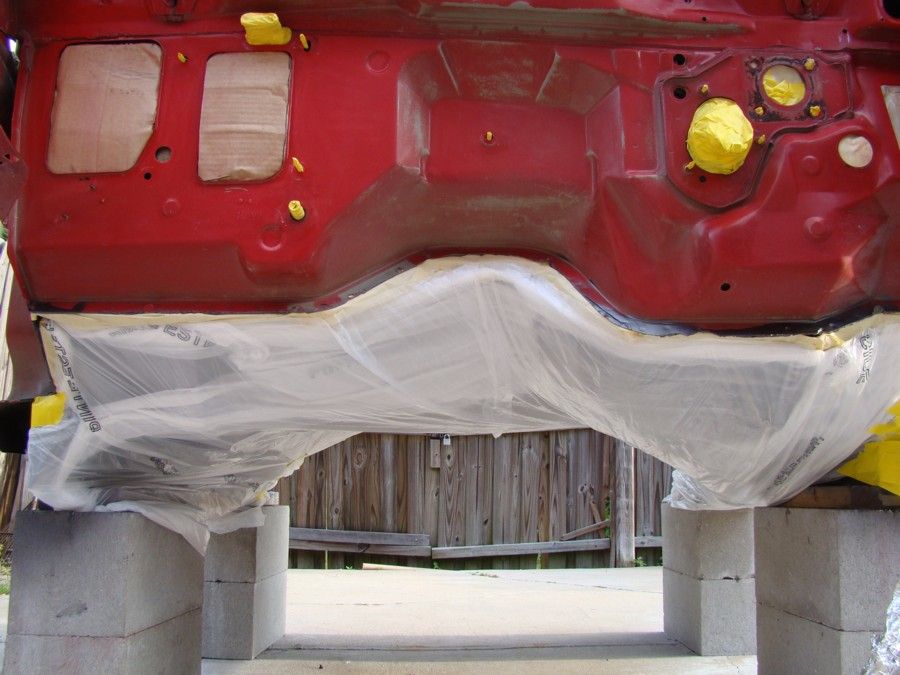

I promise these are the last photos before the truck is painted. The body work has been completed and the floor pan will be the first section to be painted. Let’s start there with a few before photos. After these two photos were taken the entire section was first washed and then dried with a clean towel. Then the floor was scratched with a scotchbrite pad and lightly dry sanded with 400 grit paper.

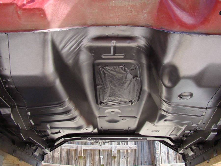

Here are a couple photos of the first section painted. The floor pan was sprayed with (3) coats of Shop-line JBP Basecoat (2003 Ford paint code CX, Dark Shadow Grey Metallic). This section will not be top coated with clear. It will be left in a semi gloss/satin finish from the basecoat color.
The engine compartment was prepared much in the same manner. First washed and then dried with a clean towel. Then the area was scratched with a scotchbrite pad and lightly wet sanded with 400 grit paper inside and outside. The entire section will receive a basecoat/clearcoat finish.
The door jambs have all been washed and then dried with a clean towel and wet sanded by hand with 400 grit paper. Everything has been removed including the door strikers and weather stripping.
