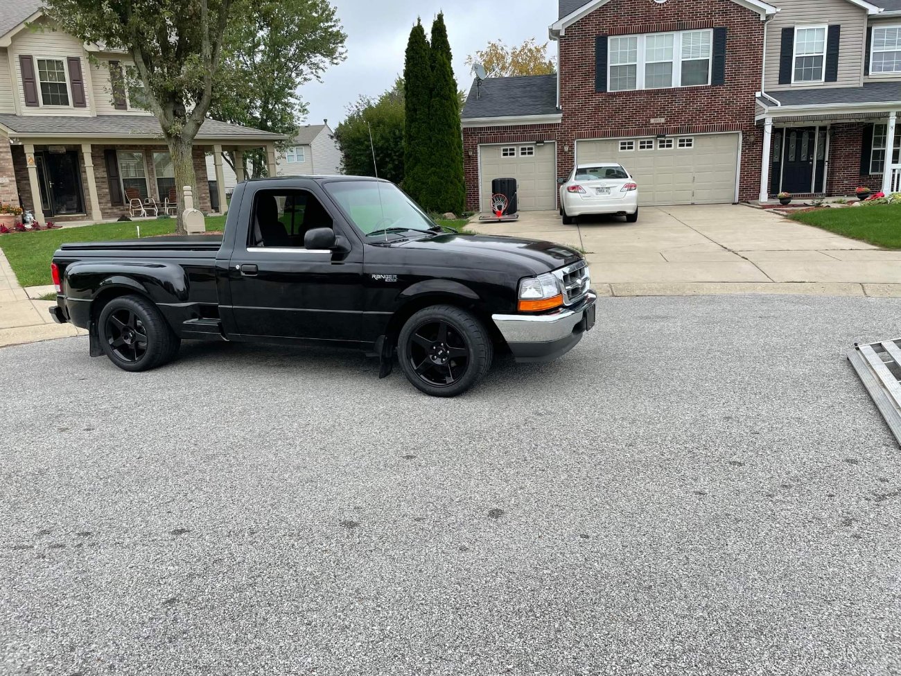

One more 2wd 98 coil spring 5.0 swap.

It is running good. I changed the spark plugs and cleaned the air filter this weekend so I am looking forward to seeing how it runs tomorrow for work. I also cleaned it inside and out along with a fresh wax. I had to spray the passenger side a few weeks ago and this was the first coat of wax on those panels.

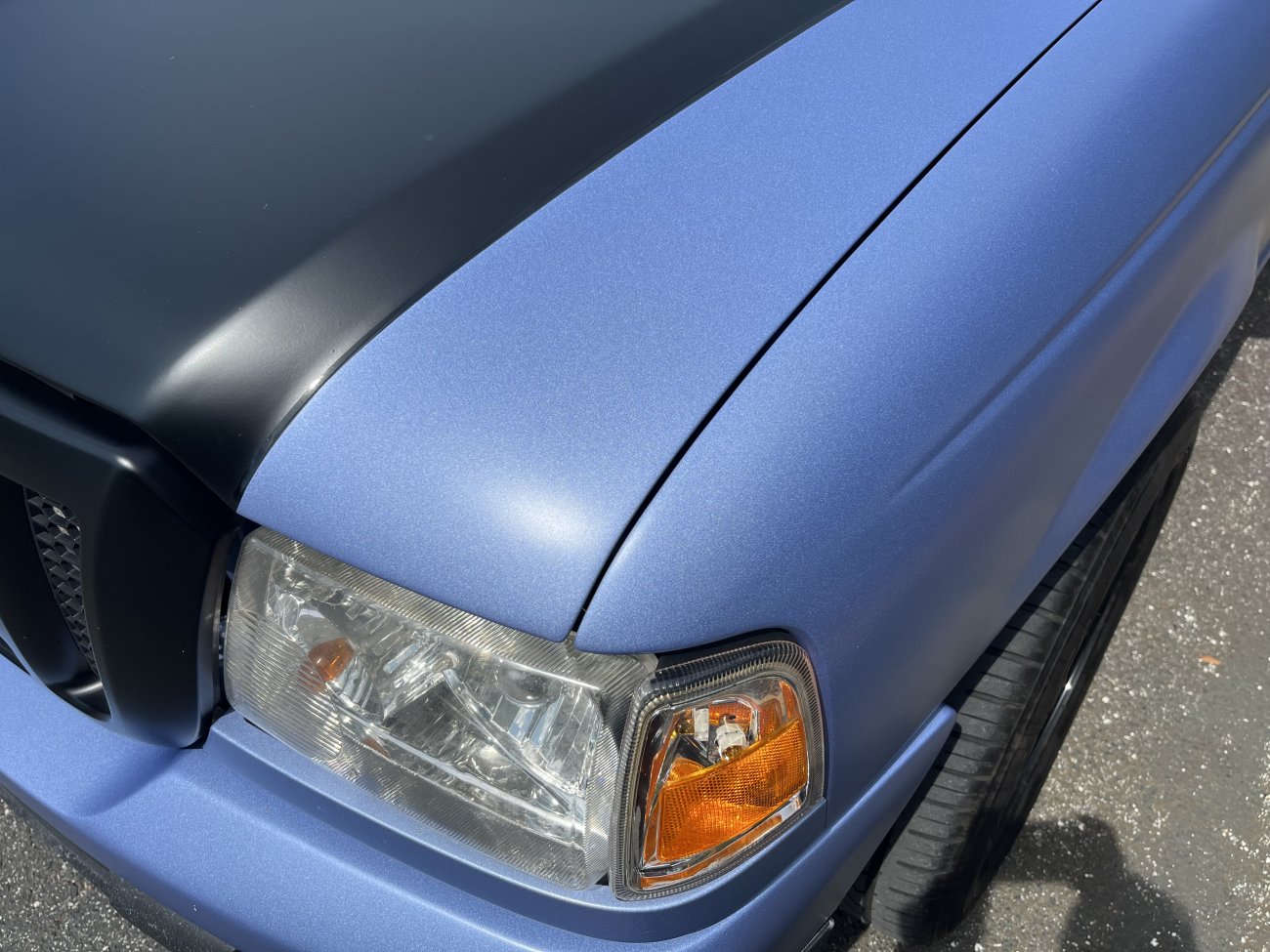

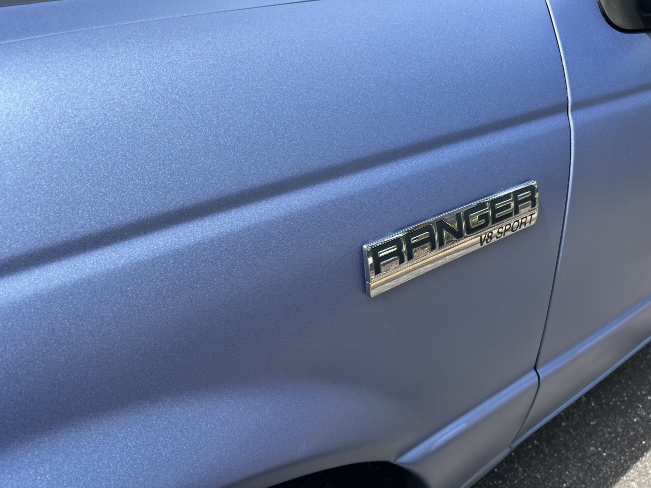

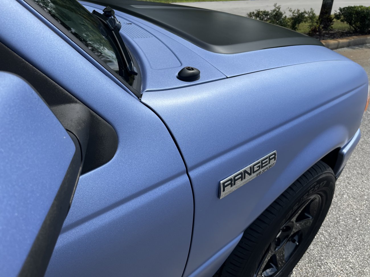

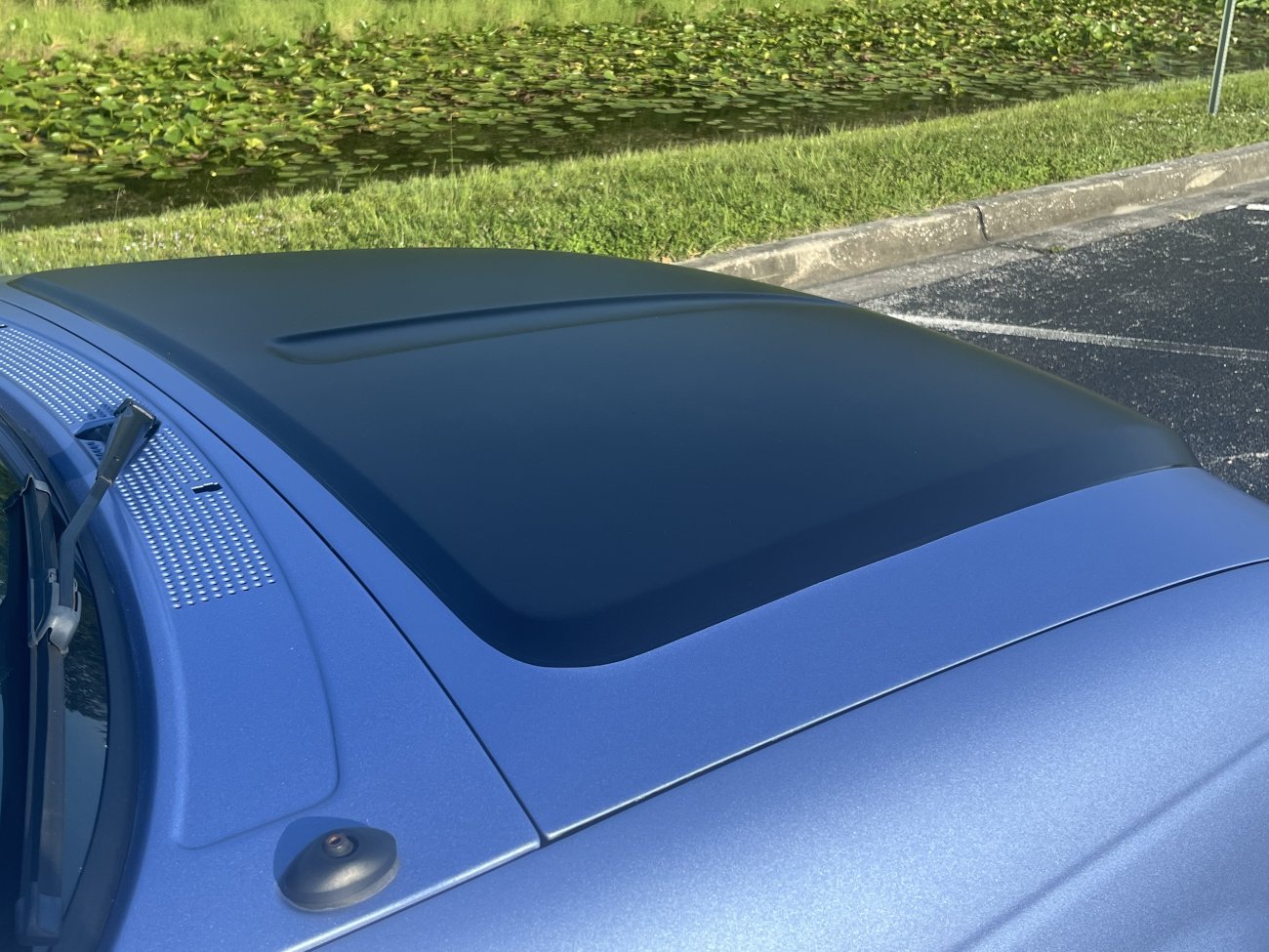

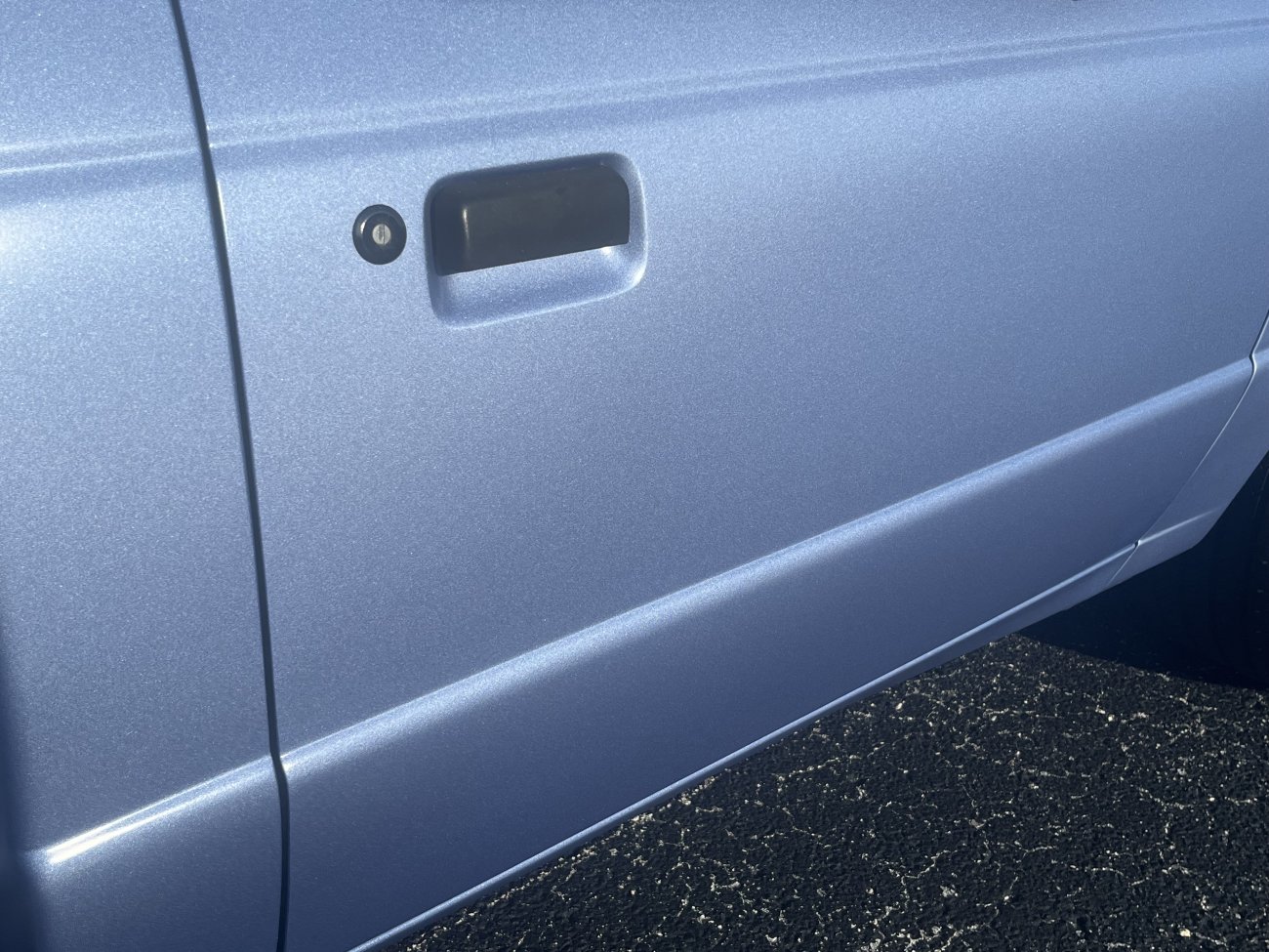

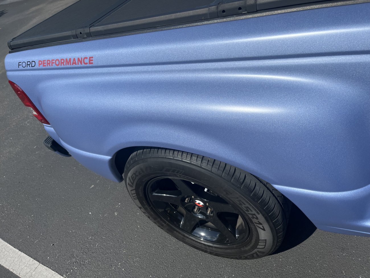

Im color blind.. what color is that? Blue or purple? I've commented on your YouTube but I guess tou never get back on there?
Did you take it apart like you did originally to paint it or?
I just bought another one to build. 2000, same as my other one but his time Im going to try to mount a vortch super charger on it with the 331. It doesn't need it but its the cool factor...lol
Good to hear from you. Yes, I did kind of fall off the sites for a bit. Life got busy I guess. The color is sort of a silver/blue matte metallic. In person it looks more like the last photo. It is holding up fairly well in the Florida sun so far. I didn’t pull it completely an apart this time. It is difficult when it runs five days a week. I have 2 pair of quarter panels so I painted the extra set off the truck ahead of time. Then I prepped the cab one weekend and shot the cab and assembled it all the following weekend.
