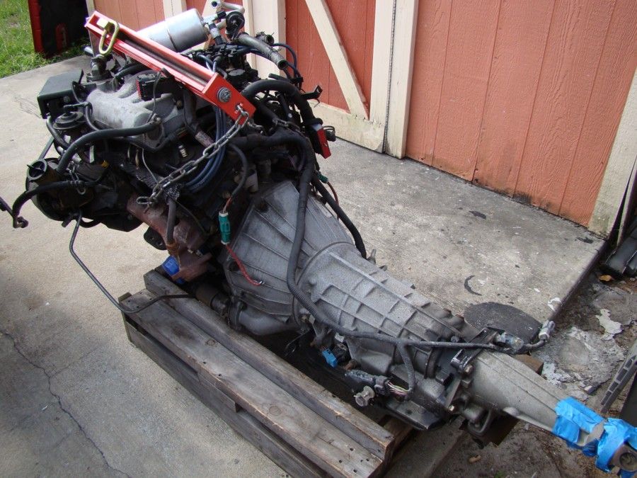

The 3.0 V6 with auto trans is now out of the truck and up for sale locally. I still haven’t had a chance to clean things up after removing the drive train but hope to start pulling most of the misc items from the engine compartment next week. The new goal is to have a completely empty engine bay by May 31, 2013.

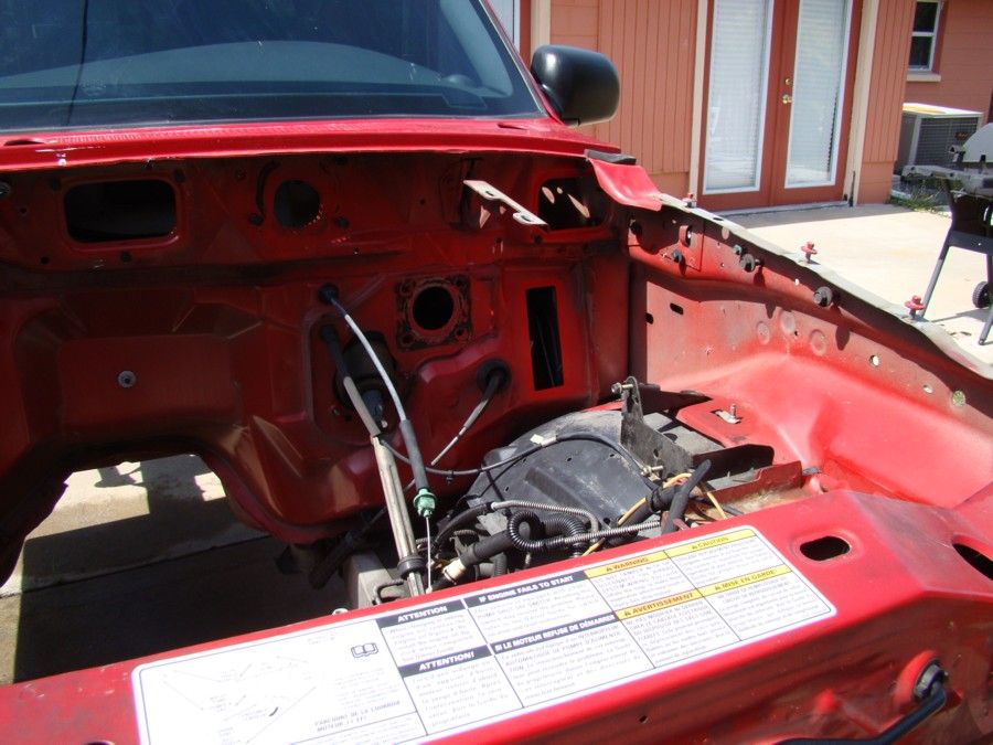

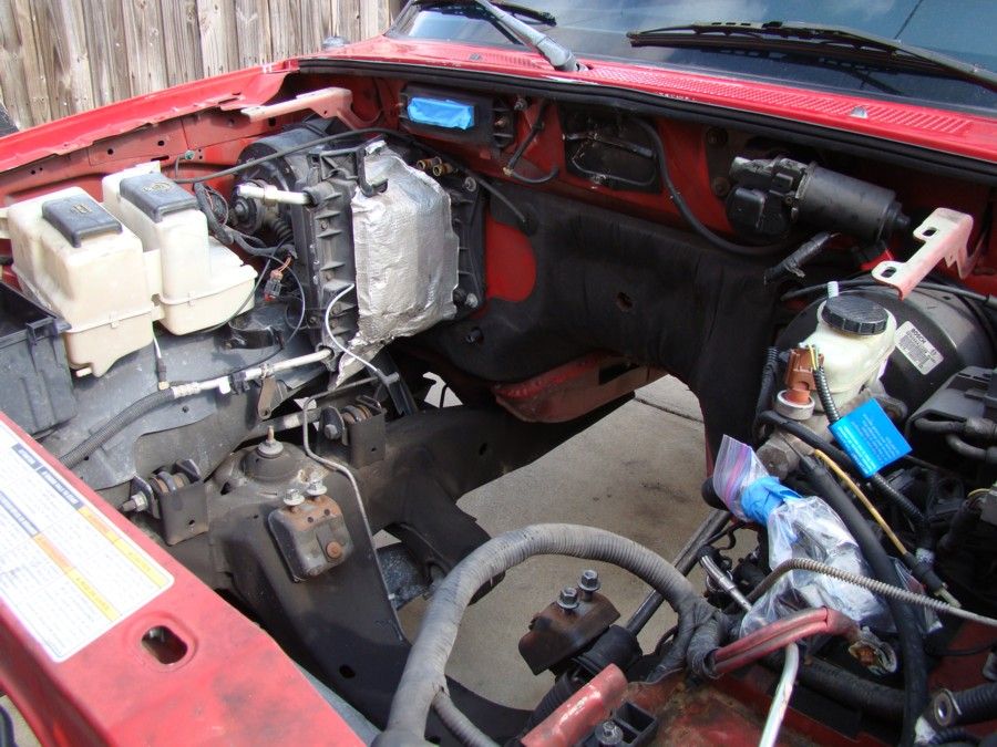

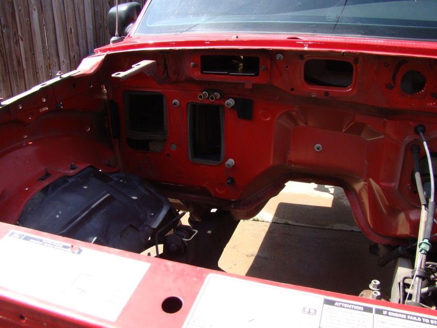

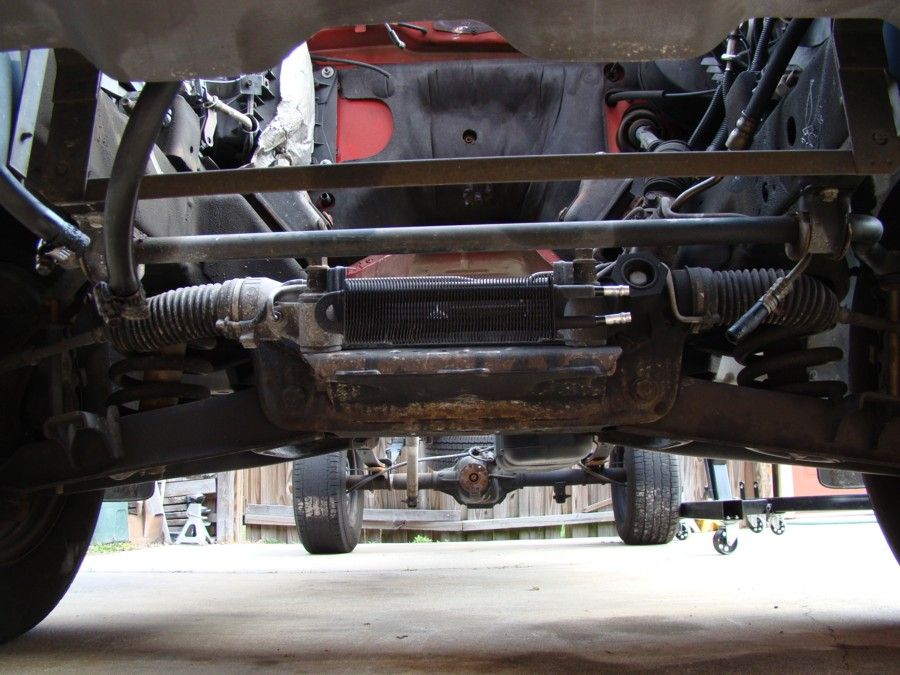

The engine compartment is now almost completely empty. I still have the steering shaft, inner fender wells, A/T shifter cable, hood prop rod, and hood release cable to remove. The brake lines and fuel lines that remain will be tied off to the fame rail and removed after the body and frame have been separated.
All of the fasteners were temporarily returned to their original location where they could be photographed and individually labeled, removed, and bagged to make assembly easier when the time comes.

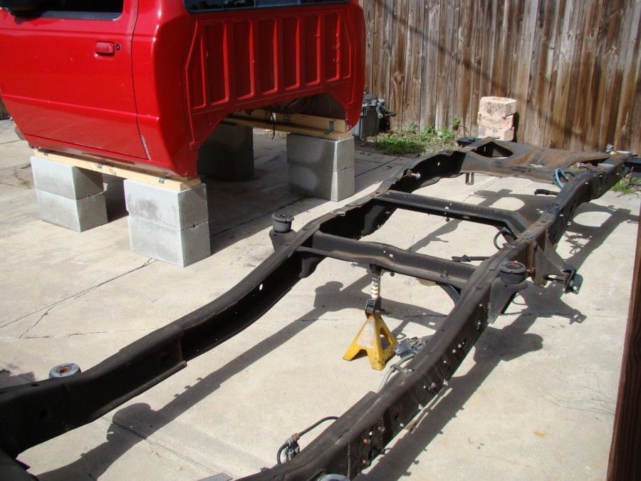

The frame will be coming out this weekend. It will be going to the media blaster around July 6, 2013. I should have more photos and details soon.

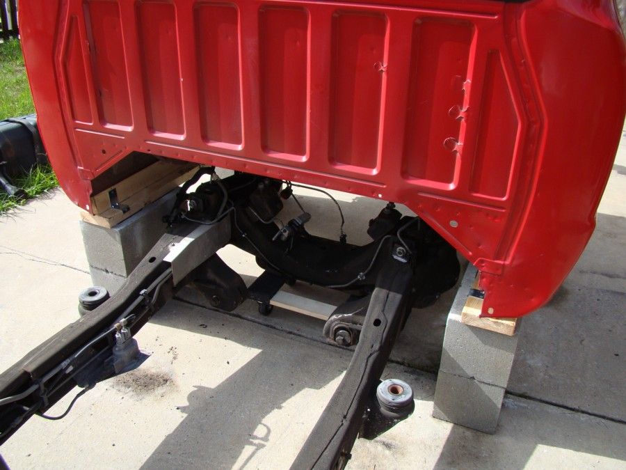

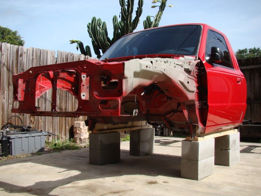

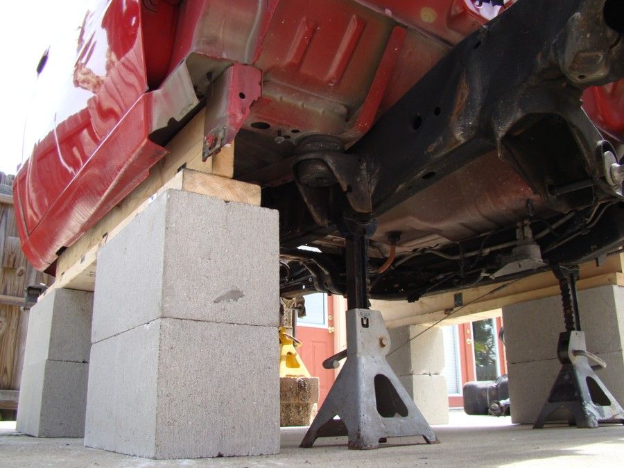

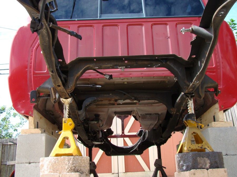

Other than a couple simple last minute items (frame/body strap, frame/body harness plug, emergency brake cable) the frame has been stripped of all misc. pieces and is ready to come out. The frame and body have both been supported separately with plenty of room to spare to allow the frame to be dropped down and pulled straight back and removed from behind the cab. To allow easy access, the fuel lines, brake lines, frame wiring harness, and motor mounts will be removed from the frame after it has been separated from the body and placed on a solid work surface. Tomorrow morning the two components will be separated and the frame will be prepped to go to the media blaster.

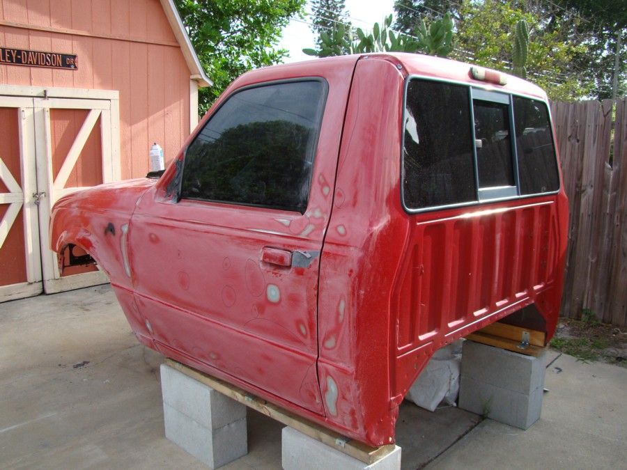

Going!
One more 2wd 98 coil spring 5.0 swap.
Going!
Gone!

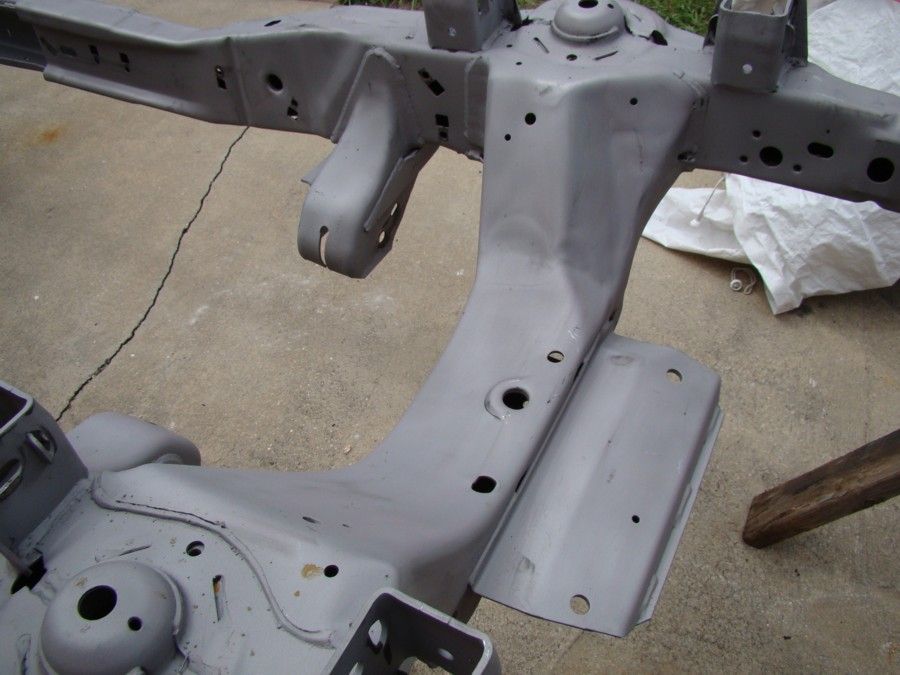

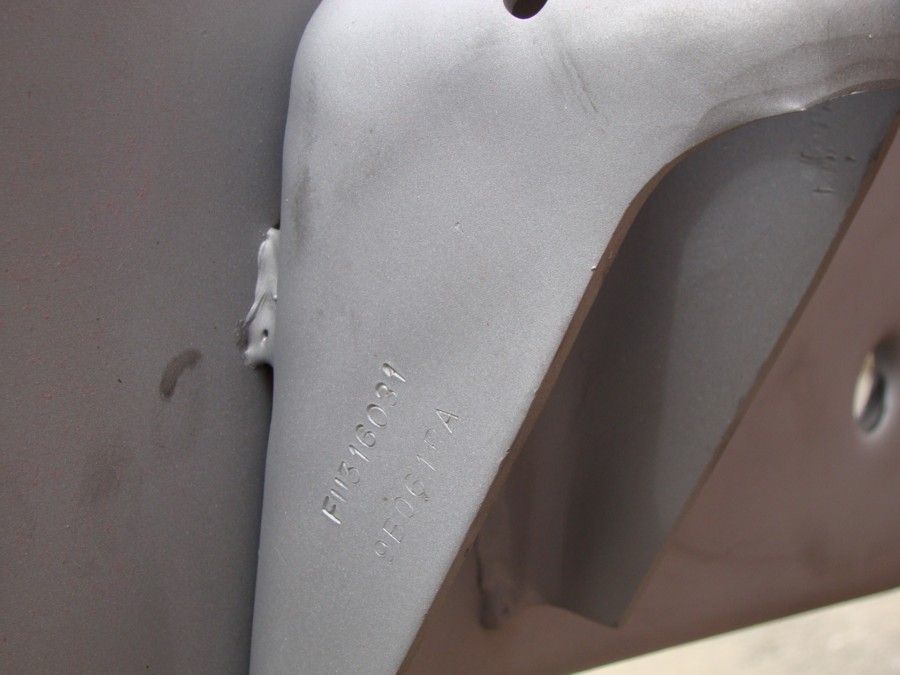

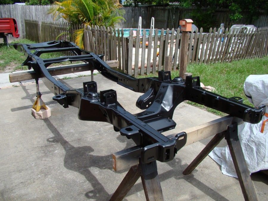

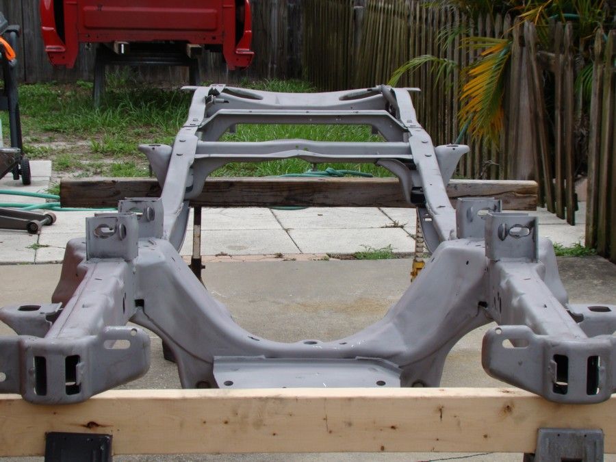

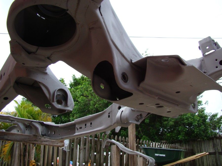

I picked the frame up this morning after being media blasted. Once I got it home and unloaded I set it up on jack stands and a saw horse and went to work. I used compressed air to blow the remaining media from the recessed areas and then washed it down completely with wax and grease remover. I feel the media blasting company did a very good job knocking down every last sign of paint and debris.

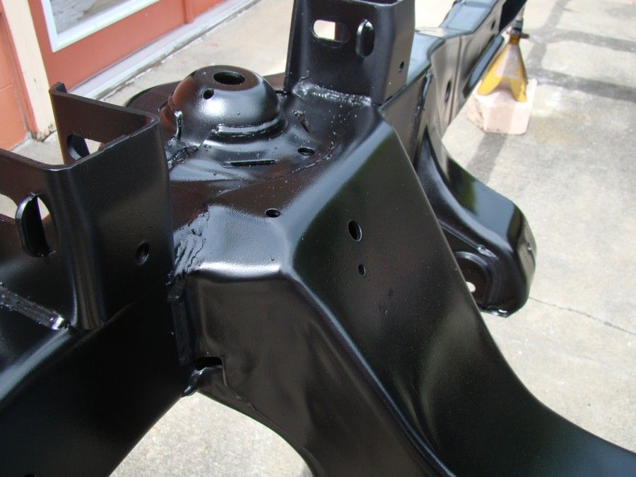

After the two coats of epoxy primer were applied I shot two coats of OEM Ford Black over the entire assembly. I took my time and worked the paint into all the recessed areas as much as possible. After allowing proper dry time between coats I flipped the frame between each coat of epoxy primer and paint making sure the top and bottom of the piece received even coats.

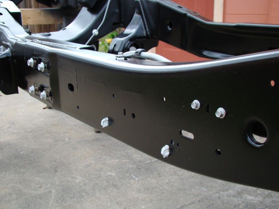

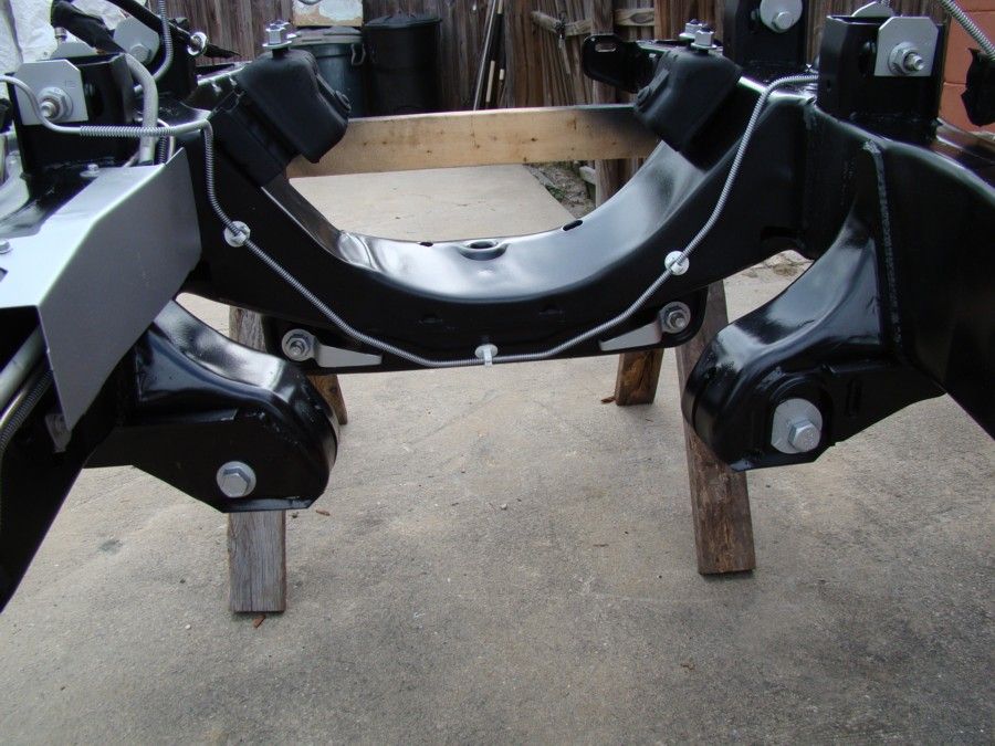

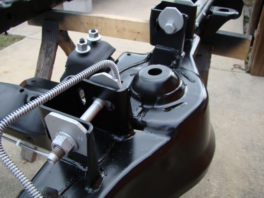

I spent this afternoon cleaning and installing the brake lines and fuel lines along the driver side of the frame. I should have all of the basic fasteners back in place and the frame finished this week. I hope to have the cab painted by the end of August so the frame can be bolted back into place.

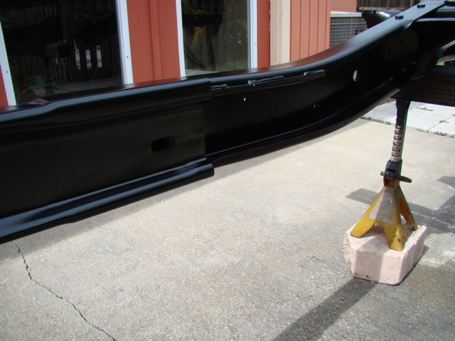

The frame has been reassembled except for a few pieces that will be attached once the body and frame is joined. The charcoal canister, fuel tank, suspension, etc. will all come into play at a later time.
