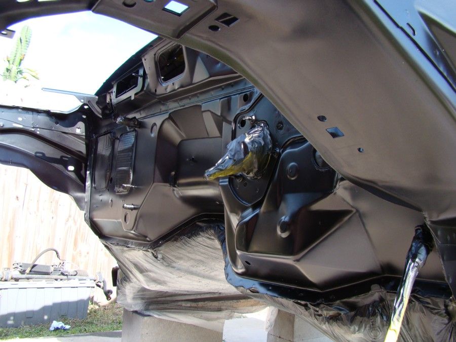

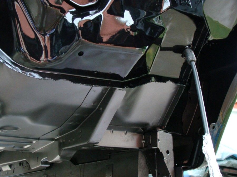

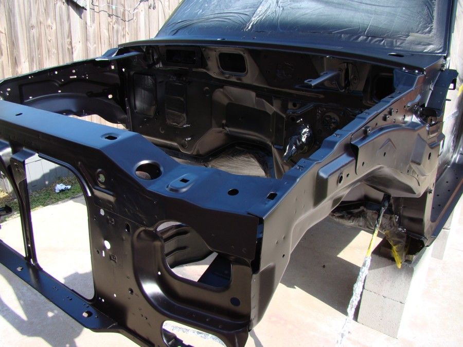

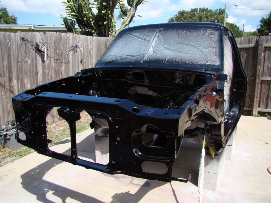

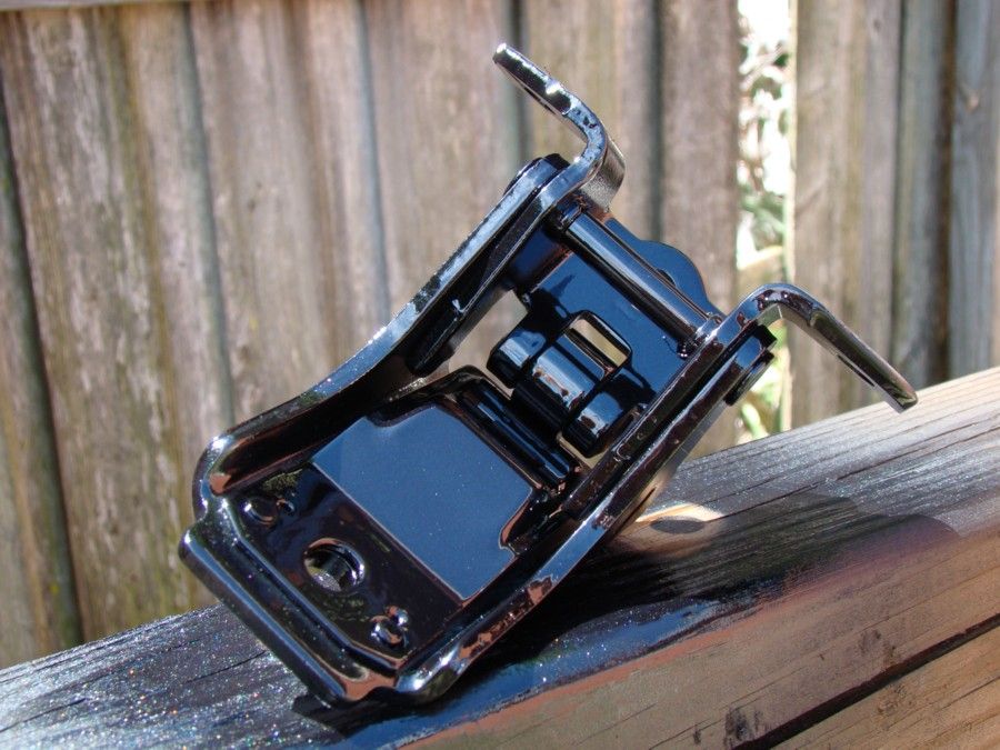

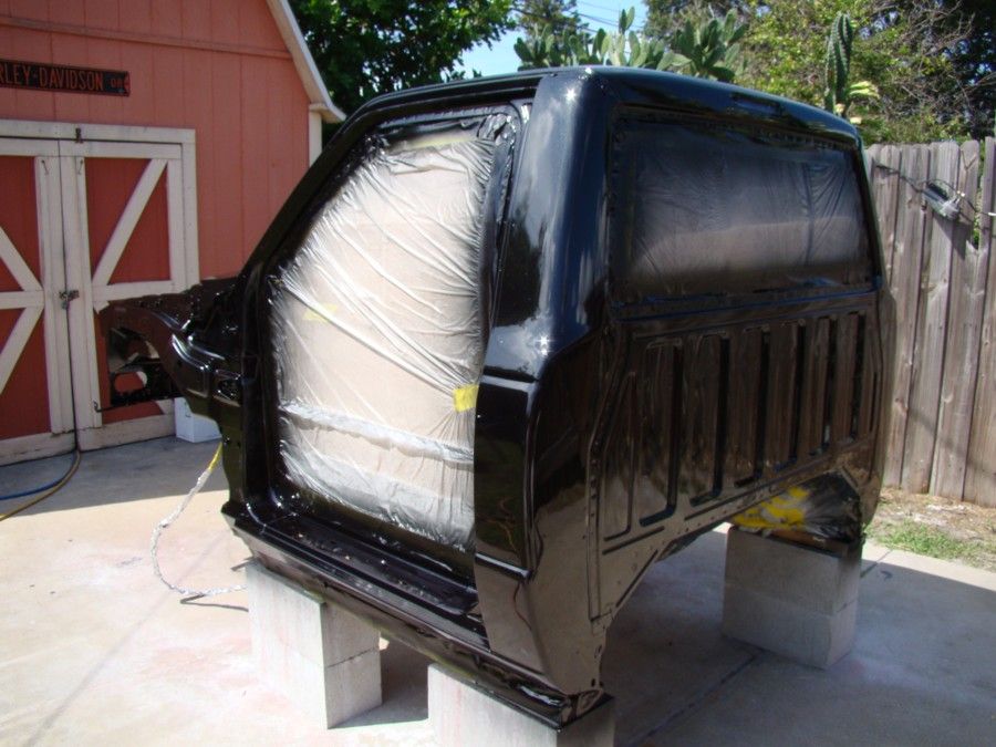

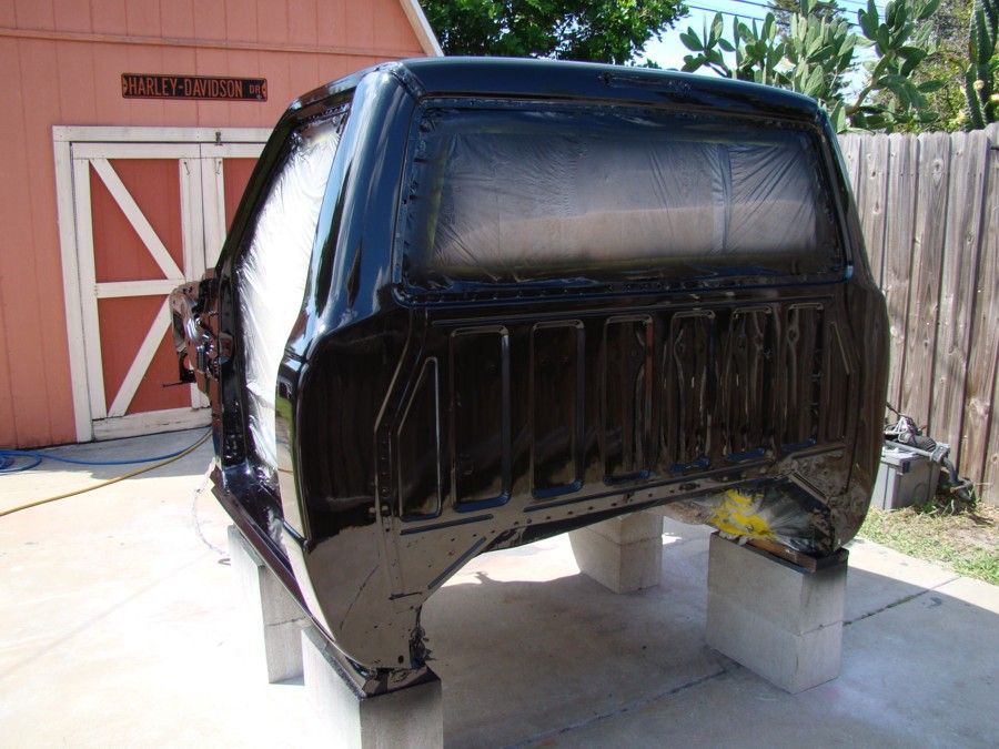

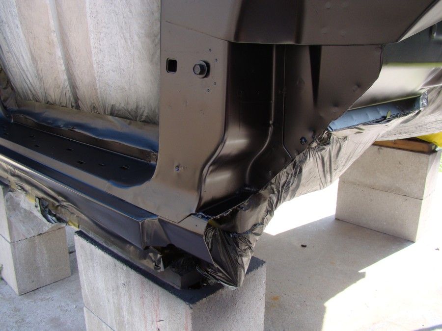

The cab and jamb section of both doors have now been painted with (3) coats of Shop-line JBP Bascecoat (2013 Ford paint code UH, Tuxedo Black Metallic).

Be back in a few minutes when the clear is down!

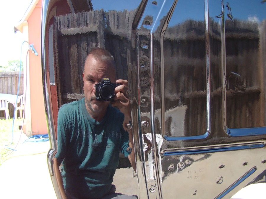

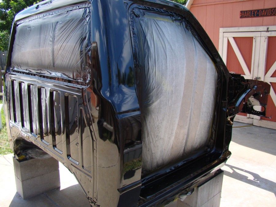

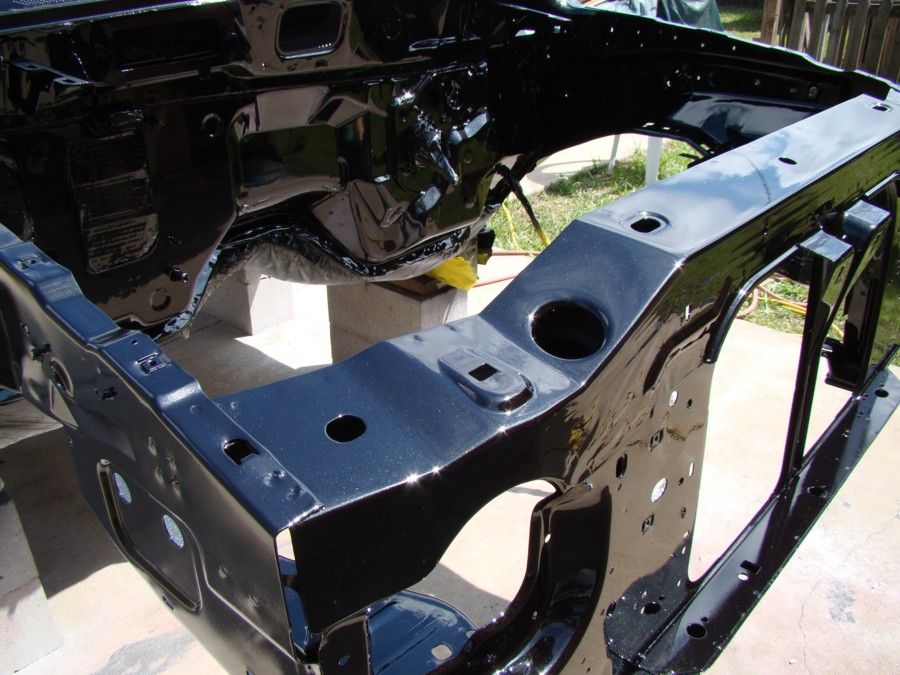

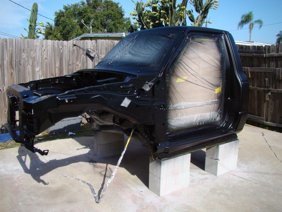

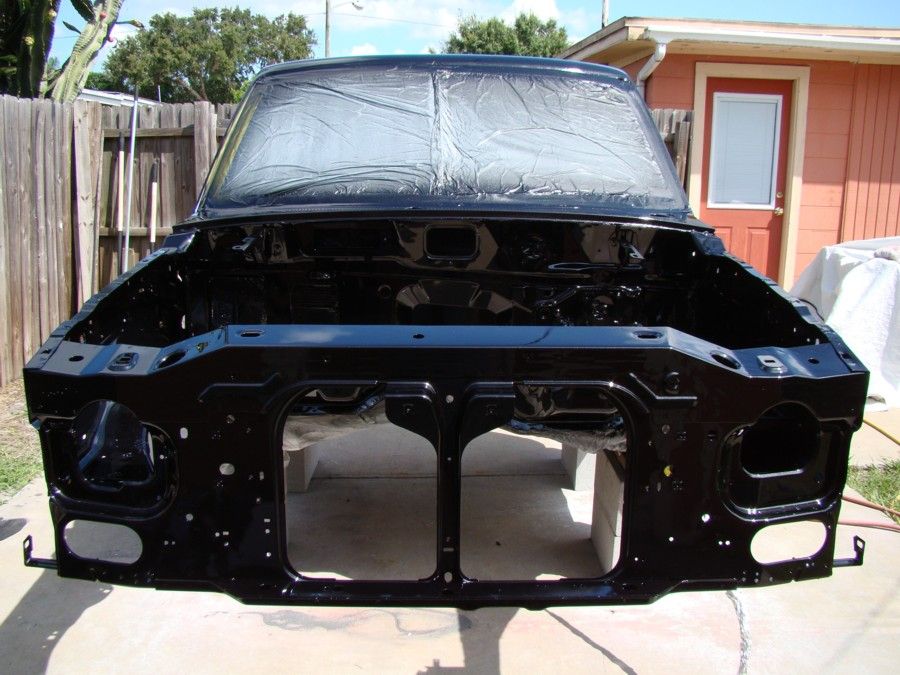

The entire cab and doors have been top-coated with (3) coats of Shop-line JC 630 Urethane Clearcoat. The clear is only minutes out of the gun at this point. It has not completely flowed out yet and should continue to move slightly over the next few hours as I used the ultra slow catalyst.

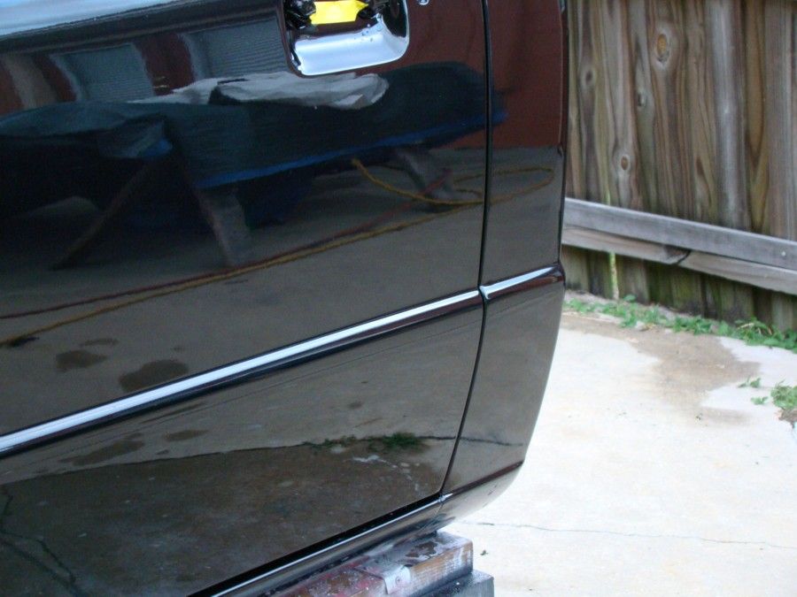

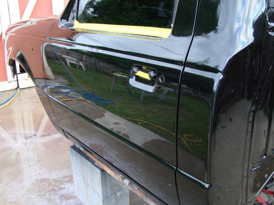

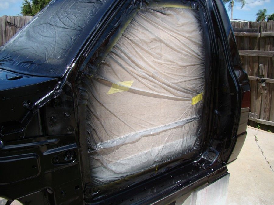

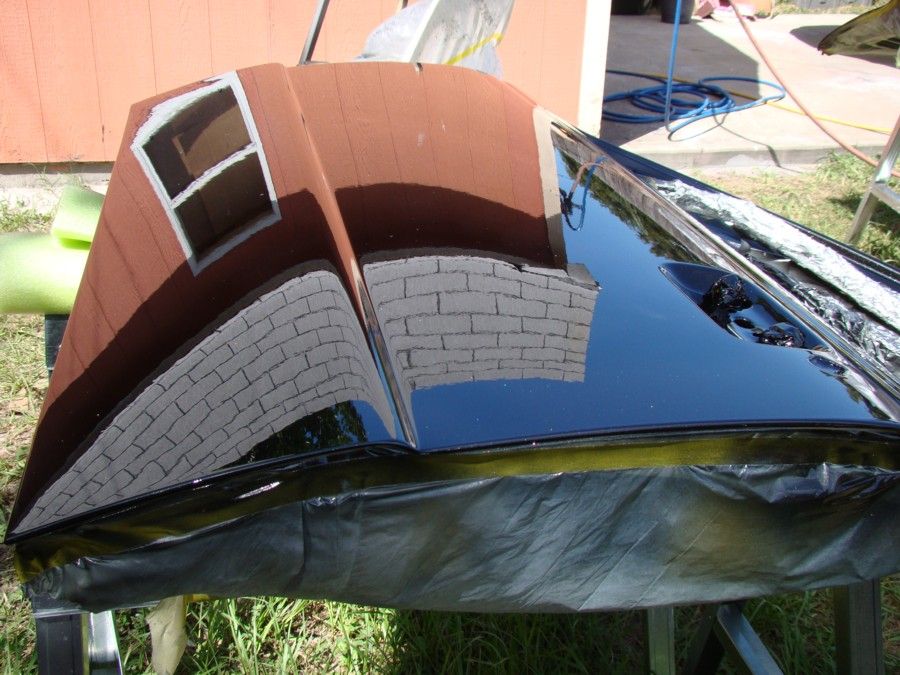

Early this morning I sprayed the outside of both doors and fenders. Now they just need to dry for two days and I can go ahead and hang them back on the cab. I can’t wait to get the cab weather tight. After the doors are hung the solid rear window will go in next weekend. Just a quick color sand and buff around the window opening and I will be good to go.

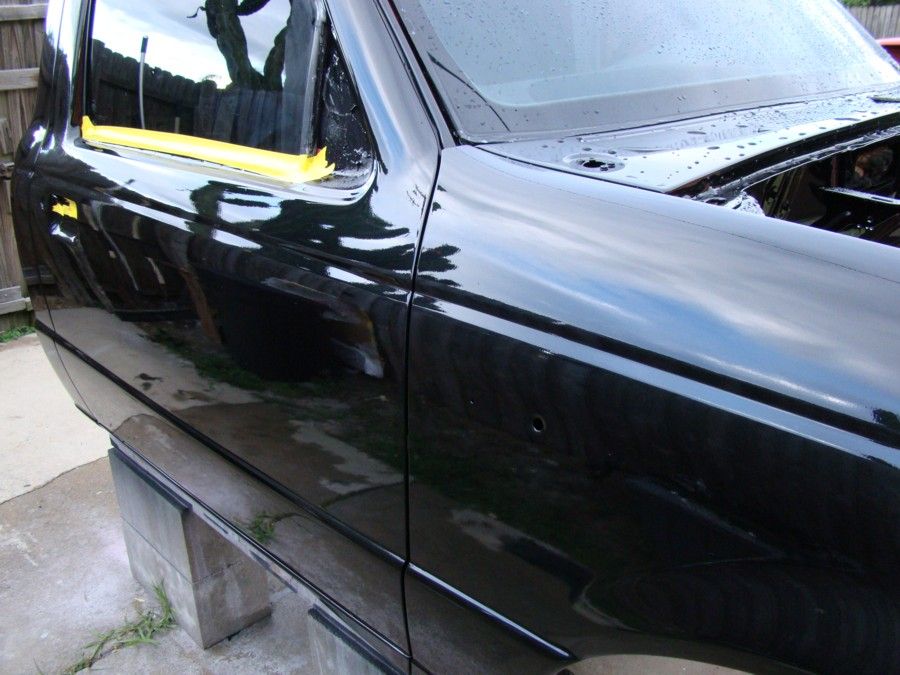

I managed to get the sheet metal hung today and aligned. I also got the windows rolled up and the doors “sealed” so no rain should get inside the cab. I am still working between the rain drops trying to get a little done each day as I am able.

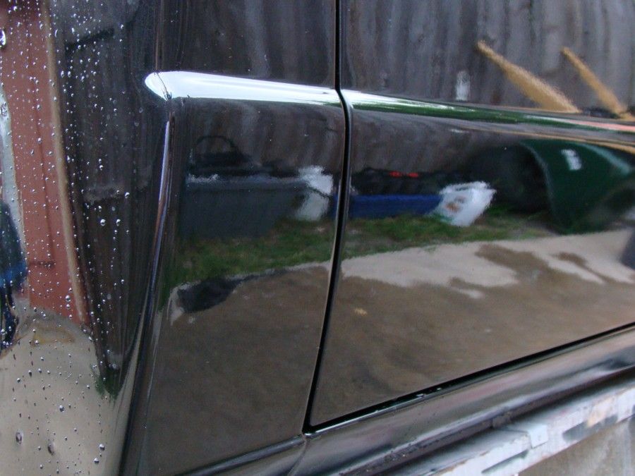

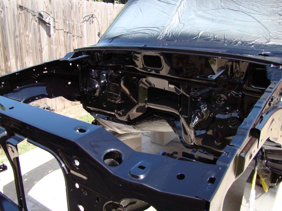

All that hard work is paying off, looks like a sheet of glass, as it should...
SVT
SVT

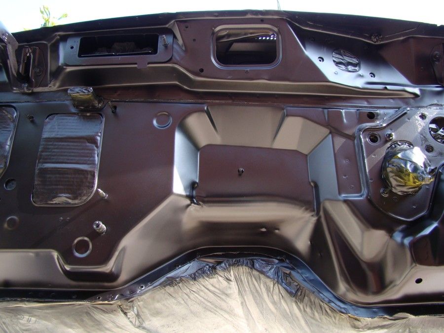

I can't wait to color sand and buff it. I am pretty excited to see it at that stage. It will have to wait a while until the wiring and the frame is back in place. That is the next step after the rear window is installed.

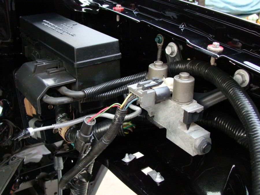

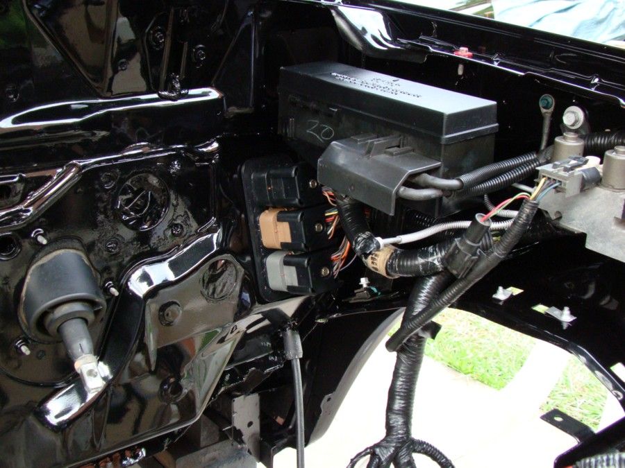

After dropping the pistons and connecting rods off at the machine shop I went ahead and continued running the wiring harness through the engine compartment and attaching several misc items/pieces to the firewall, core support, and inner fenders. If all goes well I should be ready to install the frame this weekend.
