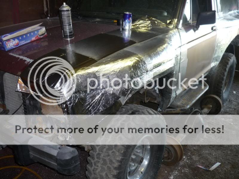

So I get nearly 4 fenders for the price of one. ($150 plus $75 shipping per fender)
thats the beauty of knowing how to make your own composites.the curse is perpetually itchy arms and the nasty chemicals.
120 cubic feet to a half gallon? do you mean cc's or cubic inches?:icon_twisted:
your estimate sounds good on the resin but i don't use much mat since its really for boats and cars(too heavy for planes,and i get woven glass for bulk cost).it definately soaks up a lot of resin.
it may sound stupid but you should wear eye protection when mixing in the cataylst for polyester resin.its very thin and splashes easy and is by far the most deadly chemical that they have at the aircraft shop i worked at.less than a drop is enough to permanently blind you.and GLOVES,gloves gloves!
as far as the mat,you might wet out a sample once you figure out how many layers you want so you know how thick it will be before hand.

got bigger pics? did you finish the panels or is that the plug ready for layups?
:icon_thumby: i was thinking to myself god damn he works fast if those are the finished product.how'd you fill the foam?
