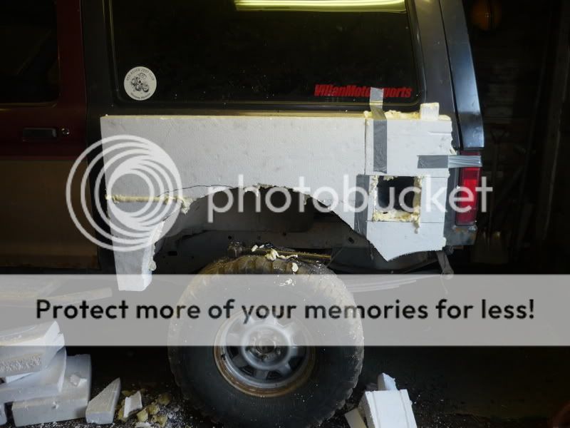

Rear progress
OhhhhhhhKay
If you are going to be producing these i would like to be on the list for a set of rear ones please

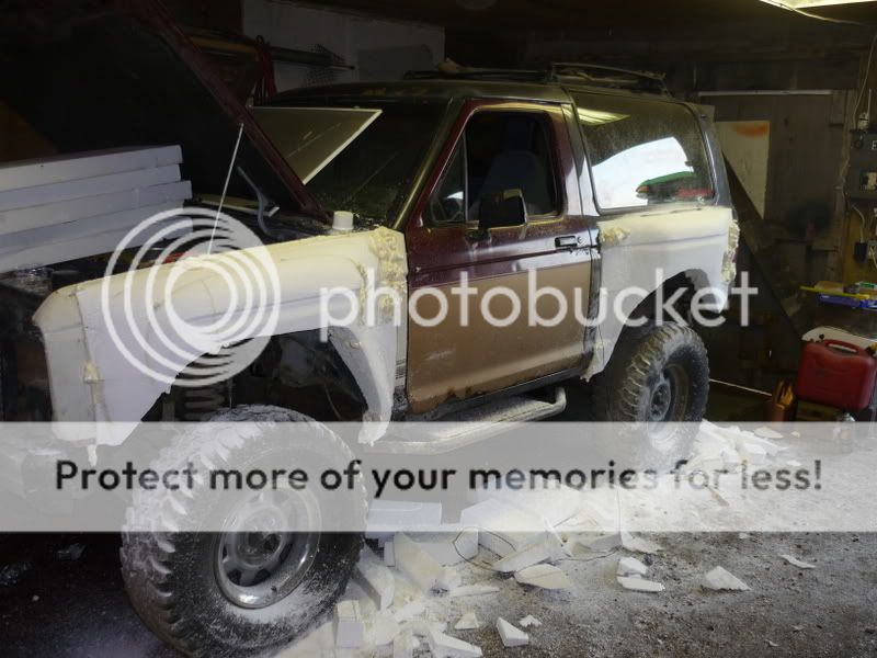

i dont like the front ones, you need to make it flowout not just pop out, its ugly the way it is
or it looks like a fender flair

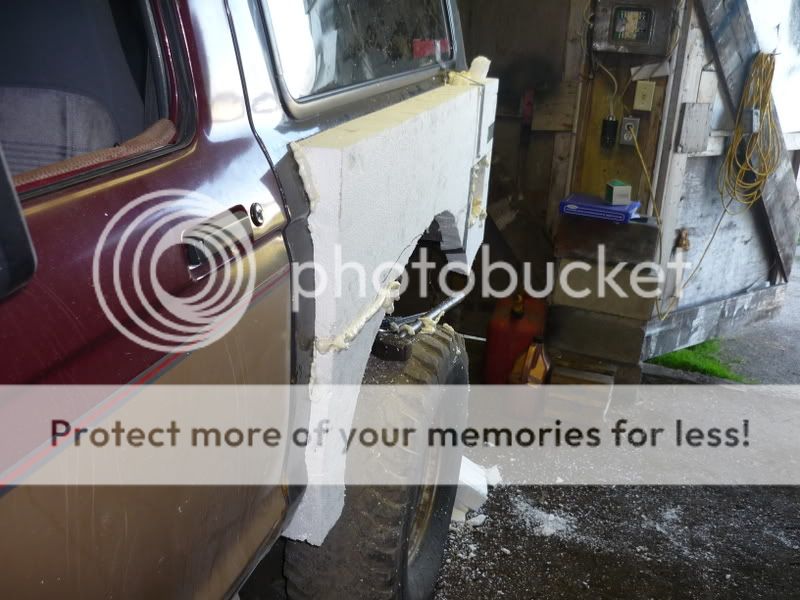

Here is another pic to keep the interest tickled.
