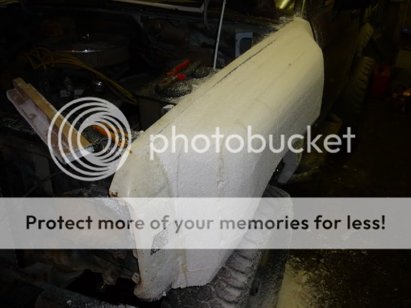

Building things out of 'glass is easy. It's also easy to build glass things that look like shit. I would just put the stock fenders back on.
well the buckets turned out tits, so i would bet the fenders will be unique and tits too.
and if they are not....
dont make me come up thar laddie....:thefinger:
oh i am sure they will be cut in to the mold and it will be strong as hell...
If they turn out like ass then I didn't try that hard. If I fail i put the stock fender back on.
Easy as that.
I may put some tube inside them to give extra support. I was thinking of leaving the foam inplace, but I may just chip it out. to leave room for some extra support.
are you using epoxy or poly resin? what cloth weights?are you making one time molds or using gelcoat and micro bubbles to stabilize the mold?i built aircraft molds and prototype parts for a few years,feel free to run any questions you may have by me.
the best thing for wheeling might be to just make skins and pop rivet them on.also if you leave a strip of foam(maybe 2"x1" cross section) around the wheel opening on the inside and glass it in it will add a lot of stiffness.composite airplane wings and surf boards are built on that principle.
if you don't want them to sag in the sun later you should precure them by wrapping them in black plastic and setting them on some hot asphalt while in the mold.they can reach 170* in the sun (in california anyway)
polyester resin shrinks real bad so you might make them 1/4 inch or so too big if thats what you are using
Likely 16 oz. chopped strand mat. total of 3 layers (about 3/16 total thickness). Low shrink Polyester resin.
