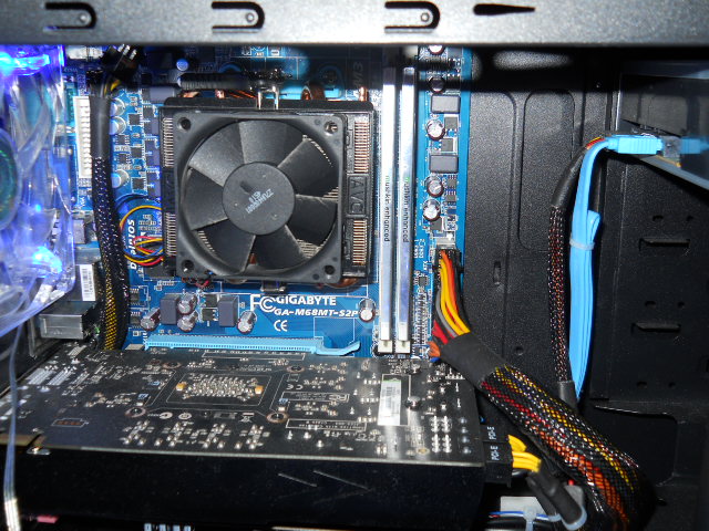

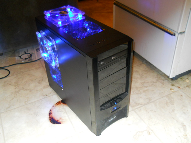

Here is a quick pic of what the case looks like with the fans mounted outside the case. Not the greatest pic, but i had to take something lol. I forgot to take a pic of the cooler installed, but i will get one when i install the thing permanently with the 2 fans

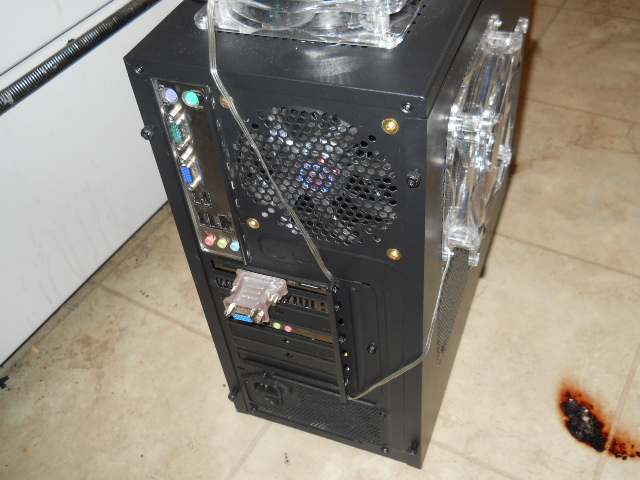

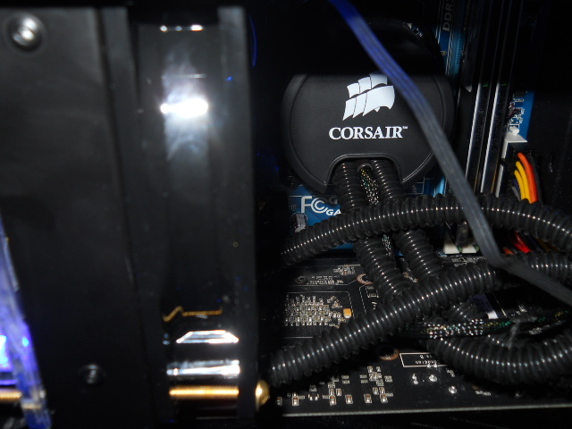

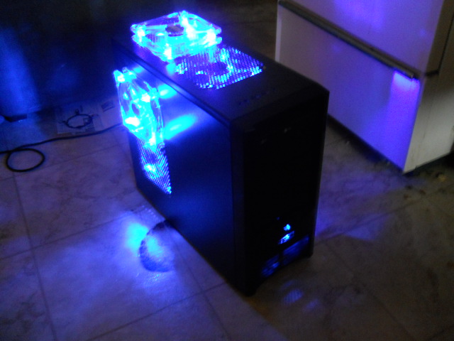

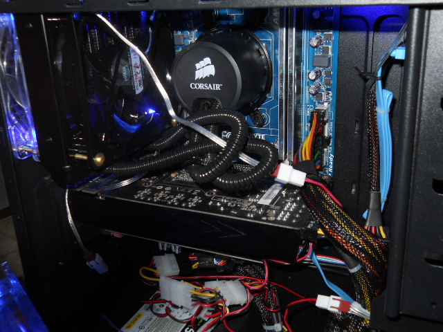

Below are a few pics of how it looks now, you can see how nice and tightly the extra fan ended up in with the block The other 120mm fan i got turned out black coloured with blue LED (I thought i ordered the same clear ones as last time), But it blows harder anyways and i mounted it inside on the rad. I think it looks better than a clear would have, and it still lights up to fit the blue anyways. Like i said before, i couldnt fit my huge fans inside the case with the radiators and even more fans, so i have them mounted the same way just on the outside of the case. I love how it looks lol, like a muscle car with the huge blower motor coming out the hood :headbang:. I also included a pic of the back so u could see how i ran the wires since they had to go inside the case somehow lol. i dont think that looks too bad either.
