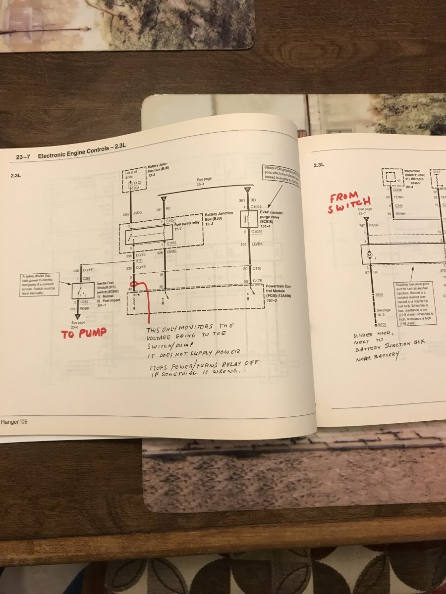

unplugging the injectors affecting the fuel pump voltage is not "logical", unless the computer has issues.
take a close look at the connector & wires.
check the voltages at the fuel pump relay.
this is from a 2005 manual, should be similar to your 2007.
