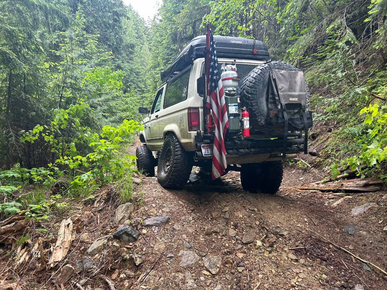

I haven’t weighed it this year. Since the V8 this winter but I don’t think it’s changed that much the diesel and SBF were pretty close to the same weight. It was over 6,000 pounds, with my tent and everything in it, it was lighter this year, no RTT, not all the camping gear. Idk, I just want it a little more stable. I’m going to build bumpers, rear bumper simple and light, front bumper I’m going to put some weight into it, but nothing extreme. I think I just have to tune the rig a little more for what I’m going to be doing with it. I didn’t need, my spare, or all my crap on the rear. Here’s a video of me climbing haha

Ok, I just watched that... Throughout the whole video, but especially the first 3-4 seconds, your passenger tire is totally steered left, and your driver side tire steered right. That is 95% of your problem right there... Your tires are fighting against each other.
You need to go look at that steering page I linked here a few posts back.
I would not go a step further with anything else until you get that straightened out first.
