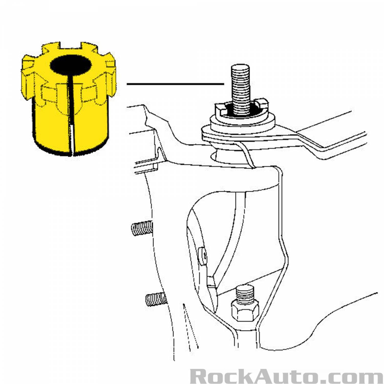

That is the 4wd bushing. It does come out the top. I can't find anything on the 2wd. Do they use the same like later models?
Unless you bust the balljoints loose, I don't think it's coming out. I believe that is what the frontend alignment guys do when they need to turn it. They hate these twin I beam suspensions.
The setup you illistrated is a 4 WD, for the 2wd, the baljoint is upside down and the bushing comes out from the bottom of the upper ball joint. same problem,different orientation.
