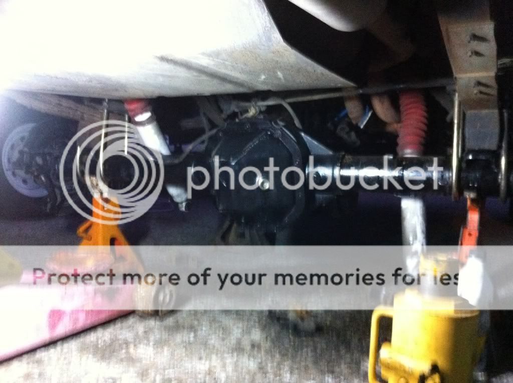

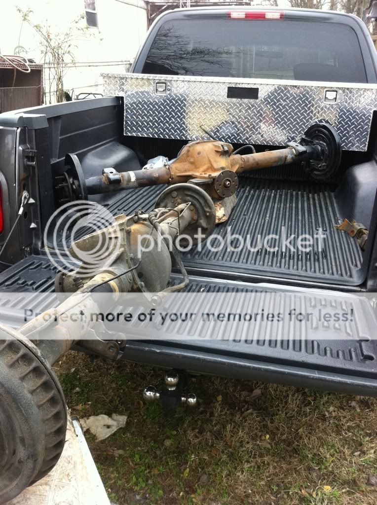

Both axles out...
8.8 under.. Not completed tho. Brakes shocks wheels coming soon.

so shocks are mounted.. everything is finished except brakes.
my dad tore apart the calipers today to clean them, one was frozen up.
only thing i need to finish (other than dad to show back up w/ my calipers) is one passenger side brake hose. need 2 passenger sides to make it work w/ what i have. i'll list it all out when i'm finished w/ the swap.

welp, its on all 4's.. drove it twice so far.
my drive shaft is vibrating a little, no biggie.
thing that scares me is when i first let off the gas and the truck is coasting i have a noise. why? any reason this could be?
i love the 4.56 combo w the 4.0 and 33's!! its perfect gear (or so it seems, i've only drove it twice)

4.56's are bad ass. And so are 4.88's (what I'm rockin' :headbang:).
What kind of noise?
