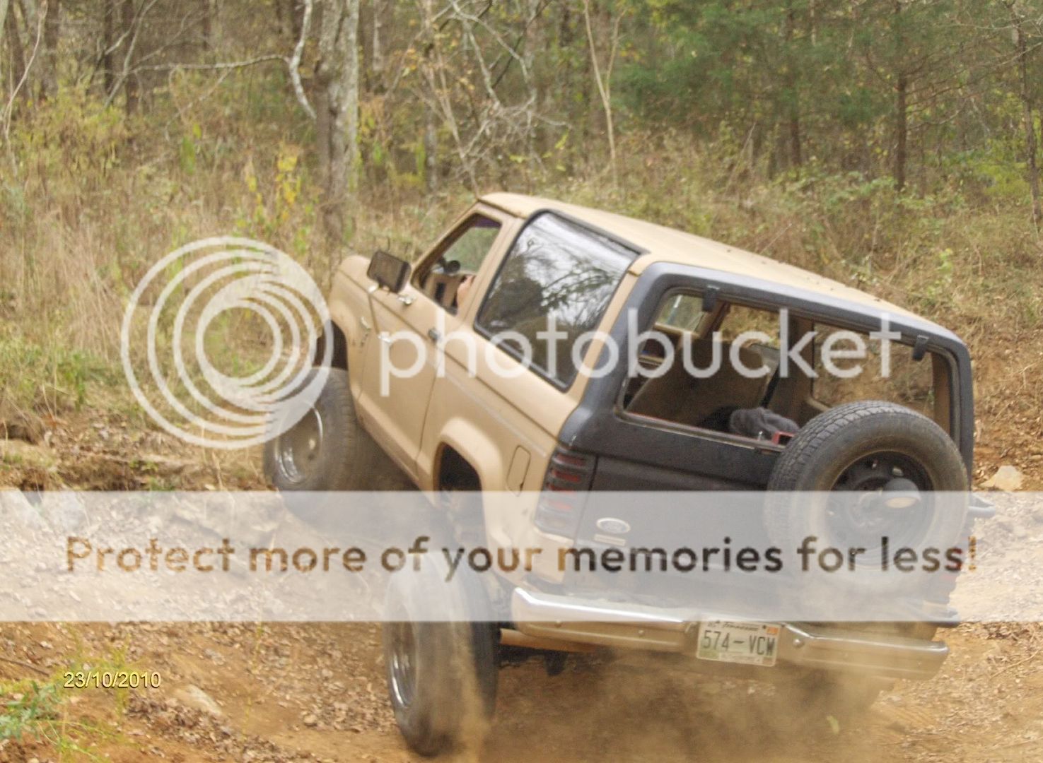

Mine flex really good. They are just stock 2 leaf rangers with another ranger main leaf with the ends cut off. I placed it under the main leaf.

I have Explorer leaf springs and stock shackles, I still have my lift blocks though....I could get a little more with some shackles but I'm happy with the rear for now, I just need to get the front to stuff....:annoyed: Here is a poser shot! :icon_thumby:

Thats quite a bit of flex out of exploder leaves I will say.

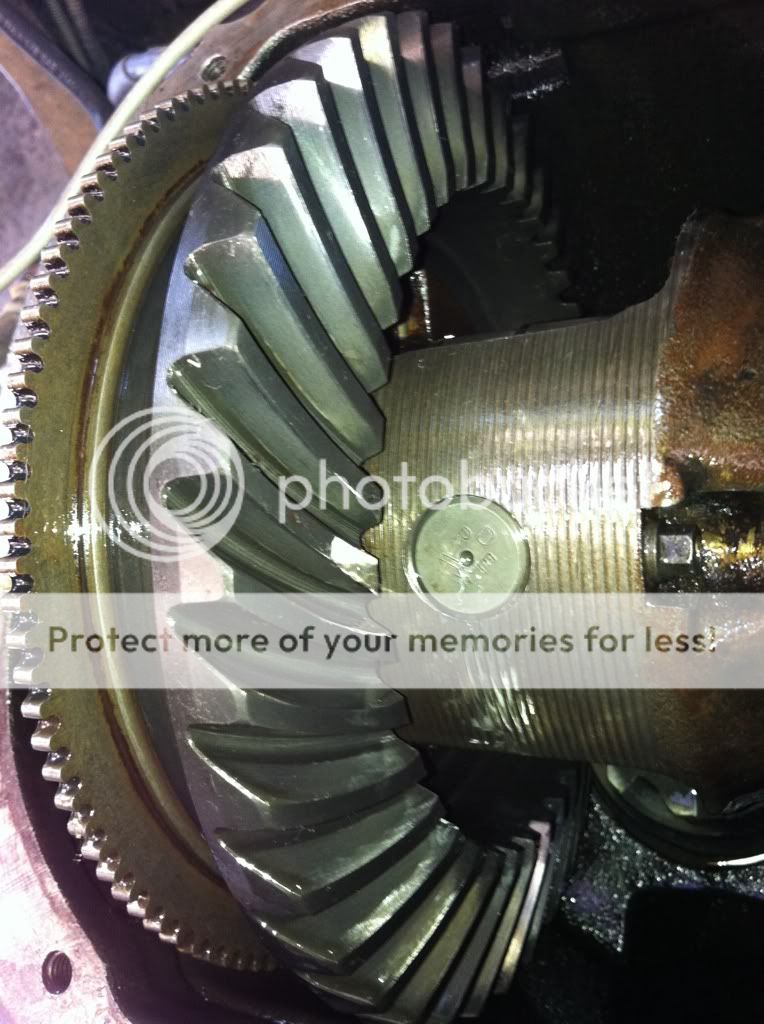

my trip puts me at 550 miles on the new gears.. which means i'm actually slightly under 500 since my speedo was showing to fast till today. got me some more diff fluid today. gonna drain it, pull the cover and see what there is to look at (hopefully nothing interesting to see!) then seal it back up w/ new fluid if all is well.

If it isn't making noises, and the pattern on the drive and coast sides nice and centered on the tooth surfaces, you are golden :beer:
Gonna look like this pretty much:

everything seems fine, but since i'm changing the fluid, and i have a lubelocker (no RTV to clean up)... i'm gonna take the cover off and have a peek anyways.

Yep. Pattern is good. Locker looks fine. Fluid is changed. Lubelocker sealed again.. All is good.
I took pics with my phone; but now they are gone. Idk.. Oh well

Let's not go there, here. Found them anyways. It was a photobucket screwup. I know better than try to take pics from the app. I should just take the pics then upload them. might be able to recover the pics, we shall see. It's not a big deal deal anyways. Looks like the pic posted above
